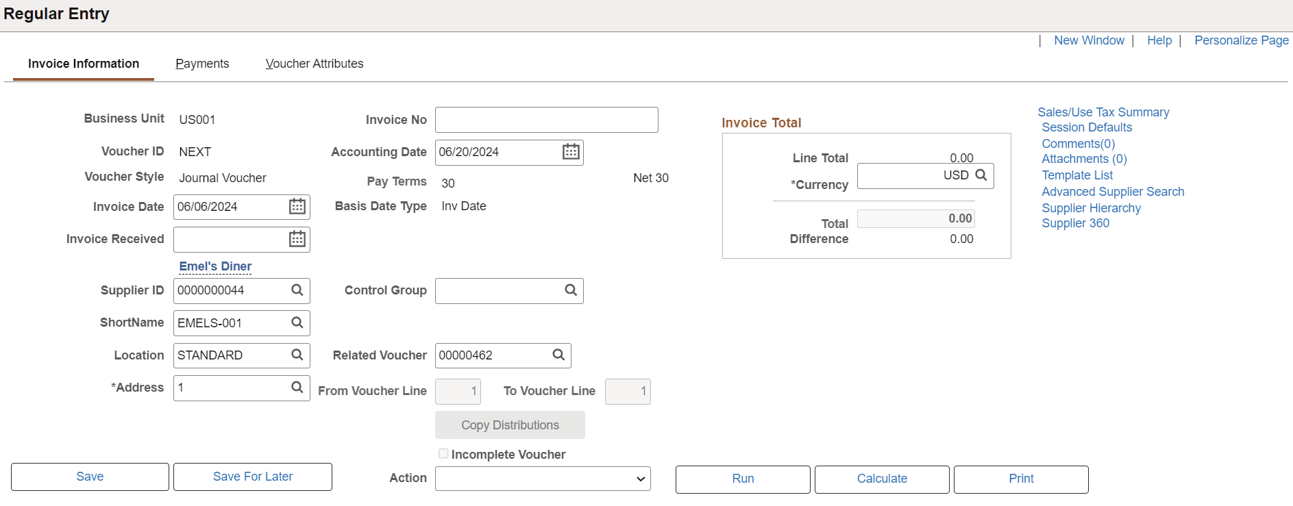

Invoice Information Page – Journal Voucher style
Use the Invoice Information page (Journal Voucher style) to adjust accounting entries for vouchers that have been posted and paid, and for vouchers for which payments have also been posted.

Accounts Payable, and then Vouchers, and then Add/Update, and then Regular Entry, and then Invoice Information
This example illustrates the fields and controls on the Invoice Information Page – Journal Voucher style (1 of 2).

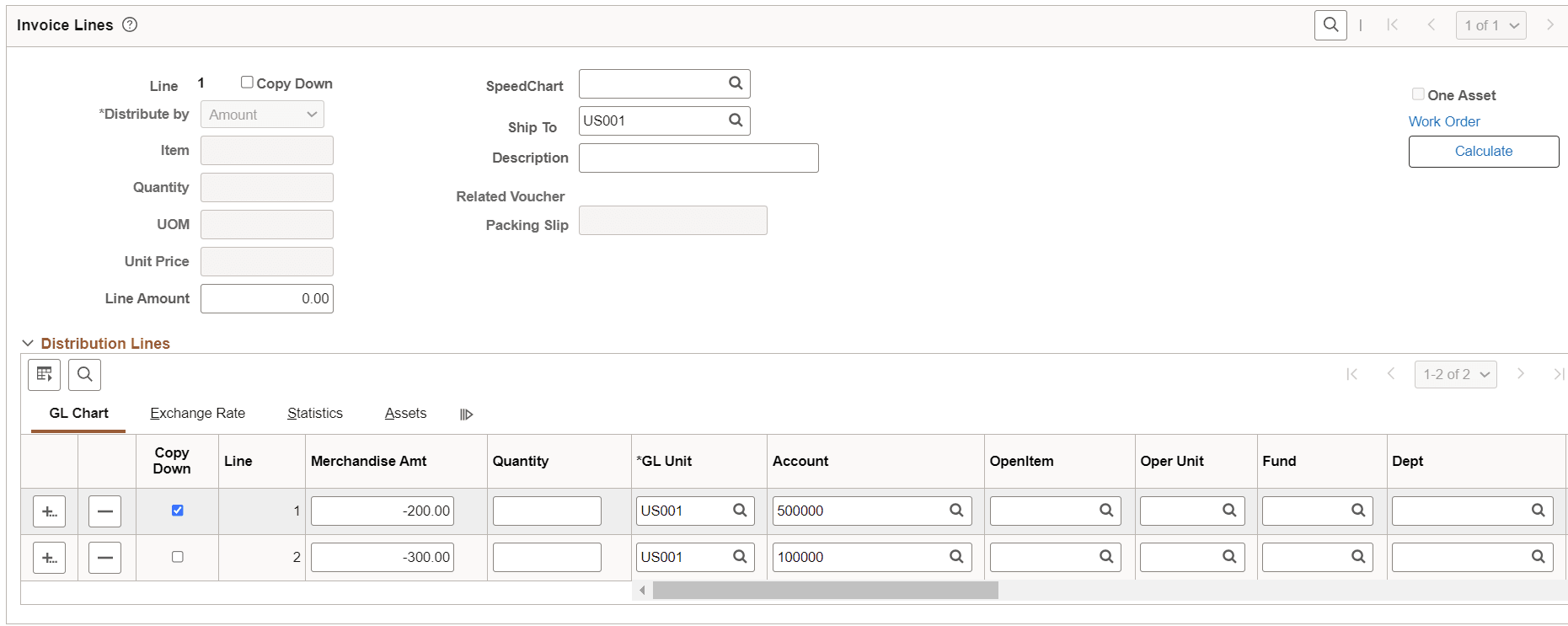

This example illustrates the fields and controls on the Invoice Information Page – Journal Voucher style (2 of 2).
Invoice Information Page Journal Voucher (2 of 2)

  1. Select Journal Voucher as the voucher style on the add search page for the Voucher component and click Add.
  2. Enter the Supplier Name and Supplier Location.
  3. Choose Related Voucher on the Journal Voucher header page. It will display From Voucher Line and To Voucher Line. Modify the values for specific voucher line or range of voucher lines or leave both the fields blank. Click Copy Distributions button to populate necessary header information, zero amount voucher lines with corresponding distributions of foreign amount and chart fields from the related voucher based on the options. Foreign amount is reversed, that is, Foreign Amount of Related Voucher * -1 for back out of Expense Distribution of related voucher. Copy Down check box is enabled for first distribution line of every zero voucher line. Once copying is complete, From Voucher Line, To Voucher Line, and Copy Distributions button is disabled.
  4. Add the new distribution line against the back out line. Enter the same amount with opposite sign of back amount and chart fields for correction.
    OR
    You can also utilize the Copy Down functionality of distribution to copy the distribution amount, GL Business Unit, Account, and Chart fields from back out line. The Distribution amount copied will be opposite sign of back out amount. The user can change Account or Chart fields.

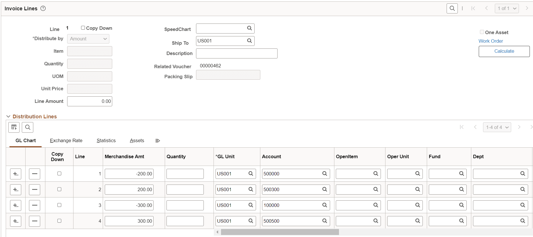

    This example illustrates the fields and controls on the Invoice Information page after adding correction distribution lines
    Invoice Info after adding correction distribution lines (2 of 2)
  5. Review the voucher for any other changes of header, line, and distributions. Remove the voucher lines and distributions which are not needed for corrections. Ensure that the distribution amounts are balanced for Zero amount voucher line. Click Save. It will perform the edits on the Supplier ID, Supplier Location, Accounting Date, Invoice Date, Transaction Currency, and Related Voucher fields of Journal Voucher page. An error message is displayed if edits are not cleared. From Voucher Line, To Voucher Line, Related Voucher, and Copy Distribution button will be disabled after save.
