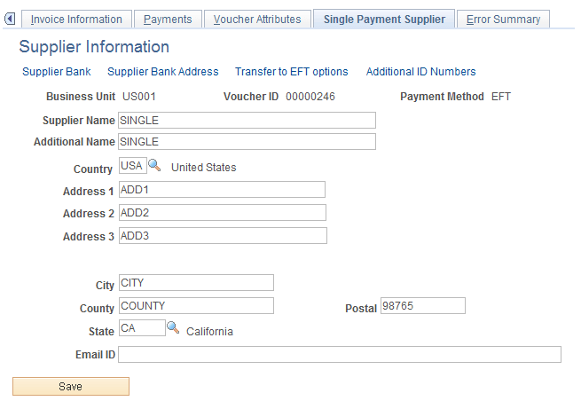

Voucher - Single Payment Supplier Page
Use the Voucher - Single Payment Supplier page (VCHR_VNDR_INFO) to create a voucher for a payment to a one-time supplier, such as a rebate or refund recipient, without having to create and store the supplier in the system.
Navigation:
Accounts Payable, and then Vouchers, and then Add/Update, and then Regular Entry
You must select a voucher style of Single Payment Voucher and enter a single payment supplier ID on the add search page.
This example illustrates the fields and controls on the Voucher - Single Payment Supplier page. You can find definitions for the fields and controls later on this page.
Field or Control Description
Supplier Bank
Click to access the Supplier Bank page, where you can enter the supplier's bank account information.
Supplier Bank Address
Click to access the Supplier Bank Address page, where you can enter the supplier's bank address information.
Transfer to EFT Options (transfer to electronic funds transfer options)
Click to access the Transfer to EFT Options page, where you can enter EFT and intermediary bank routing information. This link is available only if you have selected an EFT payment method on the Voucher - Payments page.
(USF) EFT payments to single payment suppliers are not available for U.S. Federal agencies.
Additional ID Numbers
Click to access the Additional ID Numbers page, where you can enter the standard ID qualifier and ID number. This link is available only if the payment is through Financial Gateway.
Single Payment Voucher data can be uploaded to staging records using the delivered ExcelToCI. When connecting the ExcelToCI to the database, utilize the delivered Component Interface AP_SGLP_CI to create the necessary staging record structure. Voucher Style must be SGLP and Voucher Source must be XML. Once the data has been staged and submitted successfully from the ExcelToCI, run Voucher Build with the source of XML Invoice to create single payment vouchers.
