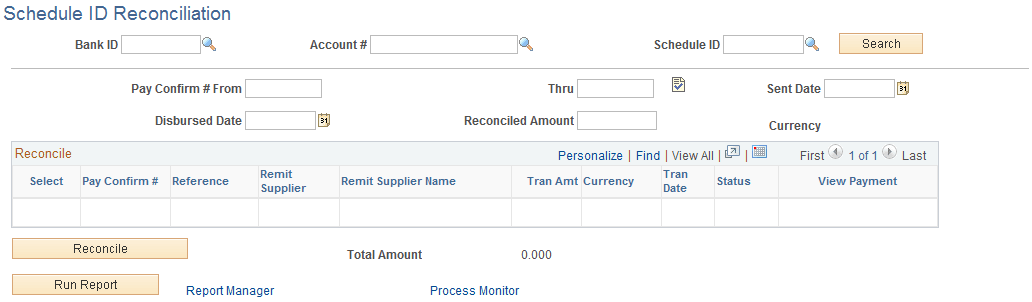

Schedule ID Reconciliation Page
Use the Schedule ID Reconciliation page (BNK_RCN_MAN_TRE) to reconcile a series of federal schedule ID payments.
Run the Account Register report (FSX4004). Use the report to view a list of reconciled or unreconciled Federal Schedule ID payments.
Navigation:
Banking, and then Reconcile Statements, and then Schedule ID Reconciliation
This example illustrates the fields and controls on the Schedule ID Reconciliation page. You can find definitions for the fields and controls later on this page.
Field or Control Description
Pay Confirm # From and Thru
Enter a range of payment confirmation numbers that are obtained from GOALS - RFCAL.
Assign Confirmation Number icon
Click the Assign Confirmation Number icon to assign a range of schedule ID treasury payment numbers to display unreconciled data.
Sent Date
Enter the date on which you sent the payment to the TDO.
Disbursed Date
Enter the date on which the TDO disbursed the schedule ID payments.
Reconciled Amount
Enter the sum of the payments' amounts that you have assigned in the Pay Confirm # From and Thru fields.
Reconcile
Click to reconcile the unreconciled data with the information you enter. This function also performs various audits and displays error messages as appropriate. If the reconciled amount differs from the sum of the payments' amounts (payments assigned a confirmation number), an error message displays.
When you click reconcile, the system:
  • Updates the Payables Bank Schedule ID table (AP_BANK_SCHED) with three dates: the payment date, the disbursement date, and the date on which the schedule was sent from Payables to PeopleSoft banks.
  • Updates the appropriate Federal payments in Payables with a U.S. Treasury Payment confirmation number.
  • Updates the IPAC Document Reference Number on an IPAC payment with the U.S. Treasury Payment confirmation number, if a bank account is configured for IPAC and uses a payment method of EFT.
