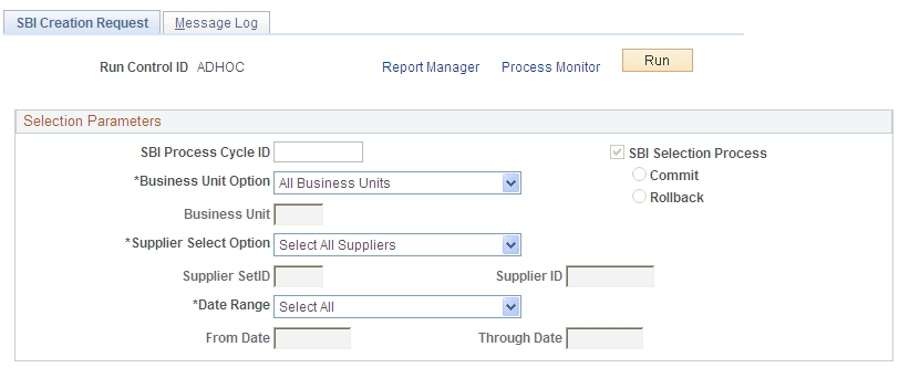

SBI Creation Request Page
Use the SBI Creation Request page (SBI_CREATE_REQUEST) to specify the SBI selection parameters.
Navigation:
Accounts Payable, and then Batch Processes, and then Vouchers, and then Self-billed Invoice Process, and then SBI Creation Request
This example illustrates the fields and controls on the SBI Creation Request page. You can find definitions for the fields and controls later on this page.
The ERS vouchers must be posted and matched before you can run the SBI process.
Field or Control Description
Run Control ID
When you add a new run control ID, the SBI process is set to run in Selection mode and all run mode-related fields are unavailable for entry. The SBI Selection Process check box is selected, but both this check box, and the Commit and Rollback check boxes are unavailable for entry until you have run the SBI process in Selection mode.
The mode in which the PeopleSoft Application Engine process runs is always controlled through PeopleCode.
Select to run the SBI process in Selection mode rather than Commit or Rollback mode. When you enter a new run control ID, the system automatically selects the Selection process for you, and you cannot change the field.
Commit
Select to run the SBI process in Commit mode rather than Selection or Rollback mode. You can only select this option after you have run the SBI process in Selection mode.
After you run the SBI process in Selection mode, the system automatically changes to the Commit mode for you.
Rollback
Select to run the SBI process in Rollback mode rather than Selection or Commit mode. You can only select this option after you have run the SBI process in Selection mode.
Date Range
Enter to restrict the vouchers selected for the SBI process using the invoice date. Values are:
Select All: Selects all the vouchers regardless of date range.
Specify: Enter a date range in the From Date and Through Date fields.
During the SBI Selection process, the system:
