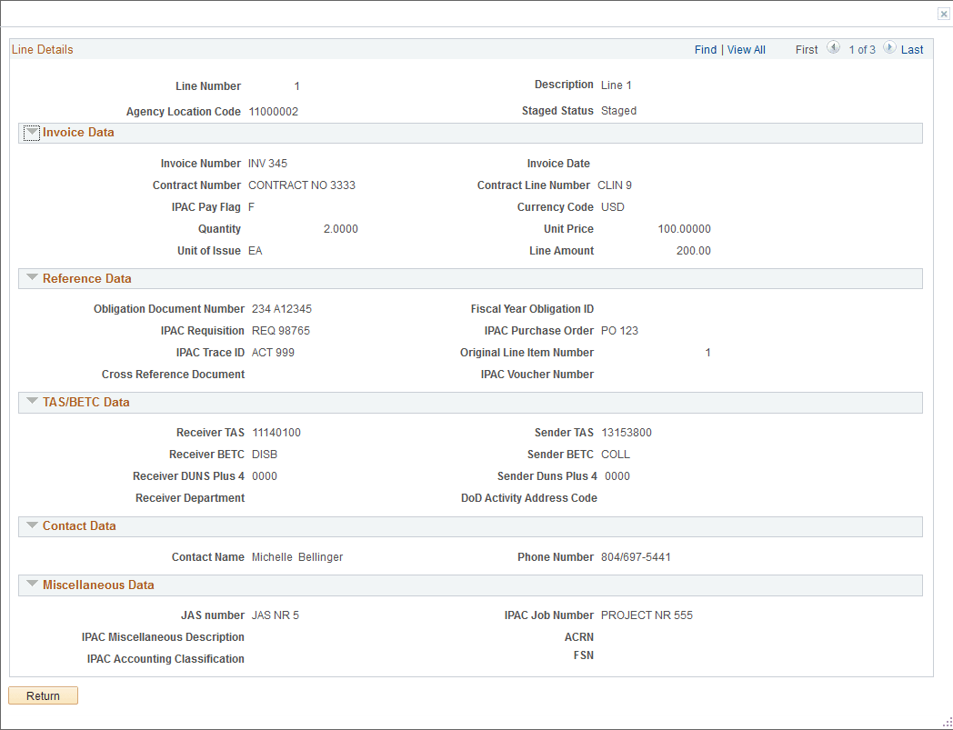

Line Details Page
AP_IPAC_WB_DTL
View fields from the IPAC detail staging table. This page is read-only.

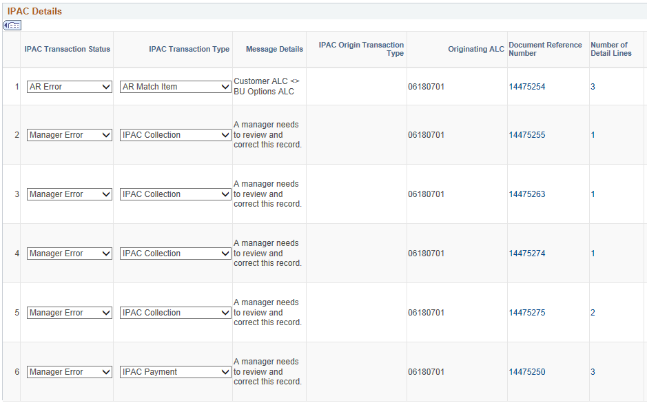

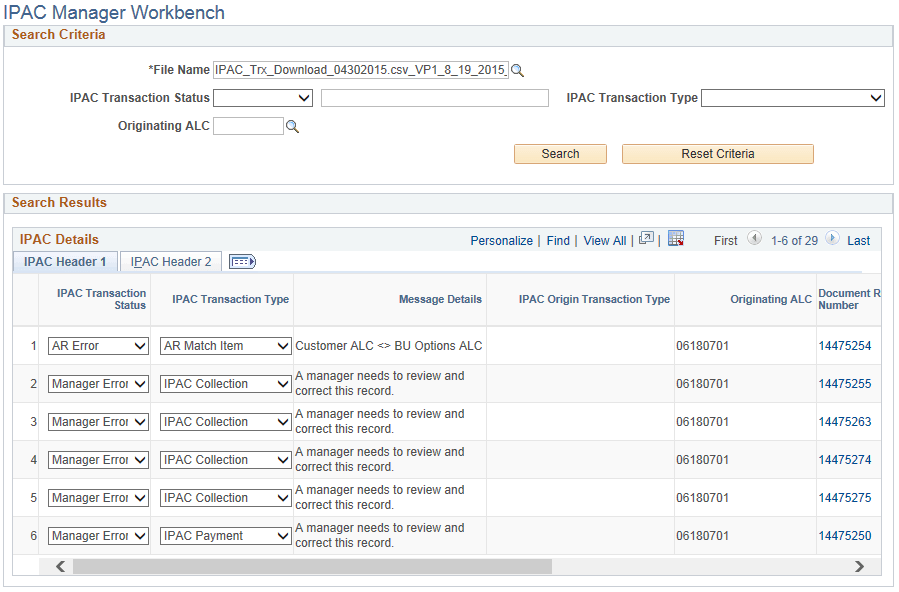

IPAC Manager Workbench Page
IPAC_MANAGER_WB
Review and classify transactions as either AP or AR.

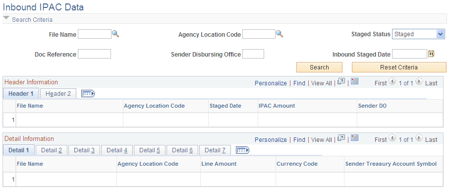

Inbound IPAC Data Page
AP_IPAC_INBND_INQ
View inbound IPAC data from files that have been uploaded to the inbound IPAC staging tables.

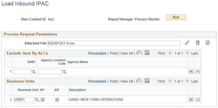

Load Inbound IPAC Page
Use the Load Inbound IPAC page (INTFC_IPAC_RQST) to request a run of the Load inbound IPAC File into the inbound IPAC staging tables for processing in PeopleSoft Payables.
Navigation:
Accounts Payable, and then Batch Processes, and then Extracts and Loads, and then Load Inbound IPAC
This example illustrates the fields and controls on the Load Inbound IPAC page. You can find definitions for the fields and controls later on this page.
Field or Control Description
Exclude Sent By ALCs grid
Enter a SetID and ALC that you want to exclude from the Load Inbound IPAC processing. Select the ALC from a list of all ALCs that belong to your company, the receiving agency running the Load Inbound IPAC process.
The process compares the ALCs in this grid to the originating ALC on the incoming IPAC record. If there is a match, the IPAC record is ignored. An IPAC record is not ignored when the agency manually enters IPAC transactions into IPAC and wants to use the PeopleSoft Inbound IPAC interface to record the transactions by leaving the Exclude Sent By ALCs fields blank.
Business Units grid
Enter a business unit and select a check box to indicate the business unit is an AP business unit, an AR business unit, or both. The prompt for the Business Unit field shows all AP and AR business units. These business units are used by the defaulting logic in the Load Inbound IPAC process to narrow down the search when querying AP for previously entered vouchers and AR for previously entered items. The AP and AR check boxes indicate the Business Unit is an AP business unit, an AR business unit, or both.

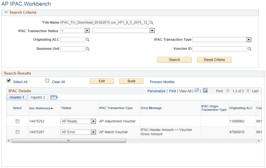

AP IPAC Workbench Page
Use the AP IPAC Workbench page (AP_IPAC_WORKBENCH) to view, correct, and process IPAC payment and adjustment transactions in Payables.
Navigation:
Accounts Payable, and then Review Accounts Payable Info, and then Interfaces, and then AP IPAC Workbench
This example illustrates the fields and controls on the AP IPAC Workbench page, including search results for the specified file and the IPAC Details grid. You can find definitions for the fields and controls later on this page.
AP IPAC Workbench page (1 of 3)
This example illustrates the fields and controls on the AP IPAC Workbench page, showing the IPAC Details grid (continued). You can find definitions for the fields and controls later on this page.
AP IPAC Workbench page (2 of 3)
AP IPAC Workbench page (3 of 3)
Understanding IPAC Transaction Statuses
The IPAC transaction status indicates the record status during IPAC processing. You can retrieve transactions by status by searching on the IPAC Workbench. These transaction statuses appear on the AP IPAC Workbench:
  • AP Do Not Process - Indicates that the Load IPAC program found a previously matched voucher for this IPAC record.
  • AP Error - Indicates that the voucher ID was able to be matched but failed edits. You can correct the error in the system and use the Edit button on the workbench to re-run the edits and verify the issue is resolved.
    You can change this status to AP Ready or Manager Error.
  • AP in Process - Indicates that a record is being processed by AP. No actions can be performed against this record; the record is now display-only.
  • AP Processed - Indicates that a record has already been processed by AP. No more actions can be performed against this record; it is now display-only.
  • AP Ready - Indicates that the Load IPAC program matched a voucher ID to this record. You can review this record before further processing. You can also change this status to Manager Error to indicate that a manager should review and correct this record on the IPAC Manager Workbench.
    For selected transactions with the AP Ready status, you can click the Build button. The Build button initiates the IPAC Voucher Build Application Engine program (AP_VB_IPAC) to create AP transactions from the IPAC records. The transaction status first changes to AP in Process, then once the program has completed successfully, the status changes to AP Processed.
  • AP Review - Indicates that a manager has classified the record as AP. You need to review the record and make necessary changes before it can be fully processed.
When the Manager Error status appears, the system was unable to determine whether this IPAC transaction is AP or AR, and this record must be reviewed by a manager on the IPAC Manager Workbench. You can also change the statuses AP Review and AP Ready to Manager Error for manager review.
Header Search Fields
File Name
(Required) Enter the IPAC file name.
Select the staging line status. You can search the status field by these operators: contains and = (equals).
Valid values are:
  • AP Do Not Process
  • AP Error
  • AP in Process
  • AP Processed
  • AP Ready
  • AP Review
Originating ALC
Enter the originating ALC.
Business Unit
Enter the AP business unit. This field allows you to search for IPAC records that have already been matched.
IPAC Transaction Type
Select the IPAC transaction type. Valid values are:
  • AP Match Voucher
  • AP Adjustment Voucher
  • AP Outbound Vchr Mtch
  • AP Outbound Adjustment
Voucher ID
Enter a voucher ID. This search field is available when searching by AP business unit.
Search
Click the Search button to retrieve IPAC transactions in the staging tables using the search criteria specified.
Reset Criteria
Clears the entered search criteria from the search fields.
Search Results
Edit
Click this button to verify the selected transactions in the grid.
The program checks the following:
  • Customer ALC for the IPAC record must match the ALC set up for the bank on the referenced AP voucher.
  • IPAC Header Amount must equal the Voucher Gross Amount on the referenced AP voucher for transactions with the transaction type of AP Match Voucher.
  • Purchase order ID must equal the Purchase Order Number from the IPAC record.
  • If the voucher style is adjustments and there are existing IPAC records in the AP IPAC Header table, then this is a duplicate or a sent transaction.
Build
Click this button to run the Voucher Build process for the selected transactions in the grid. The process creates AP transactions from the IPAC records with a status of AP Ready.

Number of Detail Lines
Click this link to open the IPAC Line Details page (AP_IPAC_WC_DTL). The link shows the number of lines in the voucher.

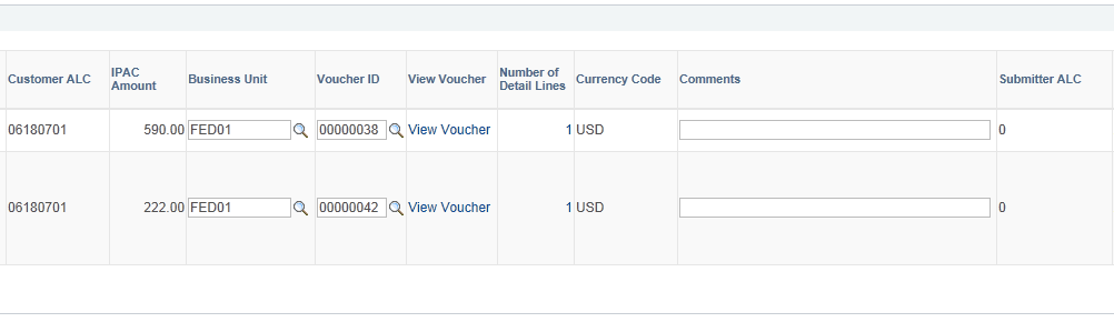

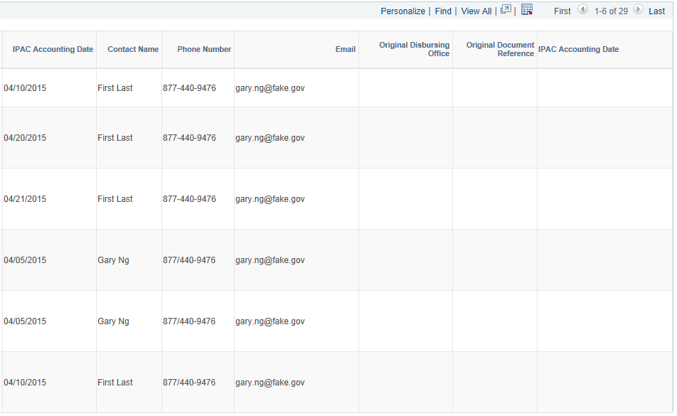

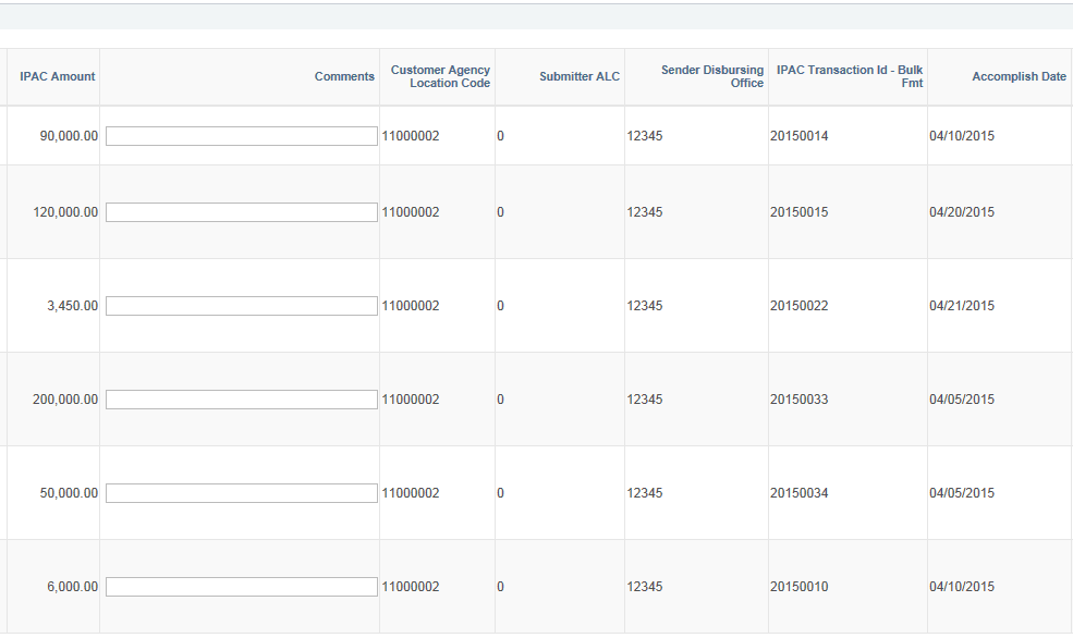

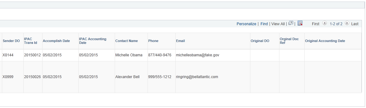

IPAC Details Grid – Header 2 Tab
Customer ALC
Displays the customer ALC.
Submitter ALC
Displays the submitting agency from the IPAC file. This field is optional.
Sender DO
Displays the sender’s disbursing office symbol that is associated with the Customer ALC from the IPAC file.
IPAC Trans ID
Displays the IPAC transaction ID.
Accomplish Date
Displays the date that an IPAC transaction was successfully processed by the IPAC System.
IPAC Accounting Date
Displays the IPAC accounting date.
Contact Name, Phone, and Email
Displays the contact information from the IPAC file.
Original DO
Displays the original disbursing office when the IPAC transaction is an adjustment.
Original Doc Ref
Displays the original document reference number from the IPAC file when the IPAC transaction is an adjustment.
Original Accounting Date
Displays the accounting date from the original IPAC transaction when the IPAC transaction is an adjustment.
Line Details Page
Use the Line Details page (AP_IPAC_WB_DTL) to view fields from the IPAC detail staging table. This page is read-only.
Navigation:
Click the link in the Number of Detail Lines column on the IPAC Workbench page.
This example illustrates the fields and controls on the IPAC Line Details page.
Use the IPAC Manager Workbench page (IPAC_MANAGER_WB) to review and classify transactions as either AP or AR.
Navigation:
Accounts Payable, and then Review Accounts Payable Info, and then Interfaces, and then IPAC Manager Workbench
This example illustrates the fields and controls on the IPAC Manager Workbench page, showing the search results for the specified file. You can find definitions for the fields and controls under the AP IPAC Workbench page.
Search Results on the IPAC Manager Workbench page
This example illustrates the fields and controls on the IPAC Manager Workbench page – IPAC Details (1 of 3). You can find definitions for the fields and controls under the AP IPAC Workbench page.
This example illustrates the fields and controls on the IPAC Manager Workbench page – IPAC Details (2 of 3). You can find definitions for the fields and controls under the AP IPAC Workbench page.
This example illustrates the fields and controls on the IPAC Manager Workbench page – IPAC Details (3 of 3). You can find definitions for the fields and controls under the AP IPAC Workbench page.
All transaction statuses for both Payables and Receivables are visible on the IPAC Manager Workbench. If the matching process is not able to determine whether the transaction is AP or AR, the status is set to Manager Error. The manager uses the IPAC Manager Workbench to review the record. The manager performs research to determine that the record should be assigned to AP or AR, updates the status to AP Review, and sets the transaction type to the appropriate type. The manager can also enter a note in the Comments field.
Document Reference Number
Click the document reference link to transfer to the Receivables IPAC Workbench or the AP IPAC Workbench based on the transaction status.
The rest of the fields on the IPAC Manager Workbench are the same as those on the AP IPAC Workbench. For field definitions, see the AP IPAC Workbench Page.
Use the Inbound IPAC Data page (AP_IPAC_INBND_INQ) to view inbound IPAC data from files that have been loaded to the inbound IPAC staging tables.
Navigation:
Accounts Payable, and then Review Accounts Payable Info, and then Interfaces, and then Inbound IPAC, and then Inbound IPAC Data
This example illustrates the fields and controls on the Inbound IPAC Data page. You can find definitions for the fields and controls later on this page.
On this page, the sending agency is the supplier's agency, which is receiving the payment, and the receiving agency is the customer's agency—that is, your agency—which is making the payment.
Search Criteria
File Name
Enter the file name. Displays the concatenation of the file name + User ID of the user who loaded the file + date/time that the file was loaded.
Agency Location Code
Enter the ALC of the sending agency, which is the agency receiving the payment.
Inbound Staged Date
Enter the date the inbound IPAC file was loaded into the inbound IPAC staging tables using the Load Inbound IPAC process.
Staged Status
Select from:
  • Error
  • Selected
  • Staged
Doc Reference (document reference)
Enter the payment confirmation number.
Header Information
Displays the sender's ALC.
IPAC Amount
Displays the total amount of the IPAC payment.
Sender DO (Sender Disbursement Office)
Displays the sender's disbursement office code.
Tran Set ID (transaction SetID)
Displays the transaction SetID. PeopleSoft Payables only processes inbound IPAC transactions whose transaction SetID is 810, collection.
Customer ALC
Displays your ALC.
Detail Information
Each row in the Detail Information grid represents one voucher line-distribution line combination.
Line Amount
Displays the amount for the voucher line-distribution line combination.
Sender Treasury Account Symbol
Represents the fund and appropriation to which the payment was made.
Contact Name
Displays a sender contact name.
IPAC Accounting Classification
Displays the accounting classification code that identifies a project. It was supplied by you, the customer, to the supplier when the goods or services were originally requested. This is identical to the ACL/CD (Accounting Classification Code) field on the IPAC Miscellaneous Description page (see Processing Outbound IPAC Transactions).
Receiver Department
Displays the two-digit code assigned by the Department of Treasury to the agency receiving the transaction (for inbound IPAC, your agency).
Description
Displays a description of the invoice line item.
Cross Reference Document
Displays the document reference number of the original IPAC payment for zero-dollar transactions.
Obligation Document Number
Displays the PO ID.
IPAC Pay Flag
Indicates whether a payment is F, final or P, partial.
IPAC Purchase Order
Displays the PO ID.
IPAC Quantity
Displays the item quantity.
Receiver Treasury Account Symb (receiver Treasury Account Symbol)
Represents the fund and appropriation upon which the payment is drawn.
