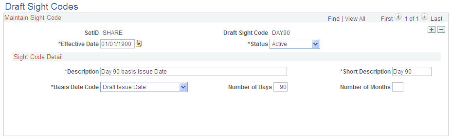

Draft Sight Codes Page
Use the Draft Sight Codes page (APD_SIGHT_CODE_PNL) to create, modify, or view available draft sight codes.
Navigation:
Set Up Financials/Supply Chain, and then Product Related, and then Procurement Options, and then Payments, and then Payments Sight Codes, and then Draft Sight Codes
This example illustrates the fields and controls on the Draft Sight Codes page. You can find definitions for the fields and controls later on this page.
Field or Control Description
SetID
Displays the bank SetID for the supplier's bank account.
Draft Sight Code
Displays a user-defined value that represents the draft payment terms to which you and your supplier agree.
Effective Date
Specify the beginning date that the sight code is in effect.
Status
Specify whether the status of the sight code is active or inactive.
Sight Code Detail
Basis Date Code
Specifies the scheduled due date for the draft. It is used to calculate the draft maturity date:
Invoice DT (invoice date): Uses the invoice date on the voucher as the basis date.
Issue Date: Uses the scheduled due date as a basis date.
Number of Days
Enter the number of days from the basis date on which the draft matures.
Number of Months
Enter the number of months from the basis date on which the draft matures.

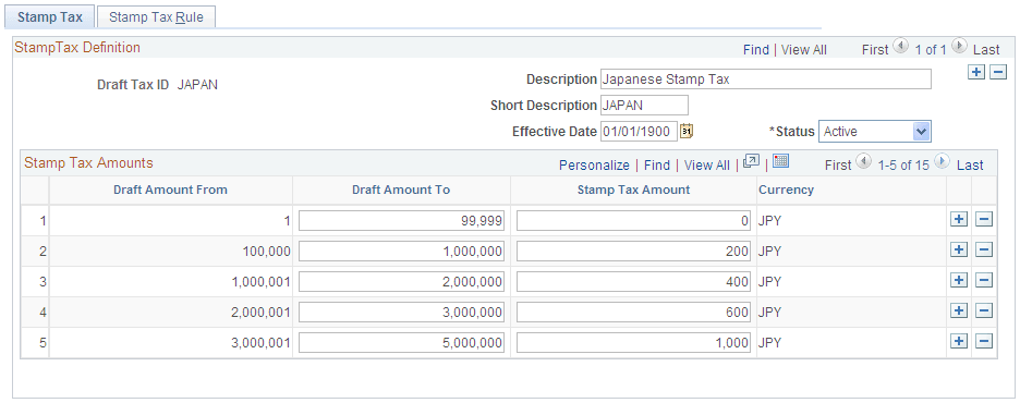

Stamp Tax Page
Use the Stamp Tax page (APD_STAMP_TAX_PNL) to view default settings for draft optimization, including a description for the tax table, the stamp tax amount range, the stamp tax minimization amount for each range and stamp tax currency, the draft amount range, the applicable currency, and the maximum value of the draft before it is split.
Navigation:
Set Up Financials/Supply Chain, and then Product Related, and then Procurement Options, and then Management, and then Stamp Tax
This example illustrates the fields and controls on the Stamp Tax page. You can find definitions for the fields and controls later on this page.
Stamp Tax page
Draft Amount From
Displays the beginning of the draft amount range. When you define the stamp tax amounts, the system calculates the value in this field based on the value that you enter in the Draft Amount To field, plus one. The first line displays the draft amount from 1.
Stamp Tax Amount
Enter the amount of the stamp tax that the system applies to drafts in the desired draft amount from and draft amount to range.

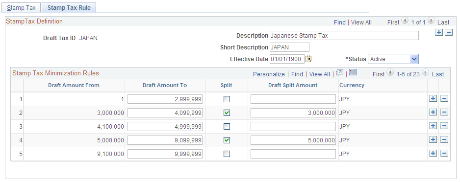

Stamp Tax Rule Page
Use the Stamp Tax Rule page (APD_STAMP_TAXR_PNL) to create, modify, or view the stamp tax minimization rules.
Navigation:
Set Up Financials/Supply Chain, and then Product Related, and then Procurement Options, and then Management, and then Stamp Tax, and then Stamp Tax Rule
This example illustrates the fields and controls on the Stamp Tax Rule page. You can find definitions for the fields and controls later on this page.
Stamp Tax Rule page
Stamp Tax Minimization Rules
During the Draft Staging Application Engine process (AP_DFT_PROC), the values in the Stamp Tax table determine where the draft payment is split.
Split
Selecting this check box activates the Draft Split Amount field, where you enter the maximum value that the draft in the selected draft amount range should reach before it is split.
