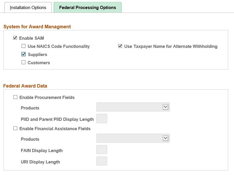

Federal Processing Options Page
Use the Federal Processing Options page (INSTALLATION_FD) to enable SAM processing for suppliers or customers.
Navigation:
Set Up Financials/Supply Chain, and then Install, and then Installation Options, and then Federal Processing
This example illustrates the fields and controls on the Federal Processing Options page. You can find definitions for the fields and controls later on this page.
Field or Control Description
Enable SAM
Select to enable SAM processing for the implementation.
Use NAICS Code Functionality (North American Industry Classification System)
Select to indicate that your PeopleSoft Payables implementation already has updated NAICS codes, and that the system should use these updated codes for SAM processing on the Standard Industry Codes table (Set Up Financials/Supply Chain, Common Definitions, Customers, Standard Industry Codes).
Suppliers
Select to allow users to create suppliers from SAM data.
Note: If unselected, the Use Taxpayer Name for Withholding field appears as display-only.
Customers
Select to allow users to create customers from SAM data.
Select to enable the PeopleSoft system to compare the name entered in the SAM Taxpayer Name field with the name entered in the PeopleSoft Supplier information.
If a value is entered in the SAM Taxpayer Name field and is different from the value entered in the Supplier Name field on the PeopleSoft Source to Settle Common Information: Identifying Information Page then the Load SAM process updates the Withholding Alternate name field on the PeopleSoft Source to Settle Common Information: Supplier Information - Address Page for all addresses, after truncating the number of characters to forty (40).
A message is displayed when the Withholding Alternate Name is updated and when the SAM Taxpayer Name is truncated if the update was performed during the on-line creation of a supplier.
The Summary Messages section of the Inquire SAM File Information Page is updated with the changes mentioned above if the update was performed in the Load process.

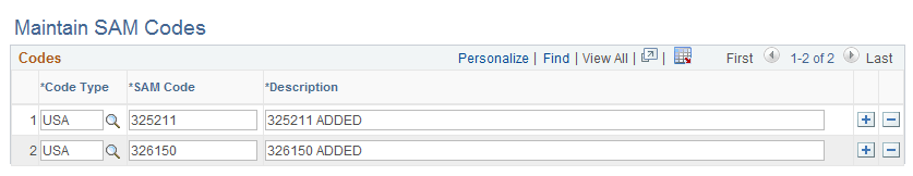

Maintain SAM Codes Page
Use the Maintain SAM Codes (MAINTAIN_USF_CODES) page to maintain government mandated code types with the corresponding SAM code and description for your installation, which is used instead of using pre-defined NAICS codes on the Standard Industry Codes table.
Navigation:
Supplier, and then System for Award Management , and then Maintain SAM Codes .
Customers, and then Customer Information , and then System for Award Management , and then Maintain SAM Codes .
This example illustrates the fields and controls on the Maintain SAM Codes page. You can find definitions for the fields and controls later on this page.
Code Type
Select a code type from the following, and enter the corresponding SAM code and description:
  • BUS: Business Types
  • PSC: Public Service Codes
  • SBA: SBA Business Types
  • USA: NAICS Code
  • USE: NAICS Exception Codes
  • USP: Primary NAICS Codes
