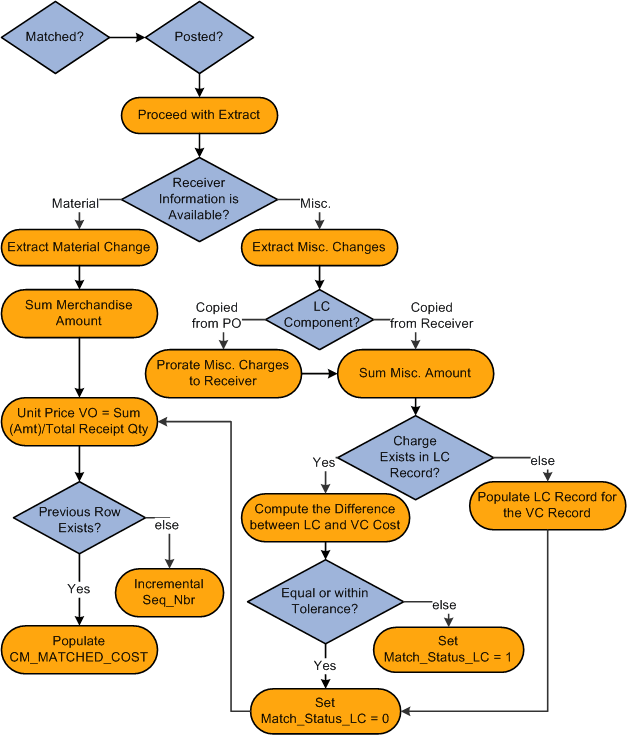

This diagram illustrates how the Landed Cost Extraction process works.
