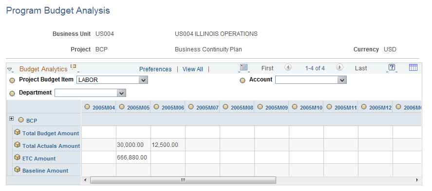

Program Budget Analysis Page
Use the Program Budget Analysis page (PGM_BUD_ANALYSIS) to analyze program cost budget versus actual amounts, estimate to complete, and the baseline budget.
Navigation:
  • Program Management, and then Program Budgeting, and then Program Budget Analysis, and then Program Budget Analysis
  • Program Management, and then Program Tools, and then Review Program, and then Review Program. Click the Program Budget Analysis link.
This example illustrates the fields and controls on the Program Budget Analysis page. You can find definitions for the fields and controls later on this page.
Selection Criteria
Select values for the fields on the slicer bar to filter the information that appears on the analysis page.
Field or Control Description
Department
Select a value to limit the report to a specific department.
Project Budget Item
Select a value to limit the report to a specific budget item.
Account
Select a value to limit the report to a specific account.
Data Grid
The analysis grid displays data for the program and each child program or project that is associated with the program. The budget periods are based on the program budget calendar.
Total Budget Amount
Displays the budget amounts for the active program budget. If the selected program does not have an active budget, the child projects and programs under the selected program appear individually. The total budget values for the child projects and programs are also rolled up to display a program total.
Total Actuals Amount
Displays the actuals amounts from the projects that comprise the program. The individual project amounts are rolled up to display a program total amount. The accounting date on the project transactions is used to determine the budget period in which the amount is displayed. The Actual Cost analysis group defined at the project level is used to determine the transactions used to derive this total.
ETC Amount (estimate to complete amount)
Displays the estimate to complete amounts for the projects that comprise the program. The individual project amounts are rolled up to display a program total amount. The accounting date on the estimate to complete transactions is used to determine the budget period in which the amount is displayed. The system uses the Cost Estimate to Complete analysis group defined on the Installation Options - Project Costing Integration page to determine the transactions to use to derive this total.
Baseline Amount
Displays the baseline budget for the program if one is defined.

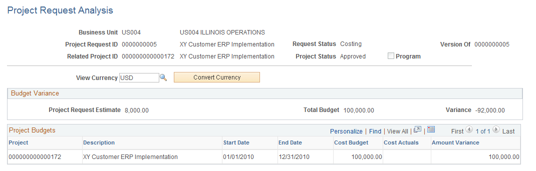

Project Request Analysis Page
Use the Project Request Analysis page (PGM_PRJRQ_ANALYSIS) to compare the project request estimate to the associated program or project budget.
Navigation:
Program Management, and then Program Budgeting, and then Project Request Analysis, and then Project Request Analysis
This example illustrates the fields and controls on the Project Request Analysis page. You can find definitions for the fields and controls later on this page.
Project Request ID
Displays the project request ID of the project whose business case estimate is compared to the program or project budget.
Request Status
Displays the current status of the project request.
Version Of
Displays the version of the project request.
Related Project ID
Displays the project identifier for the corresponding project request.
Program
Indicates whether the project is a program. If the box is selected, the project is a program.
View Currency
Enter the currency in which to view the budget variance, cost budget, and cost actuals. You must click the Convert Currency button to change the amounts. The default value is the project business unit currency.
Convert Currency
Click to restate all of the budget amounts in the currency that you specified in the View Currency field.
Budget Variance
Project Request Estimate
Displays the total estimated cost from the Project Request page
Total Budget
Displays the total active program or project budget. If a program has an active budget and the child projects under it have active budgets, then the program budget is the total budget. If the program does not have an active budget, and the child projects under it have active budgets, then the total budget is the roll up of the active child project budgets under the program.
Variance
Displays the difference between the project request estimate and total budget.
Program Budgets
Project Name
Displays the child program or project descriptions.
Cost Budget
Displays the active program or project budget.
Cost Actuals
Displays the actual costs for the projects under the program.
Amount Variance
Displays the difference between the cost budget and cost actuals amounts.
