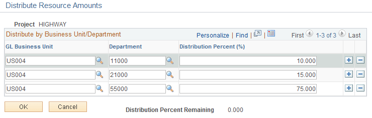

Distribute Activity Resource Amounts Page
Use the Distribute Activity Resource Amounts page (PGM_COST_PCT) to enter general ledger business units, department IDs, and distribution percents for the system to use to distribute resource amounts to budget detail rows.

Click the Get Plan button on the Budget Plan page when the Allow Get Plan Distribution by Department option on the Installation Options - Project Costing is enabled.
This example illustrates the fields and controls on the Distribute Activity Resource Amounts page. You can find definitions for the fields and controls later on this page.
Field or Control Description
GL Business Unit (general ledger business unit)
Enter the general ledger business unit to be used on budget detail lines for this project.
Department
Enter the department ID to be used on budget detail lines for this project.
Distribution Percent (%)
Enter the percentage for each general ledger business unit and department combination. The sum of the distribution percents must equal 100 percent.
This page does not appear if the project is associated with a project request or if the Allow Get Plan Distribution by Department check box is not selected on the Installation Options - Project Costing page.
