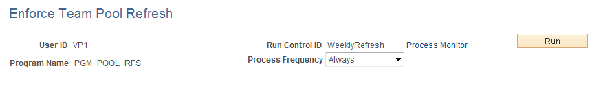

Enforce Team Pool Refresh Page
Use the Enforce Team Pool Refresh page (RUN_PGM_POOL_RFSH) to run the Refresh Resource Pools Application Engine process.

This example illustrates the fields and controls on the Enforce Team Pool Refresh page. You can find definitions for the fields and controls later on this page.
Select the process frequency and click Run to send this process to the Process Scheduler.
