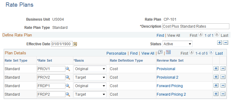

Rate Plans Page
PC_RATE_PLAN
Combine rate sets so that the target rows from one rate set are used to create additional target rows from the next rate set.
Enter New Rate Plan Keys Page
PC_RATE_PLAN_SUB
Copy a rate plan to create a new rate plan in the same business unit.
To access this page, click Copy from Rate Plan on the Rate Plans page.

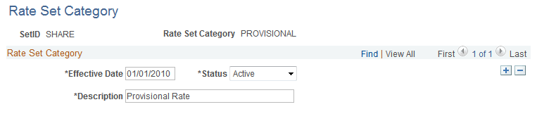

Rate Set Category Page
Use the Rate Set Category page (PC_RATE_CATEGORY) to define categories that are used to group rate sets.
The rate set category can be selected on the Variance Pricing run control page.
Navigation:
Setup Financials/Supply Chain, and then Product Related, and then Project Costing, and then Pricing Structure, and then Setup PC Pricing Rate Set Cat
This example illustrates the fields and controls on the Rate Set Category page. You can find definitions for the fields and controls later on this page.
The rate set category is used on the Variance Pricing run control page, where it can be selected in the Rate Processing Option field. If Rate Set Category is selected in the Rate Processing Option field, then all rate sets that are associated with the rate set category selected in the Rate Category field are selected when the Variance Pricing processes runs.

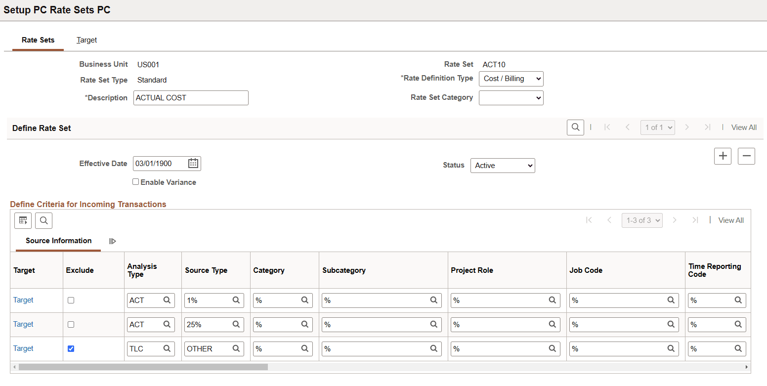

Rate Sets Page
Use the Rate Sets page (PC_RATE_DTL) to define source criteria that identifies cost transactions from which you want to create target rows.
Navigation:
  • Setup Financials/Supply Chain, and then Product Related, and then Project Costing, and then Pricing Structure, and then Setup PC Rate Sets PC
  • Customer Contracts, and then Contracts Center, and then Definitions, and then Rate Sets, and then Rate Sets
This example illustrates the fields and controls on the Rate Sets page.
Rate Sets page
As an alternative to using this method of defining rate sets, you can use the PeopleSoft Data Migration Workbench and Application Data Sets (ADS) to move rate set data. For additional information see Application Fundamentals: Understanding the PeopleSoft Data Migration Workbench.
Field or Control Description
Rate Set
Enter a rate set identifier. Rate set identifiers are used to run the Variance Pricing Application Engine process (PC_VAR_PRICE) and as selection criteria when setting up a rate plan. This field is required.
Copy from Rate Set
Click to access the Enter New Rate Set Keys page to enter the business unit and rate set ID of an existing rate set that you want to copy. Click OK on the Enter New Rate Set Keys page to return to the Rate Sets page with fields populated with data from the existing rate set.
The Copy from Rate Set button appears only in add mode.

Defining Criteria for Incoming Transactions
To set up a rate set, you define criteria that the system uses to identify the source transactions from feeder systems that are priced using this rate set. Populate the additional fields to identify specific transactions that you want the system to select and price using this rate set.
The transactions matching source criteria marked as "Exclude" will not be priced and are not eligible for pricing by any other criteria within the rate set.
If you selected the Enable Variance option on the Rate Sets page, the source rows in the Define Criteria for Incoming Transactions grid must contain at least one different value for analysis type, source type, category, or subcategory than the target rows in the Define Target Rows grid. If this condition does not exist, when you click the History link on the Rate Sets - Target page to access the Rate Variance History page, a message will appear stating that the rate set definition is not eligible for variance pricing.
Target
Click the Target link on a source row to define the target criteria that the Pricing process uses to create priced transaction rows.
Exclude
Select a source row to exclude from billing and revenue recognition. To mark as Exclude, a source row must not have a target defined.
Analysis Type

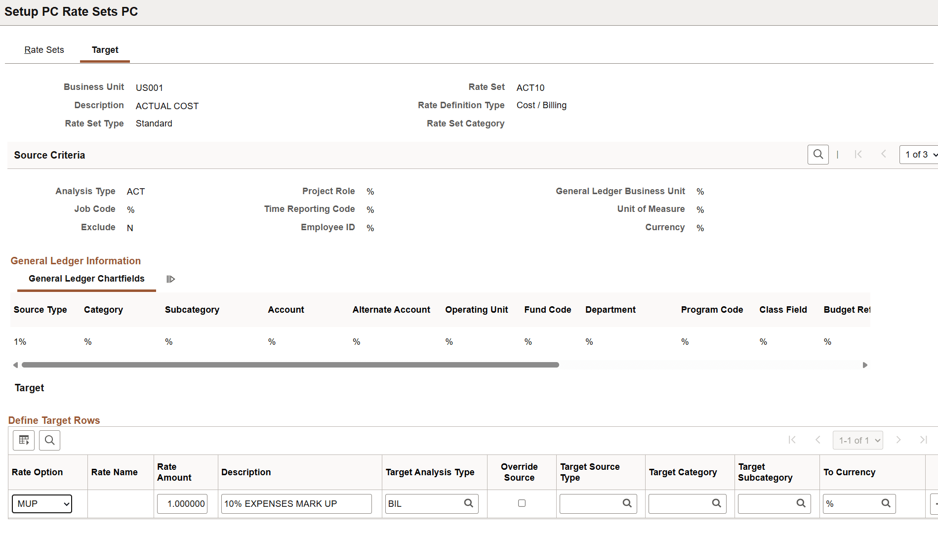

Rate Sets - Target Page
Use the Rate Sets - Target page (PC_RATE_DTL_LN) to define rate set target criteria to create cost, billing, or revenue rows.
Navigation:
  • Setup Financials/Supply Chain, and then Product Related, and then Project Costing, and then Pricing Structure, and then Setup PC Pricing Rate Set Cat, and then Target
  • Click the Target link on a row in the Define Criteria for Incoming Transactions grid on the Rate Sets page.
This example illustrates the fields and controls on the Rate Sets - Target page.
The ChartField values that you define for the source row on the Rate Sets page appears on the Rate Sets - Target page for reference.
You can associate each source row with multiple target rows.
The target definition is disabled for the source rows marked as Exclude and identified as Y on the Exclude field. If a target definition is defined for a source row and then the Exclude checkbox is selected, you need to either delete the target defintion or uncheck the Exclude checkbox to save the rate set.

    Source row transaction quantity × Employee-specific bill rate × Target row rate amount
  • ECO: Employee Cost Rate (as defined on the Rates by Employee page) sets the target amount equal to:
    Source row transaction quantity × Employee-specific cost rate × Target row rate amount
  • FIX: Fixed Amount sets the target amount equal to the rate amount defined on the rate set.
  • JBI: Job Code Bill Rate (defined on the Rates by Job Code page) sets the target amount equal to:
    Source row transaction quantity × Job code bill rate × Target row rate amount
  • JCO: Job Code Cost Rate (defined on the Rates by Job Code page) sets the target amount equal to:
    Source row transaction quantity × Job code cost rate × Target row rate amount
  • MUP: Markup Rate marks up the transaction amount by the value in the Rate Amount field.
  • NON: Carries the source amount from the source transaction directly to the target row.
  • RBI: Role Bill Rate (defined on the Rates by Role page) sets the target amount equal to:
    Source row transaction quantity × Role bill rate × Target row rate amount
    For target rows with a rate option of RBI, the role bill rate is based on the role fulfilled by the employee on the activity team. If no role exists for the employee on the activity team, the process uses the employee's role on the assignment schedule if PeopleSoft Program Management is installed. Finally, if no role exists for the employee on the assignment schedule, the process uses the employee's role on the project team.
  • RCO: Role Cost Rate (as defined on the Rates by Role page) sets the target amount equal to:
    Source row transaction quantity × Role cost rate × Target row rate amount
    For target rows with a rate option of RCO, the project role cost rate is based on the role fulfilled by the employee on the activity team, assignment schedule (if PeopleSoft Program Management is installed), or project team, in that order.
  • TBI: Tools Bill Rate (as defined on the PeopleSoft Maintenance Management Technician Workbench - Tools Usage page: Cost Information tab), which sets the target amount equal to:
    Source row transaction quantity × Tools bill rate × Target row rate amount
    This option is available if you use PeopleSoft Maintenance Management.
  • TCO: Tools Cost Rate (as defined on the PeopleSoft Maintenance Management Technician Workbench - Tools Usage page: Cost Information tab), which sets the target amount equal to:
    Source row transaction quantity × Tools cost rate × Target row rate amount
  • WBI: Work Order Labor Bill Rate
    To collect work order labor costs for billing, you can create a rate set that uses this rate option for the analysis type that you specify in the Mobile Time / Expense field on the Installation Options - Project Costing Integration page. This option is available if you use PeopleSoft Maintenance Management.
  • WCO: Work Order Labor Cost Rate
    To collect work order labor costs for costing, you can create a rate set that uses this rate option for the analysis type that you specify in the Mobile Time / Expense field on the Installation Options - Project Costing Integration page. This option is available if you use PeopleSoft Maintenance Management.
Rate Name
Select a value when CRC or CRB is selected in the Rate Option field. The custom cost rate and custom bill rate is defined on the Populate Custom Rates page.
This field is available only when the rate option is CRC or CRB.
Rate Amount
Enter a multiplier that the system uses in conjunction with the rate option to calculate target rows. For example, if you select a rate option of EBI and enter a rate amount of 1.1, the system multiplies the source row transaction quantity × the employee's bill rate × 1.1 to arrive at the target row amount.
For variance pricing, you cannot enter rate changes directly in this field. Instead, you must use the Rate Variance History page.
Description
Enter a description that appears on target rows and is passed to PeopleSoft Billing for use on the invoice. Leave the field blank or enter a wildcard (the percent symbol) for the description on the source transaction to appear by default on the target transaction.
Target Analysis Type
Select an analysis type for the system to assign to target rows. Leave the field blank for the analysis type from the source transaction to appear by default on the target rows.
The target analysis types that are available for selection are based on the value in the Rate Definition Type field on the Rate Sets page.
Note: If the rate definition type is Billing, you may select an analysis type included in the analysis group default for billing on the Integration Options page for Project Costing. If the rate definition type is Cost, you may select an analysis type included in the analysis group default for Actual Cost. If the rate definition type is Cost/Billing, you may select from analysis groups for Actual Cost and Billing. If the rate definition type is Revenue, you may select from analysis types in the PSRV2 analysis group.
Override Source
Select to override the source type, category, or subcategory from the source transaction that appears by default on the target transaction. If you select this option, enter a Target Source Type, Target Category, or Target Subcategory value to use on the target rows.
To Currency
Specify the currency that the system uses to calculate the target rows. This field does not apply to government contracts, as billing and revenue recognition must take place in the contract currency.
This field is required if you select the AMT rate option.
Variance Pricing
For variance pricing, on the Rate Sets – Target page you define the target rates that the system uses to calculate indirect costs, and access the Rate Variance History page to enter new rates for the target rows. The rate that is the most current and active rate is used to price the target row. You maintain variance pricing rates on the Rate Variance History page.
The Sequence Number and History columns appear in the Define Target Rows grid when you activate the Enable Variance option on the Rate Sets page.
Rate Plans Page
Use the Rate Plans page (PC_RATE_PLAN) to combine rate sets so that the target rows from one rate set are used to create additional target rows from the next rate set.
Navigation:
Setup Financials/Supply Chain, and then Product Related, and then Project Costing, and then Pricing Structure, and then Setup PC Rate Plans
This example illustrates the fields and controls on the Rate Plans page. You can find definitions for the fields and controls later on this page.
Rate Plans page
As an alternative to using this method of defining rate plans, you can use the PeopleSoft Data Migration Workbench and Application Data Sets (ADS) to move rate plan data. For additional information see Application Fundamentals: Understanding the PeopleSoft Data Migration Workbench.
Rate Plan Type
Select the rate plan type for this rate plan. Available values are:
Standard: Select to create a rate plan that is generally available for pricing any contract line associated with any contract type.
Note: Selecting the standard rate plan type automatically populates the Rate Set Type field as Standard. You cannot overwrite this value.
Contract: Select to create a rate plan that is used to price a particular contract line. By selecting the contract rate plan type, you can select standard or contract rate set types on the rate plan and create a rate plan that meets the specific need of your contract line by combining contract-specific and standard pricing rates.
For Standard Rate Plans, a warning message will be displayed when you attempt to add a Revenue rate set to a standard rate plan assigned to a contract that does not Separate As Incurred Billing and Revenue.
Similar edits are in place for contract specific rate sets except the system prevents the action from occurring rather than issuing a warning.
Copy from Rate Plan
Click to access the Enter New Rate Plan Keys page, where you can copy an existing rate plan to create a new rate plan in the same business unit.
Note: You can copy a standard rate plan to another standard rate plan. You cannot copy contract-specific rate plans. You can copy rate plans only from within the same business unit.
Rate Set Type
Displays the rate set type (Contract or Standard) from the rate set.
For a contract rate plan, enter a rate set type of Contract or Standard for each rate set that you want to add to the rate plan. If you select Contract as the rate set type, you must select a rate set that is associated with the same contract line as the rate plan.
For a standard rate plan, the system automatically populates the Rate Set Type field as Standard, and this value cannot be overridden. You can select only standard rate sets for a standard rate plan.
Rate Set
Select the rate set to include in your rate plan. You can select rate sets that are defined and active as of the effective date of the rate plan. Enter rate sets the in the order that you want the Pricing process to price the rows. Rate sets are processed in the order that you enter on this page, and only if they have a rate definition type that corresponds to the pricing options that you select on the Pricing run control page.
A rate set can appear only once in a rate plan.
Basis
Select the basis that tells the Pricing process what source transactions to use to create the target rows for the rate set. Available options are:
Original: The system uses the original source transactions to create target rows for the specified rate set.
Target: The system uses the target rows that have been created on this rate plan thus far as the basis for creating the target rows for this rate set.
All: The system uses all of the original source rows and all of the previously created target rows on the rate plan to create target rows for this rate set.
Displays the rate definition type (Billing, Cost, Cost/Billing, or Revenue) from the rate set. The Pricing process can price transactions for costs, billing, revenue, or any combination based on the options that you select on the Pricing run control page.
Review Rate Set
Click the rate set description to access the Rate Sets page and view or modify the rate set.
