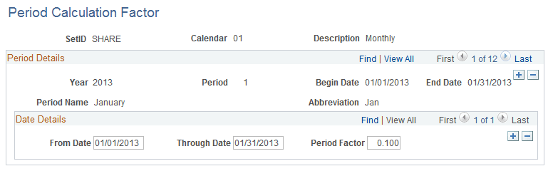

This example illustrates the fields and controls on the Period Calculation Factor page. You can find definitions for the fields and controls later on this page.
Period calculation factors are based on general ledger calendars. Select a period in the general ledger calendar and specify the dates for which you want to accumulate costs, and the factor by which you want those costs to be multiplied.
Field or Control Description
From Date and Through Date
Enter the period of time that the system uses to calculate interest. Interest is calculated on costs that are incurred during the period that you specify. Add rows to enter additional date ranges.
Period Factor
Enter the percentage of costs that the system uses to calculate interest. Interest is calculated on the specified percentage of the costs incurred—usually 100 percent—during the specified date range.
Use a decimal fraction to enter a percentage that is less than 100 percent. For example, enter .5 for 50 percent.

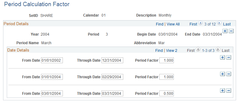

The following page illustrates period calculation factors that are set up for the Straight Average example just discussed. The last period, March, is assigned a value of 0.5 (50 percent) to reflect the assumption that half of the costs were incurred in the first half of the month, and the other half were incurred in the last half of the month.
This example illustrates the fields and controls on the Example of the Period Calculation Factor page with Straight Average method. You can find definitions for the fields and controls later on this page.

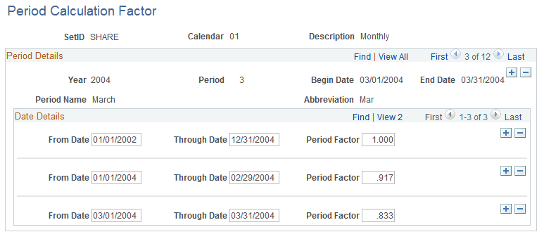

The following page illustrates period calculation factors that are set up for the FASB 34 example just discussed:
This example illustrates the fields and controls on the Example of the Period Calculation Factor page with FASB 34 method. You can find definitions for the fields and controls later on this page.
