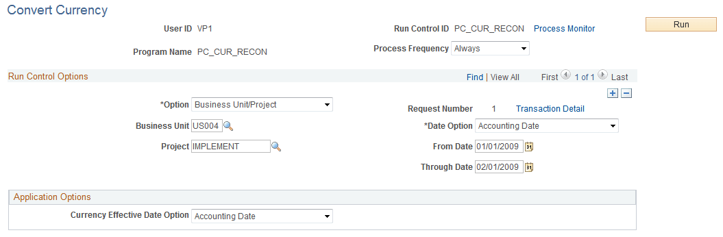

This example illustrates the fields and controls on the Convert Currency page. You can find definitions for the fields and controls later on this page.

Field or Control Description
Option
Select to convert currency for all projects and activities, or for specific ones. Options are:
  • All: Convert currency for all activities.
  • Business Unit: Convert currency for a selected business unit.
  • Business Unit/Project: Convert currency for a selected business unit and project.
  • Business Unit/Project/Activity: Convert currency for a selected business unit, project, and activity.
Transaction Detail
Click to access the Transaction List page to search for and view transactions. You must save the Convert Currency page before you click the Transaction Detail link.
Date Option
Select Accounting Date, All, or Transaction Date for the system to use to determine eligible transactions.
From Date and Through Date
Enter the date range of the eligible transactions. These fields appear if you select a date option of Accounting Date or Transaction Date.
Currency Effective Date Option
Select one of the following:
  • Accounting Date: Each transaction row's currency effective date is set to the row's accounting date.
  • Transaction Date: Each transaction row's currency effective date is set to the row's transaction date.
  • Value: Each transaction row's currency effective date is set to the currency effective date that you enter in the Application Options group box. The Currency Effective Date field appears only when you select Value as the currency effective date option.
Run
Click to initiate the Currency Conversion process.
