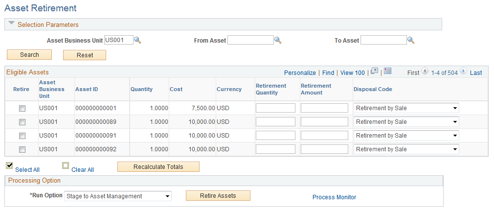

Asset Retirement Page
Use the Asset Retirement page (PC_AM_RETIRE) to run the Asset Retirement Integration process to fully or partially retire assets that are associated with Project Costing-managed projects and activities, even if the assets do not originate from the PeopleSoft Project Costing system.
Navigation:
Project Costing, and then Assets, and then Express Asset Retirement
This example illustrates the fields and controls on the Asset Retirement page. You can find definitions for the fields and controls later on this page.
Prior to retiring an asset in PeopleSoft Project Costing, process all unprocessed transaction rows pertaining to this asset out of PeopleSoft Asset Management's staging table and into production. This ensures that you have updated asset status and cost information.
Enter the asset management business unit and a range of asset IDs, if appropriate, to view a list of assets that are eligible for retirement. The system retrieves assets that meet the search criteria and:
  • Exist in PeopleSoft Asset Management as financial assets, and not as group assets.
  • Have an asset status that does not equal transferred, which indicates that the asset has been transferred from one business unit to another within PeopleSoft Asset Management.
  • Are capitalized assets.
Field or Control Description
Reset
Click to clear all search criteria fields.
Eligible Assets
Retire
Select an asset row to fully or partially retire the asset when you click Retire Assets. You must select the row for the system to process the retirement amount.
Quantity
Displays the asset's quantity which, along with the retirement quantity that you enter, is used to determine what proportion of the asset's cost is calculated and appears in the Retirement Amount field.
Cost
Displays the asset's cost which, along with the retirement amount that you enter, is used to determine what proportion of the asset quantity is calculated and appears in the Retirement Quantity field.
Retirement Quantity
Enter a retirement quantity up to the value that appears in the Quantity field for the asset. You cannot enter a retirement quantity that is greater than the asset's quantity.
Retirement Amount
Enter a retirement amount up to the value that appears in the Cost field for the asset. You cannot enter a retirement amount that is greater than the asset's cost value.
Even if the asset quantity and retirement quantity equal zero, indicating that the asset was previously retired, you can enter additional proceeds from sale or cost of removal that occurred after you retired the asset.
Disposal Code
Select the code to track the type of disposition for this asset. Available values are:
Blank
Abandoned: This code prevents the retirement process from sending the proceeds from sale to PeopleSoft Asset Management.
Cannibal
Casualty
Disappear: This code prevents the retirement process from sending the proceeds from sale or cost of removal to PeopleSoft Asset Management.
Donated
Inventory
Missing
Sale
Scrap
Theft: This code prevents the retirement process from sending the proceeds from sale or cost of removal to PeopleSoft Asset Management.
Trade-In
Recalculate Totals
Click to calculate a new value when you enter a retirement quantity or retirement amount.
Processing Option
Run Option
Select the function that the system performs when the asset retirement process runs. The run option determines the tables that the system updates with asset information during the asset retirement process. Options are:
Stage to Asset Management: Select to populate the PeopleSoft Asset Management Loader table. This is the default value.
Stage and Load Transactions: Select to populate the PeopleSoft Asset Management Loader table and the PeopleSoft Asset Management production tables.
Retire Assets
Click to run the Asset Retirement Integration process to retire the selected assets.
The system does not update the Asset Retirement page until after the AM Transaction Loader process runs in PeopleSoft Asset Management and the retirement transaction is loaded into Asset Management production tables. Run the AM Transaction Loader process to keep the Asset Retirement page current and to avoid creating duplicate retirement transactions in the PeopleSoft Asset Management Loader table.
