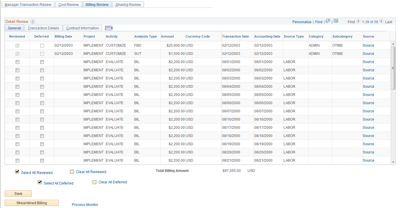

This example illustrates the fields and controls on the Billing Review page: General tab. You can find definitions for the fields and controls later on this page.
Manager Transaction Review - Billing Review: General page
The system selects data for the Billing Review page by using the Manager Transaction Review - Billing analysis group (PMBIL). Transactions appear in the Detail Review grid on the Billing Review page in three views—General,Transaction Detail,and Contract Information.
Each view displays the Reviewed, Deferred,Billing Date,Activity ID, Analysis Type,Transaction Date, andAccounting Datefields, in addition to fields that are unique to each view.
Field or Control Description
Reviewed
Displays a check mark to indicate that the project manager has reviewed the transaction. Selected transactions do not appear on future searches in the Project Manager Review component.
If the Review Required for Billing option is activated, this field must be selected before the transaction can be billed.
Note: A transaction can be included in revenue recognition before it has been reviewed and approved for billing by deselecting the Review Required for Revenue check box on the contract. In this scenario, the Reviewed selection on the Manager Transaction Review page is used as a review for billing, but not revenue recognition and can be edited even after revenue recognition has been processed. For more information on this see PeopleSoft Contracts: Contract - General Page
Deferred
Select to defer the processing of a particular project transaction for a later date. If the Review Required for Revenue check box is not selected on the contract, then this check box can be edited even if the transaction was processed for revenue.
Billing Date
Enter preferred date for billing when the transaction is deferred.
Note: The Billing Date field is enabled only if Deferred check box is selected for a particular row.
Transaction Date and Accounting Date
View transaction and accounting dates for a particular project transaction.
Source
Click this link to access the Source Transactions Review page, which displays the details of the source transaction in a consolidated grid.
Select All Reviewed, Clear All Reviewed, Select All Deferred, and Clear All Deferred
Select or deselect all rows in the displayed data grid for processing.
