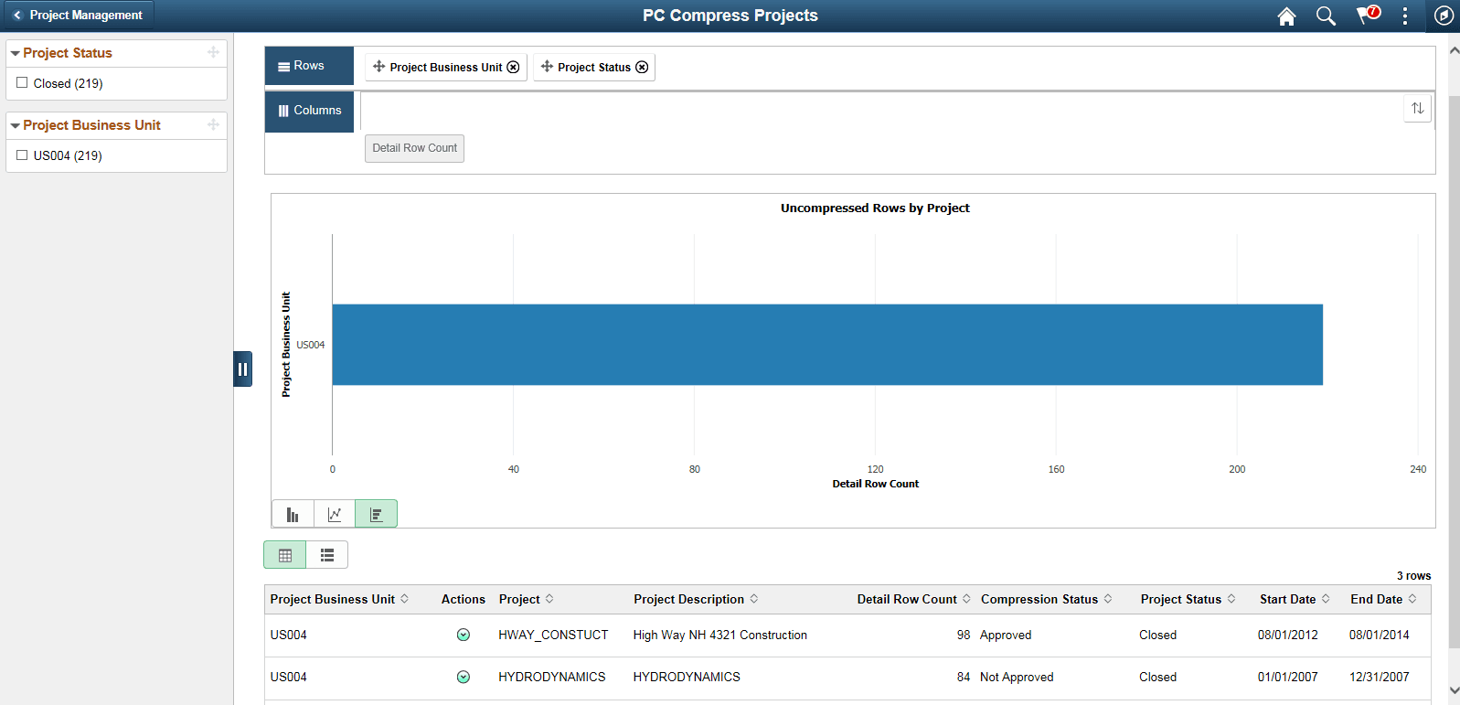

Use the PC Compress Projects page (PTPG_NUI_VWR) to view the list of projects that are eligible for compression. This page can be accessed using the Project Data Compression tile. The Project Data Compression tile displays the number of projects that are eligible for compression and the number of uncompressed transactions in the project resource table.

This example illustrates the fields and controls on the PC Compress Projects Fluid page. You can find definitions for the fields and controls later on this page.
Field or Control Description
Actions
Click to access the Project Compress Projects page where the selected project can be approved for compression.
Compression Status
Displays one of the following compression status:
  • Approved - Project is approved for compression.
  • Not Approved - Project not approved for compression. Project owner has to approve from the Projects WorkCenter page.
  • Previously Compressed - Project has already been compressed. The list of projects for compression on the Projects WorkCenter uses data stored in the materialized view PC_PRJ_TRANS_MV. The materialized view must be refreshed to view information on the WorkCenter and fluid tile. Projects with a status that is eligible for compression are included in the materialized view. If a project status is updated, the materialized view must be refreshed in order to view the project on the WorkCenter and fluid tile. See PeopleTools: Using Materialized Views.
