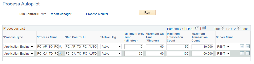

Process Autopilot Page
Use the Process Autopilot page (FMSAUTOPILOT_REQ) to set up Autopilot to perform recurring batch processing using PeopleSoft Process Scheduler.
Navigation:
This example illustrates the fields and controls on the Process Autopilot page. You can find definitions for the fields and controls later on this page.
| Field or Control | Description |
Process Type |
Select Application Engine for PeopleSoft Project Costing. |
Process Name |
Enter the process to run. Not all processes can use Autopilot. For a list of available PeopleSoft Project Costing processes that can be run using Autopilot, see PeopleSoft Project Costing Processes Available for Autopilot. |
Active Flag |
Select Active to enable the process. Select Disable to disable an individual process even after Autopilot has started. |
Minimum Wait Time (Minutes) |
Enter the minimum number of minutes that must elapse between processing runs. |
Maximum Wait Time (Minutes) |
Enter the maximum number of minutes that can elapse between process runs, regardless of whether the Minimum Transaction Count parameter is satisfied. |
Minimum Transaction Count |
Enter the fewest number of transactions that must be present for processing to occur, unless the Maximum Wait Time parameter is surpassed. |
Maximum Transaction Count |
Enter the maximum number of transactions that can be processed. If the amount of transactions waiting to be processed exceeds this amount, the process will not run in Autopilot regardless of the other settings. |
