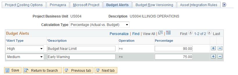

This example illustrates the fields and controls on the Budget Alerts page (Percentage calculation type). You can find definitions for the fields and controls later on this page.

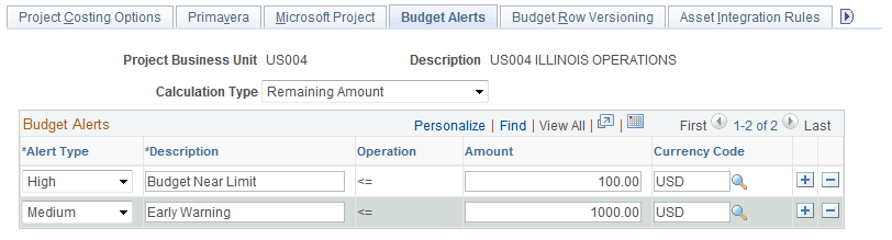

This example illustrates the fields and controls on the Budget Alerts page (Remaining Amount calculation type). You can find definitions for the fields and controls later on this page.

Calculation Type
Select the method for calculating how the budget alert threshold is determined. Available options are:
Percentage (Actual vs. Budget): Triggers the budget alert when the actual cost of the project reaches the defined percentage (entered in the Percentage field) of the budgeted amount. The calculation for this type of budget alert threshold is: (Actual Costs) ÷ (Budget Amount) x 100 ≥ (Percentage field value)
Remaining Amount: Triggers the budget alert when the actual cost of the project reaches the defined remaining amount (entered in the Amount field) of the budgeted amount. The calculation for this type of budget alert threshold is: (Budget Amount) – (Actual Costs) ≤ (Amount field value)
Alert Type
Select the level of alert that you are defining. Available options are:
Medium: Visual status indicator appears as an inverted yellow triangle on the Budget vs. Actual page.
High: Visual status indicator appears as a red square on the Budget vs. Actual page.
A Low visual status indicator appears as a green circle on the Budget vs. Actual page if actual costs have not reached the medium or high thresholds, or if you do not define budget alert thresholds.
Operation
Displays the operand that the system uses to define the calculation that determines the budget alert threshold.
<= (less than or equal to): Appears when you select Remaining Amount as the calculation type.
>= (greater than or equal to): Appears when you select Percentage (Actual vs. Budget) as the calculation type.
This field is not editable.
Percentage
Enter the percentage of the budget that triggers the budget alert. This field appears only if you select Percentage (Actual vs. Budget) as the calculation type.
Amount
Enter the monetary amount of the budget that triggers the budget alert. This field appears only if you select Remaining Amount as the calculation type.
