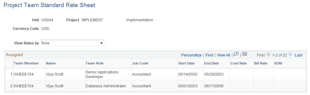

Project Team Standard Rate Sheet Page
Use the Project Team Standard Rate Sheet page (PC_TEAM_RATES) to view team roles, job codes, project availability dates, and cost and bill rates by employee, project role, and job code for project team members.
Navigation:
Project Costing, and then Project Definitions, and then Team, and then Team. Click the Team Rates link on the Project Definitions - Team page.
This example illustrates the fields and controls on the Project Team Standard Rate Sheet page. You can find definitions for the fields and controls later on this page.
Project team members appear on this page if you defined a project team role for the member.
Field or Control Description
View Rates by
Select Employee, Job Code, or Role to view different project team rates.
Cost Rate and Bill Rate
Displays the cost and bill rates associated with the team member and the option that you select in the View Rates by field. The system converts these rates as necessary to the currency of the business unit.

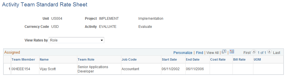

Activity Team Standard Rate Sheet Page
Use the Activity Team Standard Rate Sheet page (PC_ACT_TEAM_RATES) to view the cost and bill rates for activity team members by employee, job code, or role.
Navigation:
Project Costing, and then Activity Definitions, and then Team, and then Team. Click the Activity Team Rates link on the Activity Definitions - Team page.
This example illustrates the fields and controls on the Activity Team Standard Rate Sheet page. You can find definitions for the fields and controls later on this page.
View Rates by
Select Employee, Job Code, or Role to view different activity team rates.
Displays the cost and bill rates associated with the activity team member and the option that you select in the View Rates by field. The system converts these rates as necessary to the currency of the business unit.
