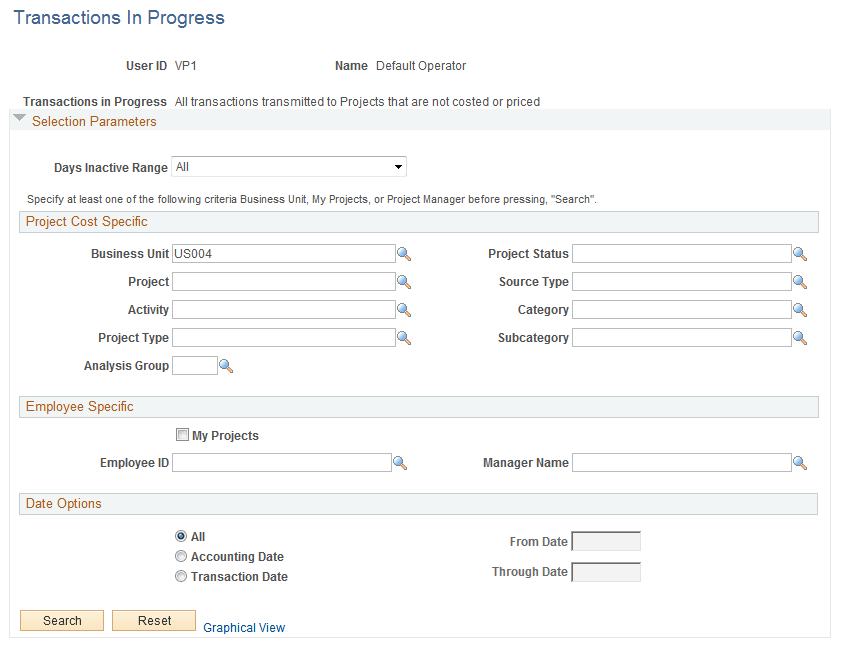

Transactions in Progress Page
Use the Transactions in Progress page (PC_TIP) to enter search criteria and display a list of project transaction details that are in progress.
Navigation:
Project Costing, and then Interactive Reports, and then Transactions in Progress, and then Transactions in Progress

Selection Parameters
Field or Control Description
Days Inactive Range
Select an option that reflects the number of days between the current system date and the transaction date of the TIPs that you want to view. Available options are:
31 to 60
61 to 90
< 31
> 90
All
Enter the remaining search criteria to filter TIPs and click Search. The list of TIPs appears in the Transactions grid.
Click the Graphical View link to view a chart that contains the listed TIPs.

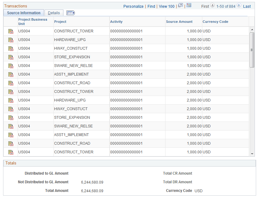

Transactions
This grid lists the TIPs that meet the search criteria.
Click the Drill to Source icon to access the transaction source for the corresponding row. The type of TIP determines the page that opens when you click Drill to Source.
This table lists the pages that open when you click the Drill to Source icon:
Transaction in Progress Source Transaction Page

Source Information
Select this tab to view information from the transaction source, such as voucher, purchase order or page, the associated business unit, project, activity, currency, and more depending on the transaction source.
Some subsystems do not require that you enter an activity ID for a project. However, PeopleSoft Project Costing requires that you enter activity ID for all projects. If a project does not have an activity ID, an error occurs. To enable you to view any projects that do not yet have an activity ID assigned, the Activity field is blank on the Source Information tab. Before these transactions are processed in Project Costing, you must assign an activity ID.
Details
Select this tab to view additional fields from the transaction. The fields that appear are based on the type of TIP that you select.
Totals
This group box displays the summarized amounts of debits and credits that are distributed and are not distributed to PeopleSoft General Ledger for the select TIP transactions. These values appear on the page only if the GL Distribution Status is Distributed.
The Totals group box shows the summarized values only when the currency code is the same for all the TIP transactions. If the TIP transactions have different currency codes, a message appears in the Totals group box.

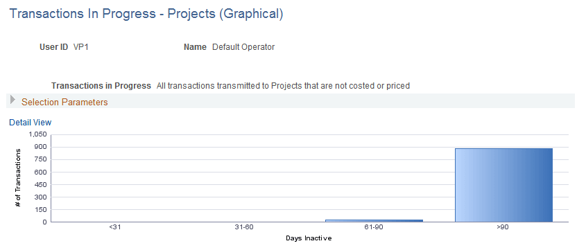

Transactions in Progress - Projects (Graphical) Page
Use the Transactions in Progress - Projects (Graphical) page (PC_TIP2) to view project transactions that are in progress in a chart format.
Navigation:
Click the Graphical View link on the Transactions in Progress page.
This example illustrates the fields and controls on the Transactions In Progress - Projects (Graphical) page. You can find definitions for the fields and controls later on this page.
Use this page to view an aging report for the transactions in the inquiry.
Expand this section to view the filtering options that the system used to select the TIPs for the graph.
Detail View
Click to return to the Transactions In Progress detail page to view the list of TIPs that appear in the chart.
