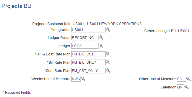

Projects BU Page
Use the Projects BU page (GM_PM_BU_PC) to define proposal management defaults for the PeopleSoft Project Costing business unit.
Navigation:
Setup Financials/Supply Chain, and then Business Unit Related, and then Proposal Management, and then Associate PPM to PC BU
This example illustrates the fields and controls on the Projects BU page. You can find definitions for the fields and controls later on this page.
Projects BU page
After you select an integration template, the system displays the appropriate ledger and ledger group fields based on how you have configured your PeopleSoft General Ledger system. If you are using PeopleSoft Commitment Control, the system displays separate ledger and ledger group fields for expense and revenue transactions.
Ledger Group and Ledger are for non-Commitment Control General Ledger business units. Revenue Ledger Group, Revenue Ledger, Expense Ledger Group, and Expense Ledger are for Commitment Control General Ledger business units. In all situations, ledger fields are optional, but ledger groups fields are required.
Field or Control Description
Integration
Select the template that defines the integration between PeopleSoft Project Costing and the other PeopleSoft Financials applications. Each integration template that you create defines a specific set of business units from the other financial applications.
Select the ledger group and ledger that you want the system to use when posting transactions to the general ledger from the business unit.
Expense Ledger Group, Expense Ledger, Revenue Ledger Group, and Revenue Ledger
These fields appear only if you are set up to use PeopleSoft Commitment Control. Select the ledger groups and ledgers that you want the system to default when bringing forward expense and revenue rows that are to be posted to the general ledger.
Bill & Cost Rate Plan
Select a rate plan with billing and costing rate sets. The prompt view for this field displays only active rate plans that contain both billing and costing rate sets.
Bill Rate Plan
Select a rate plan with billing rate sets only. The prompt view for this field displays only active rate plans that contain billing rate sets only.
Cost Rate Plan
Select a rate plan with costing rate sets only. The prompt view for this field displays only active rate plans that contain costing rate sets.
Weeks Unit of Measure
Select MWK for the default unit of measure to use when employees select Labor Configuration of Weeks on proposals.
PeopleSoft Proposal Management enables you to set the Labor Configuration by hour, day, or week; however, PeopleSoft Project Costing only supports hour or day for unit of measure. You can set up the unit of measure for hour or day on the Project Costing Definition page, but you need to set the unit of measure for week on PeopleSoft Proposal Management's Projects BU page.
Other Unit of Measure
Select a unit of measure to default on proposals for non-labor items.
Calendar
This field provides an override value to the default budget calendar that is used by Projects budgets. A budget calendar can be defined for one budget period with a vast time span to cover the start and end date periods for projects.

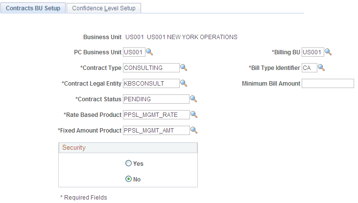

Contracts BU Setup Page
Use the Contracts BU Setup page (GM_BU_PM_SETUP) to define proposal management defaults for the Contracts business unit.
Navigation:
Setup Financials/Supply Chain, and then Business Unit Related, and then Proposal Management, and then Associate PPM to Contract BU
This example illustrates the fields and controls on the Contracts BU Setup page. You can find definitions for the fields and controls later on this page.
PC Business Unit (project costing business unit)
Select the PeopleSoft Project Costing business unit in which you want to store your projects-related information.
Billing BU (billing business unit)
Select the business unit that you want to use for billing. This field is a default for contracts that are created under this business unit. The values that you can select are limited to those PeopleSoft Billing business units that are linked to the same general ledger business unit as the contracts business unit.
Contract Type
Select a value to categorize your contracts for reporting purposes.
Bill Type Identifier
Select a bill type. This field is a default for contracts that are created under the business unit. The bill type represents a category of activity that is being billed.
Contract Legal Entity
Select a legal entity from the list of entities that you established on the Define Legal Entity page in PeopleSoft Contracts. This is the legal entity in your company that owns or has signed the contract. A legal entity is required for contract activation.
Minimum Bill Amount
Enter an amount to specify the minimum threshold that will produce a bill during contract administration.
Contract Status
Select the status to appear by default when the contract is first established. The system uses this field to control all processing that occurs against a contract.
Rate Based Product
Select the rate-based product that you will use most often on the contract lines. The lookup list for this field displays only product IDs with a price type of Rate and a revenue recognition method of As Incurred. Products are defined on the Product Definition pages and in PeopleSoft Contracts.
Fixed Amount Product
Select the fixed-amount product offering that you will use most often on the contract lines.
The lookup list for this field displays only products with a price type of Amount and a revenue recognition method other than As Incurred. Products are defined in the Product Definition pages and in PeopleSoft Contracts.
Security
Select Yes to enable security. When security is enabled, the list of users who can view a proposal is limited to those who have been given security access on the Proposal - Set Up Options page.
