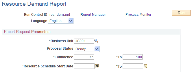

Resource Demand Report Page
Use the Resource Demand Report page (RUN_GM_RES_RPT) to analyze the demand on labor resources for future months according to project role.
Navigation:
Proposal Management, and then Reports, and then Resource Demand Report
This example illustrates the fields and controls on the Resource Demand Report page.
To generate the resource demand report, select a business unit, proposal status, confidence level, and resource schedule start and end dates. Click Run. Click Process Monitor. Select the labor Resource Demand by Project Role report from the Process Scheduler Request page and then click OK.
