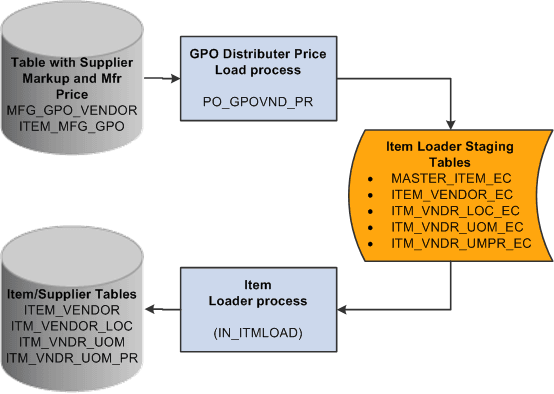

This diagram illustrates the data flow for calculating GPO distributor prices:
GPO distributor price calculations process

This process calculates the distributor price by increasing the manufacturer's price by the markup percentage from the GPO Distributor page. Use the controls on this page to determine parameters for the distributor (supplier) prices that you want to load.
See GPO Distributor (define group purchasing distributor) Page.
The process stores data in these item staging tables:
  • EO_EIP_CTL
  • MASTER_ITEM_EC
  • ITEM_VENDOR_EC
  • ITM_VNDR_LOC_EC
  • ITM_VNDR_UOM_EC
  • ITM_VNDR_UMPR_EC
After you run the Distributor Price Load process, you should run the Item Loader process to put item and supplier prices into production tables. Tables populated by Item Loader process for distributor prices include:
  • ITM_VENDOR_LOC,
  • ITM_VNDR_UOM
  • ITM_VNDR_UOM_PR
