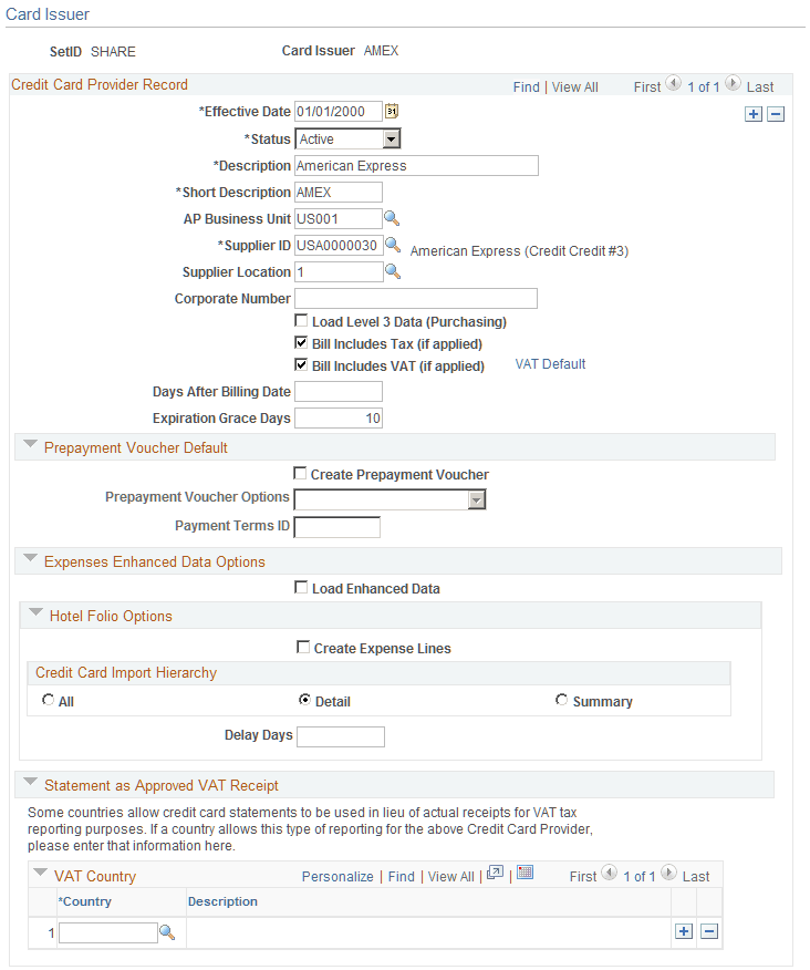

Card Issuer Page
Use the Card Issuer page (CC_CARD_TBL) to enter details about the procurement card providers and link these details to a supplier ID.
Navigation:
Setup Financials/Supply Chain, and then Product Related, and then Procurement Options, and then Purchasing, and then PCard Card Issuers
This example illustrates the fields and controls on the Card Issuer Page. You can find definitions for the fields and controls later on this page.
Card Issuer page
Credit Card Provider Record
Field or Control Description
AP Business Unit (PeopleSoft Payables business unit)
Select the PeopleSoft Payables business unit that will be used for the prepayment voucher and for staging reconciled transactions.
Load Enhanced Data
Select this check box if you want to load itemized data for the procurement card transactions associated with this card issuer. Examples of enhanced data is additional information related to a transaction such as car rental, lodging, and passenger itinerary information.
Bill Includes Tax (if applied)
Select this check box to indicate that the procurement card provider record includes sales tax, if applicable.
Bill Includes VAT (if applied)
Select this check box to indicate that the procurement card provider record includes value-added taxes, if applicable.
VAT Default (value-added tax default)
Click this link to access the VAT Defaults Setup page, where you can set VAT tolerances to check the difference between the calculated VAT amount and the amount entered on the bank statement.
See PeopleSoft Global Options and Reports: Understanding VAT.
Prepayment Voucher Default
Create Prepayment Voucher
Select this check box if you want to create a prepayment voucher for the procurement card statement amount.
Prepayment Voucher Options
Select the prepayment voucher option. Values are:
  • Auto Apply: Select this option to have the system use the accounting entry template for the debit side of the transaction. If you select this option you can not select the prepayment voucher ChartFields on the Card Issuer - Setup Prepayment ChartFields page.
  • Specify: Select this option if you want to specify the ChartFields to be used for the prepayment voucher. This option also creates a reference ID so that only transactions from the same statement as the prepayment will be drawn down for that prepayment.
Once you select a prepayment voucher option the Setup Prepayment ChartFields link becomes available.
Payment Terms ID
Select the payment terms for the prepayment voucher.
Click this link to access the Card Issuer - Setup Prepayment ChartFields page. Use this page to define prepayment ChartFields.
Expenses Enhanced Data Options
This group box enables you determine how many days you would like to delay importing enhanced data transactions into the system. This enables enhanced data, such as hotel, car rental, or air travel, to be available if it comes in a separate file.
Load Enhanced Data
Select to indicate that your system imports enhanced data such as airfare, car rental, and lodging, from credit card suppliers.
Deselect to indicate that your system does not import enhanced data from credit card suppliers.
Create Expense Lines
Select to indicate that when the Load Enhanced Data check box is selected, then enhanced data is to be broken into individual expense lines.
Deselect to indicate that when the Load Enhanced Data check box is selected, then enhanced data is loaded, but not broken into individual expense lines. Only the main transaction line is available for an expense report.
Credit Card Hierarchy
Select the type of data to import when enhanced data from credit card suppliers is loaded:
  • All:Select to use a hierarchical approach to import detail data or summary data, and the main transaction.
  • Detail:Select to import detail data and the main transaction.
  • Summary:Select to import summary data and the main transaction.
First, the system looks for detail data in the file that is received from the credit card supplier. If detail data is available, and no delay days exist, then the system loads the detail data and the main transaction to My Wallet. If detail data is available, and the delay days number is greater than zero, then the system loads the detail data and the main transaction into the staging tables.
If the system does not find detail data, it looks for summary data. If summary data is available, and no delay days exist, then the system loads the summary data and the main transaction to My Wallet. If summary data is available, and the delay days number is greater than zero, then the system loads the summary data and the main transaction into the staging tables.
If the system does not find detail data or summary data, it loads the main transaction to My Wallet.
Note: If the detail or summary amount does not match the transaction amount, only transaction rows are loaded.
If detail data is not available, the system imports only the main transaction. The system does not look for summary data.
If the system does not find detail data, or if the detail amount does not match the amount of the main transaction, it imports only the main transaction.
This is the only option and is automatically selected if the credit card supplier is American Express.
If the system does not find summary data, or if the summary amount does not match the amount of the main transaction, it imports only the main transaction.
Delay Days
Enter the number of days that the system waits to load enhanced data into My Wallet transactions.
This field is used during the Load External Data process to determine the number of days to wait to load hotel information into My Wallet. This allows time for the summary data, detail data, or both to be imported if it is sent in a separate file from the main transaction. All other transactions flow through, but the hotel transactions are moved into staging tables and are not available in My Wallet until the appropriate number of days has passed.
Credit Card Import Hierarchy
Use this group box to determine what type of data to import.
All
Select to have the system check for detail data. If detail data exists, the system imports the data as well as the main transaction. If there is no detail data, the system checks for summary data, and if it finds that data imports it as well as the main transaction. If neither types of data are available, the system imports only the main transaction. All is the default value for the group box.
Detail
Select to have the system attempt to import the detail data. If detail data is not available, the system only imports the main transaction. The system does not check for summary data. If the detail data amount is not available or the total does not match, the system only imports the main transaction data.
Summary
Select to have the system attempt to import summary data. If summary data is not available, the system only imports the main transaction.
Statement as Approved VAT Receipt
Country
If the card issuer is an approved provider for claiming tax credit from procurement card statements, select the name of the country that uses credit card statements in lieu of actual receipts for VAT reporting.
When the country is listed, the ProCard Load Statement Application Engine process (PO_CCLOADLD) sets the Claiming Tax Credit field to Yes, indicating that the electronic statement can be used as evidence of VAT for claiming VAT recovery. When this is the case, no additional receipt documentation is required for VAT reporting purposes. The system performs appropriate calculations of VAT rebate and recovery for these lines.
When the country does not allow electronic versions of the procurement card statement to serve as evidence of VAT recovery, the user has the option to indicate whether a VAT receipt exists on the Reconcile Statement - Procurement Card component.
