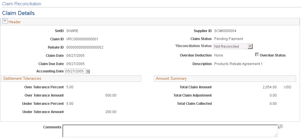

Use the Claim Reconciliation - Claim Details page (VRBT_CLAIM_RECON) to view claim reconciliation details and maintain claim payment exceptions.
Navigation:
Purchasing, and then Vendor Rebates, and then Vendor Rebate Claims, and then Claim Reconciliation
This example illustrates the fields and controls on the Claim Reconciliation - Claim Details page (1 of 2). You can find definitions for the fields and controls later on this page.
This example illustrates the fields and controls on the Claim Reconciliation - Claim Details page (2 of 2). You can find definitions for the fields and controls later on this page.
Header and Settlement Tolerances
Most of the fields that appear in these sections on this page are the same as those that appear on the Claim - Details page.
See Claim - Details Page.
Field or Control Description
Accounting Date
The accounting date appears by default as the claim date. You can override it. Select another accounting date if you want to record all the subsequent transactions that are sent to PeopleSoft Payables or PeopleSoft Receivables with this accounting date.
Overriding the accounting date is useful in cases in which the claim life cycle is long and spans multiple accounting periods. For example, assume that you generate a claim in a particular accounting period, but due to some disputes with the supplier, you can make the decision to close outstanding remaining claim amounts only in subsequent accounting periods (previous accounting period might already be closed). Overriding the accounting date enables you to record the adjustment in the current accounting period.
Claim Status
Displays the current claim status. Statuses are Open, Approved, Deferred, Pending Payment, Partially Paid, and Paid.
Reconciliation Status
The current reconciliation status appears. Statuses are Exception, Pending, Reconciled, and To Be Reconciled.
Change this status to handle claim payment exceptions. You can change the status from Exception to either Reconciled or To Be Reconciled.
Amount Summary
Total Claim Amount
Displays the total claim amount in the vendor rebate agreement currency.
Total Claim Adjustment
Displays the total claim adjustment amount in the currency for the vendor rebate agreement.
Total Claim Adjustment = (Total Claim Amount – Original Claim Amount)
Total Claim Collected
Displays the total claim amount collected in the currency for the vendor rebate agreement.
Total Claim VAT Amount (total claim value added tax amount)
Displays the total claim VAT amount in the vendor rebate agreement currency. This field appears only if you are using VAT.
VAT Collected (value added tax collected)
Displays the VAT amount that is collected in the vendor rebate agreement currency. This field appears only if you are using VAT.

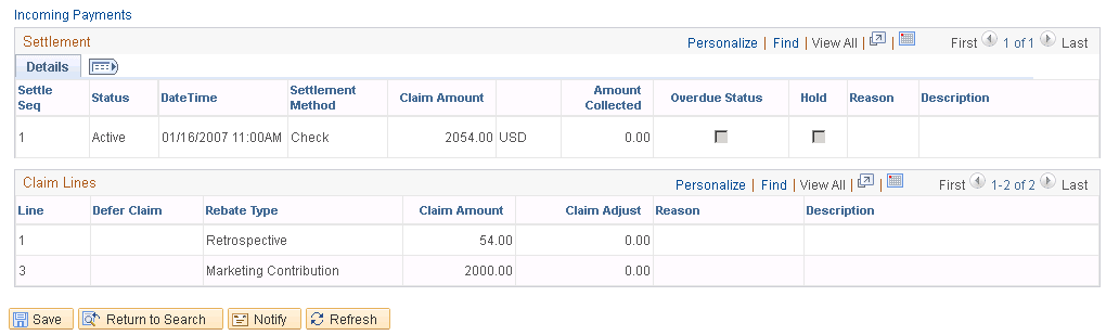

Settlement
DateTime
Displays the date and time when the settlement was created.
Claim Lines
Claim Adjust
Displays the claim adjustment amount for this claim and line in the vendor rebate agreement currency.
Claim Adjust = (Claim Amount – Original Claim Amount)
Additional Links
Incoming Payments
Click this link to access the Claim Reconciliation - Incoming Payments page. Use this page to view the claim payment details that came from PeopleSoft Payables and PeopleSoft Receivables.

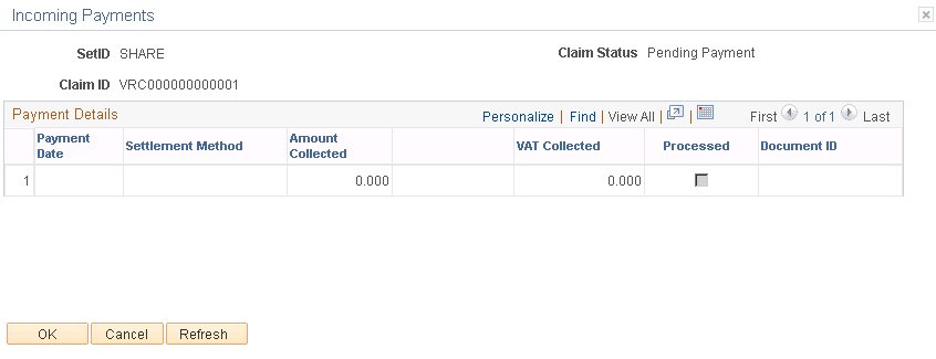

Use the Claim Reconciliation - Incoming Payments page (VRBT_RECON_INPAY) to view incoming payments details that are associated with a vendor rebate claim.
Navigation:
Click the Incoming Payments link on the Claim Reconciliation - Claim Details page.
This example illustrates the fields and controls on the Claim Reconciliation - Incoming Payments page. You can find definitions for the fields and controls later on this page.
AP Payment Reference (account payables payment reference)
Click this link to access the Voucher Inquiry page. Use this page to view all the details that are associated with this voucher.
AR Payment Reference (account receivables payment reference)
Click this link to access the Customer Item Inquiry page. Use this page to view all the details that are associated with this pending item payment.
