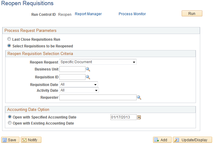

Reopen Requisitions Page
Use the Reopen Requisitions page (RUN_PO_REQREOPEN) to run the Requisition Reopen process.
Navigation:
Purchasing, and then Requisitions, and then Reconcile Requisitions, and then Reopen Requisitions, and then Reopen Requisitions
This example illustrates the fields and controls on the Reopen Requisitions page. You can find definitions for the fields and controls later on this page.
Field or Control Description
Last Close Requisitions Run
Select this option if you want to reopen the requisitions that were closed during the last run of the Close Requisitions process. When you select this option, the Reopen Requisition Selection Criteria group box is not available.
Select Requisitions to be Reopened
Select this option if you want to reopen any requisition that has already been closed. After you select this option, enter the requisition or requisitions you would like to reopen in the Reopen Requisition Selection Criteria group box.
Reopen Request
Select the reopen request option. Values are:
  • Range of Documents: Select if you want to reopen a range of requisitions. After you select this option, select the requisition range using the Requisition ID and To fields.
  • Specific Business Unit: Select if you want to reopen the requisitions associated with a specific business unit. After you select this option, select the business unit using the Business Unit field.
  • Specific Document: Select if you want to reopen a specific requisition. After you select this option, select the requisition using the Requisition ID field.
Requisition Date
Select a requisition date option. Values are:
  • All: Select if you want to reopen requisitions for all requisition dates.
  • Range: Select if you want to reopen requisitions for a certain date range. After you select this option, select the date range using the From and To date fields next to this field.
  • Value: Select if you want to reopen requisitions for a specific date. After you select this option, select the date using the date field next to this field.
Activity Date
Select an activity date option. Values are:
  • All: Select if you want to reopen requisitions for all activity dates.
Requester
Select the requester. Requisitions associated with this requester will be reopened.
Accounting Date Options
Open with Specified Accounting Date
Select this option if you want to reopen the requisitions using the accounting date you specify. The current date appears by default in the date field but you can override it if you choose. This field only appears if you are using commitment control.
Open with Existing Accounting Date
Select this option if you want to reopen the requisitions using the existing accounting date on the requisitions. This field only appears if you are using commitment control.
