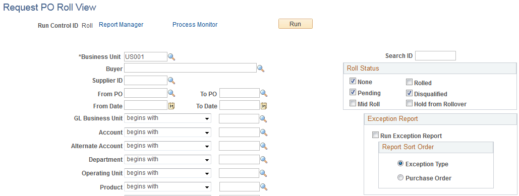

PO Rollover View Page
Use the PO Rollover View page (RUN_POROLLVW) to create a data set for retrieval by the purchase order rollover workbench by initiating the Rollover View (PO_POROLLVW) Application Engine process.
Navigation:
Purchasing, and then Purchase Orders, and then Budget Year End Processing, and then Request PO Roll View, and then PO Rollover View

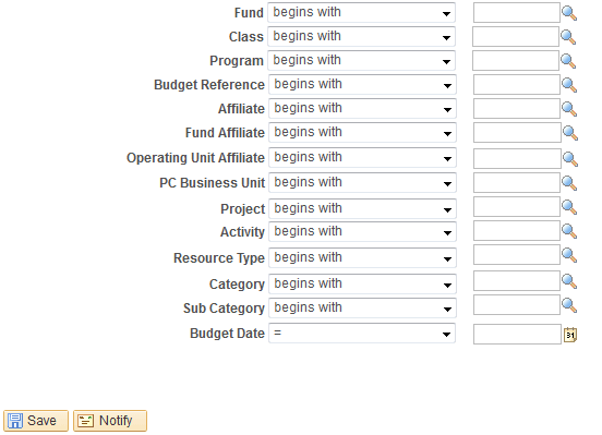

This example illustrates the fields and controls on the Request PO Roll View (1 of 2). You can find definitions for the fields and controls later on this page.
This example illustrates the fields and controls on the Request PO Roll View (2 of 2). You can find definitions for the fields and controls later on this page.
It is recommended that you create data sets that are no greater than 1000 rows. Any larger and the processing times on the purchase order rollover workbench can be substantial.
The PO Rollover View page enables you to limit the information contained in a data set. You use the page to define selection criteria for the PO_POROLLVW process. Along with limiting basic information, such as a business unit, a buyer, or a purchase order, you can limit the data set to ChartField values. For example, you can limit the data set to a specific ChartField or a range of ChartFields.
In addition, you can limit information in data sets using logic operands against a ChartField. These operands include, for example, Begins with, Equal, and Less than. So if you want to include ChartFields for a specific fund affiliate, you would use the In operand. The system displays a General Ledger Business Unit field that you use to select a fund affiliate to include in the data set.
The qualifier “Is not empty” is added for the following fields: GL Business Unit, Account, Alternate Account, Department, Operating Unit, Product, Fund, Class, Program, Budget Reference and Affiliate, PC Business Unit, Project, Activity, Resource type, Category and Sub Category.
Selecting “is not empty” hides the adjacent text box.
The applicable qualifiers added for the ‘Budget date’ fields
= Should fetch those purchase order distributions whose budget date is matching with this date
Should fetch those purchase order distributions whose budget date doesn’t match with this date
Should fetch those purchase order distributions whose budget date is less than this date
Should fetch those purchase order distributions whose budget date is less or equal to this date
Should fetch those purchase order distributions whose budget date is greater than this date
Should fetch those purchase order distributions whose budget date is greater than or equal to this date
BETWEEN
Should fetch those purchase order distributions whose budget date is in between the from and the to date mentioned here. When this qualifier is chosen, 2 edit boxes should be opened to enable a range of date to be entered
Field or Control Description
Search ID
Enter a search ID for this data set. The search ID is used to retrieve the data set on the PO Rollover page.
Note: If the search ID is reused for different search criteria, the previously selected data will be overwritten. PeopleSoft recommends a unique search ID for each different set of search criteria.
Roll Status
The following rules apply to purchase order selection:
When you select Rolled and None and a purchase order has both statuses, the line becomes available for selection. All distributions with these statuses appear with the appropriate roll error on the More Details tab on the Purchase Order Details page. The rolled distributions are not included in the rollover processes:
  • When you select None and a purchase order has distributions that have previously been rolled, only the distributions that have not been rolled appear. The lines are available for selection on the PO Rollover page.
  • When you select Rolled, any rolled distributions appear on the PO Rollover page, but they are not available for selection there.
  • Once you select a purchase order and it is in Pending or Mid Roll status, it does not appear again unless you select those specific statuses. You cannot select lines that are in Mid Roll status on the PO Rollover page.
Important:
When you select and stage a line for rolling, it is removed from staging if it reappears on the PO Rollover page, is available for selection, and is not selected for staging again. Therefore, successive applications of the filters on this page should be more restrictive.
None
Select this check box to find purchase orders that have no other roll status, because they have not yet been selected for rolling, or they have been selected and then removed from the selection process.
Pending
Select this check box to find purchase orders that have been selected for rolling.
Mid Roll
Select this check box to find purchase orders on which you have run the PO Rollover1 process. Purchase orders with this header status are protected from all actions except budget checking and rollover. Purchase orders with this status cannot be copied into vouchers.
Rolled
Select this check box to find purchase orders that have been rolled.
Disqualified
Select this check box to find purchase orders that have been identified during the PO Rollover1 process as being in error and, therefore, are not eligible to continue the Rollover process. When you want to include disqualified purchase orders, the program does not delete them from the processing results. Selecting this check box is useful for customers who want to see the documents that may require additional work before the year-end roll.
Hold from Rollover
Select to hold the selected purchase orders from rolling over when you know that there is additional work to be done on the order. For purchase orders to be eligible to set to Hold from Rollover, they should be in a roll status of None or Pending. When purchase orders are in a Hold status they are not qualified for PO Rollover 1 (PO_POROLL1) or PO Rollover 2 (PO_POROLL2) rollover processing.
Exception Report
Use this grid box to indicate that you want to run the PO Rollover Exceptions report and to define the sort method for the report.
Run Exception Report
Select to also run the PO Roll Exceptions report when you run the PO Roll View process. Exception types are made up of the rollover error and information associated with the error. For each rollover error type, the report displays the error title and information. Examples of exception types include "Invalid budget status on PO" and "Invalid budget status on PO and voucher."
Exception Type
Select to sort the PO Rollover Exceptions report by exception type. The system sorts the report first by Search ID and business unit, then by exception type, and finally by purchase order keys.
Purchase Order
Select to sort the PO Rollover Exceptions report by purchase order ID. The system first sorts the report by Search ID and business unit, then by purchase order ID, and finally by exception type.
Other Information
Run
Click this button to initiate the PO_POROLLVW process that creates the data set that you can select on the PO Rollover page.

Run Roll Exception Page
Use the Run Roll Exception page (RUN_ROLL_EXCEPTION) to run the Non Qualified PO Listing process.
Navigation:
Purchasing, Purchase Orders, Budget Year End Processing, Non Qualified PO Listing
Use this page to create the PO Rollover Exceptions report. The report displays the non-qualified purchase orders and their associated documents.
To populate the tables that produce the report, you need to run the PO Rollover View process to create a data set on which to run the report. The report is also available as an BI Publisher report.
You can also access the Run Roll Exception page using the PO Rollover View and PO Rollover 1 pages and by using the PO Rollover Workbench.
Business Unit
Select a PeopleSoft Purchasing business unit to limit your report to non-qualified purchase orders within this one business unit.
Search ID
Select a search ID. A search ID is made up of a data set that you define on the PO Rollover View page. The system uses the data set to create the PO Rollover Exceptions report. The report contains the purchase orders that are not qualified for rolling over.
Exception Type
Select to sort the PO Rollover Exceptions report by exception type. Exception types are the kinds of errors that prevent purchase orders from rolling over. The system sorts the report first by purchase order ID and business unit, then by exception type, and finally by purchase order keys. An example of an exception type is when a budget status on the purchase order is not valid.
Purchase Order
Select to sort the PO Rollover Exceptions report by purchase order ID. The system first sorts the report by purchase order and business unit, then by purchase order ID, and finally by exception type.
