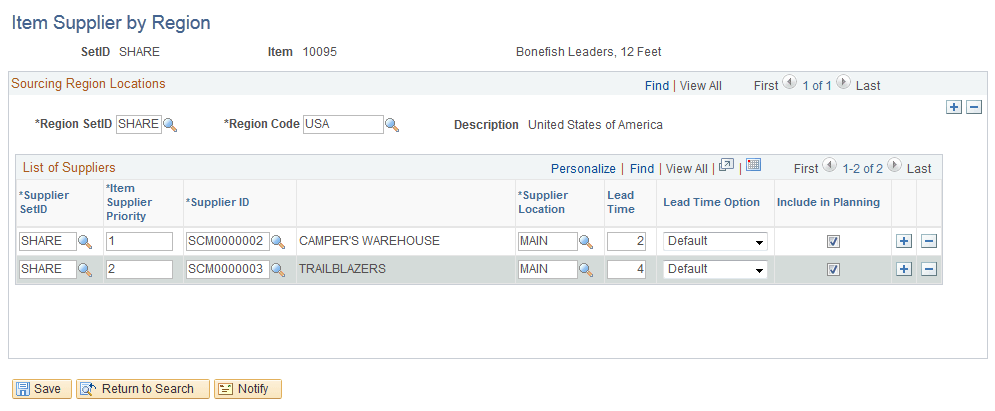

Item Supplier by Region Page
Use the Item Supplier by Region page (ITM_REGION_VNDR) to define supplier priority and supplier location by region.
Navigation:
Items, and then Define Items and Attributes, and then Item Supplier by Region
This example illustrates the fields and controls on the Item Supplier by Region. You can find definitions for the fields and controls later on this page.
Field or Control Description
Region Code
Select a region code to associate with this regional supplier.
Item Supplier Priority
Enter the priority order for which a supplier will be selected for regional sourcing.
Supplier ID
Select the supplier that you want to associate with this supplier region.
Supplier Location
Select the location for the supplier.
Lead Time
Enter the lead time that you want purchase order sourcing to use in determining the purchase order lead time. Item region is level two in the defaulting hierarchy after the item ship to supplier level. If you don't use this value, purchase order sourcing checks at level three in the defaulting hierarchy (Item/Supplier attributes).
Lead Time Option
Select the option that you want to use along with the lead time value. Select Default to use the next level lead time. Select Use to use the lead time defined at this level.
Include in Planning
Select to enable purchase options to be created in PeopleSoft Supply Planning for the PeopleSoft Inventory business unit related to this item supplier. The purchase option then enables the creation of new purchase orders through PeopleSoft Supply Planning for this PeopleSoft Inventory business unit.
