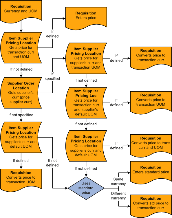

This diagram illustrates the multicurrency conversion hierarchy:

Use these steps to determine the requisition multicurrency price:
If the pricing location has a price defined in the requisition currency and UOM, this is the price that is used.
If there is no match in step 1, the system looks at the currency defined for the supplier order location.
If the supplier location currency (price supplier location) is not specified, the system moves on to step 4.
If the supplier location currency (price supplier currency) is specified, the system accesses the item-supplier pricing location to obtain the price for the supplier location currency (price supplier currency) and transaction UOM. If there is a match, the system takes that price and converts it to the transaction currency.
If there is no match in Step 3, the system uses the transaction currency and supplier default UOM to find a match in the pricing location.
If it finds a match, this price is used on the requisition. When there is no match and if the supplier location currency is not defined, the system skips step 5 and moves on to step 6.
If there is no match in step 4, the system uses the price supplier currency derived in step 2 and the default UOM when checking the pricing location.
If there is a match, it converts it to the transaction currency.
If there is no match in step 5, the system uses the standard price.
If the currency is different, it converts that price to the transaction currency.
The requisition base price is derived from the transaction price. If the transaction price is in a different currency, the system converts it into the base price currency.
