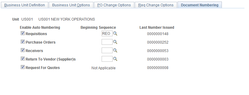

Purchasing Definition - Document Numbering Page
BUS_UNIT_TBL_PM3
Define transaction document autonumbering options.

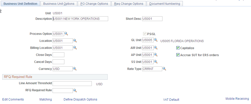

Purchasing Definition - Business Unit Definition Page
Use the Purchasing Definition - Business Unit Definition page (BUS_UNIT_TBL_PM) to create PeopleSoft Purchasing business units or update existing ones.
Navigation:
Set Up Financials/Supply Chain, and then Business Unit Related, and then Purchasing, and then Purchasing Definition, and then Business Unit Definition
This example illustrates the fields and controls on the Business Unit Definition. You can find definitions for the fields and controls later on this page.
When you access this page in Add mode, you can enter only the unit description, default SetID, and short description. Enter this information and click the Create BU (create business unit) button, which appears only in Add mode, to create the business unit. If you access the page in Update/Display mode, the remaining fields on the page become available for entry.
Field or Control Description
Process Option
Select the processing option ID for this business unit to be used throughout the procurement cycle. Values are defined on the Purchasing Options - Purchasing Options page. This defines options such as freight terms and payment terms for the business unit.
Location
Select the location code for the physical location of this business unit. The system uses this code to derive the organization address that prints on dispatched transactions. Define values on the Location - Location Definition page.
Billing Location
Select the code for the location where invoices are sent for this business unit. Define values on the Location - Location Definition page. By default, this information appears on transactions that are created for this business unit.
Close Days and Cancel Days
Enter the number of days that a requisition or purchase order, or a canceled requisition or purchase order, must remain open after its last update activity before it is eligible for closure.
Cancel and close days enable you to delay the closure of requisitions and purchase orders after they are canceled or entirely received. If you are using PeopleSoft Payables, you can also use cancel and close days to delay closure after requisitions or purchase orders are invoiced.
Note: The close days value that you define for the business unit is for purchase order reconciliation and has no relationship to the close days value on the Close Short Run control pages.
PS/GL (PeopleSoft/general ledger)
Select to enable transactions for this business unit to be posted to the general ledger and to link this business unit to a VAT entity. The GL Unit (general ledger unit) field becomes available for entry.
Select a PeopleSoft General Ledger business unit. By default, this business unit appears on transaction distribution lines for this PeopleSoft Purchasing business unit.
If you are linking this PeopleSoft Purchasing business unit to a VAT entity, enter the applicable PeopleSoft General Ledger business unit. You can access this link using the PeopleSoft General Ledger business unit. You cannot directly link a PeopleSoft Purchasing business unit to a VAT entity.
AM Unit (asset management unit)
Select the default PeopleSoft Asset Management business unit for the transactions that this PeopleSoft Purchasing business unit creates. When you create a purchasing transaction, the PeopleSoft Asset Management business unit appears by default if the item is an asset. You can override this information at the transaction level.
Capitalize
Select if most of the asset purchases are capital items.
AP Unit (accounts payable unit)
Select the PeopleSoft Payables business unit that is to be used on evaluated receipt settlement (ERS) purchases.
Accrue SUT for ERS orders (accrue sales and use tax for evaluated receipt settlement orders)
Select if sales and use tax (SUT) should accrue for any ERS orders that this business unit creates.
SS Unit (strategic sourcing unit)
Select the default PeopleSoft Strategic Sourcing (SS) business unit that is to be used for this PeopleSoft Purchasing business unit.
Note: When you enter the same PeopleSoft Strategic Sourcing business unit for multiple PeopleSoft Purchasing business units, PeopleSoft Strategic Sourcing copies requisitions from multiple PeopleSoft Purchasing business units into an event.
Rate Type
Select the rate type to be used for currency conversion. By default, the currency code and rate type apply to all purchasing transactions for this business unit.
Tax supplier
Select to integrate with a third-party tax supplier for tax processing. The system calculates tax from the third-party tax supplier (Vertex or Taxware) when it creates purchase orders online or when sourcing to a purchase order.
When you select this check box, depending on the tax supplier that you select, certain fields appear in the group box below this check box.
Note: This check box is available only if you select a tax supplier (Vertex or Taxware) on the Installation Options - Overall page.
Taxware Group Box
This group box is available only if third-party Taxware or Vertex software is installed, and if the Tax supplier check box is selected.
Company
Enter the tax supplier company code. This field appears for these third-party tax products: Vertex Q Series, Vertex O Series, and Taxware Sales and Use Tax.
The company code that you enter in this field passes information to the third-party Taxware or Vertex software as input parameters.
Organization
Enter the organization. This field appears instead of the Company field for the Taxware Enterprise third-party tax product.
Division
Enter the tax supplier division code. This field appears for these third-party tax products: Vertex Q Series, Vertex O Series, and Taxware Sales and Use Tax.
The division code passes information to the third-party Taxware or Vertex software as input parameters.
Department
Enter the tax supplier department. This field appears only for the Vertex O Series third-party tax product.
The department code passes information to the third-party Taxware or Vertex software as input parameters.
Use Freight Product Code
Select this option to associate the freight with the tax supplier product code and to indicate applicable tax rates.
Note: This field is available only for Taxware.
RFQ Required Rule
Use this group box to define a threshold line amount and RFQ required rule that, when the amount is exceeded or the rule is met, requires a requisition item to go through the RFQ cycle before it is included on a purchase order.
Line Amount Threshold
Enter a threshold amount. The threshold amount is the line amount limit that triggers that an RFQ is required to source the requisition. When a user exceeds the threshold amount for a requisition line, the system resets the RFQ Required check box to be selected for that line on the requisition.
For example, if you are buying something and it costs more than 1000 USD, the system requires that you get a couple of bids before it will source it to the recommended or specified supplier.
RFQ Required Rule (request for quote required rule)
Select an RFQ rule from the rules defined in the RFQ Required Rules component.
Line details
Click the Go To RFQ Required Rule button to access the RFQ Required Rule page, where you can define and view details about the RFQ required rule.
Mobile Receiving
Use this link to access the Mobile Receiving page.
See PeopleSoft Mobile Inventory Management: Mobile Receiving Page.

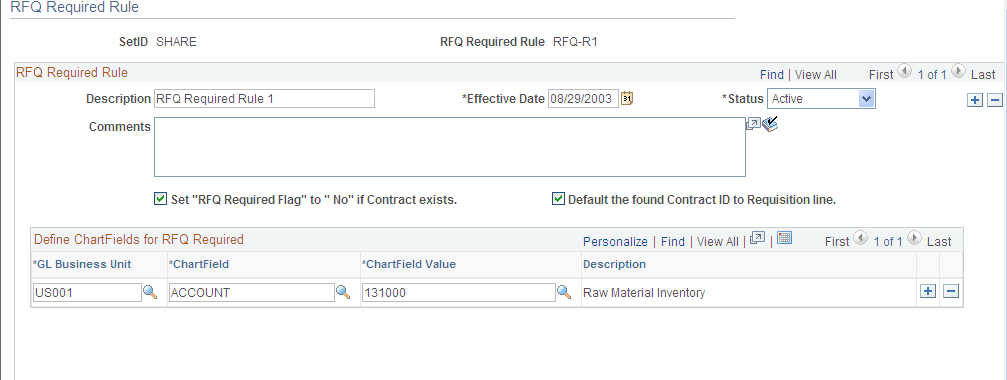

RFQ Required Rule Page
Use the Request For Quote (RFQ) Required Rule page (RFQ_REQUIRED_RULE) to define and view details about the RFQ required rule.
Navigation:
Click the Go To RFQ Required Rule button on the Purchasing Definition - Business Unit Definition page.
This example illustrates the fields and controls on the RFQ Required Rule. You can find definitions for the fields and controls later on this page.
RFQ Required Rule
Use this page to define ChartField values that will set the RFQ Required option to Yes for requisitions created online or through the Requisition Loader process. You can also define the RFQ Required option in the Purchasing Item Attributes or Item Category component when an RFQ is required any time that the item or category is specified on a requisition.
Some organizations require RFQ processing whenever a specific ChartField value is referenced on a requisition. For example, whenever a specified project is entered on a requisition, the funding requirements of the project require that the request go out for bid. The RFQ Required Rule page enables you to define the RFQ Required flag based on that ChartField value. When a requisition is created, the system checks the ChartField values that you define on this page and sets the RFQ Required option accordingly.
Set "RFQ Required Flag" to "No" if Contract exists
Select to bypass the RFQ cycle if a contract exists.
Note: The system ignores the Default Contract on Req check box setting when the system applies the RFQ rule and you select this check box.
Default the found Contract ID to Requisition line
Select to supply by default the contract ID to the requisition line.

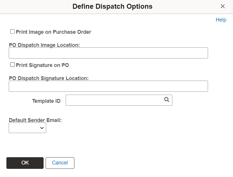

Define Dispatch Options Page
Use the Define Dispatch Options page (BUS_UNIT_PM_IMAGE) to define file directory locations for images that you want to print on purchase orders.
Navigation:
Click the Define Dispatch Options link on the Purchasing Definition - Business Unit Definition page.
This example illustrates the fields and controls on the Define Dispatch Options. You can find definitions for the fields and controls later on this page.
Print Image on Purchase Order and PO Dispatch Image Location
Select to print an image (logo) on purchase orders, and enter the directory location of the image file.
Print Signature on PO and PO Dispatch Signature Location
Select to print a signature on purchase orders, and enter the directory location of the signature file.
Template ID
Select the report template to use with this business unit to dispatch a purchase order. You use the report template to identify a BI Publisher report layout. The template provides a common report layout when dispatching purchase orders for both PeopleSoft eProcurement and Purchasing.
If the Template ID field on this page is blank, then the system uses the default template on the BI Publisher Report Definition page ( Reporting Tools, and then BI Publisher, and then Report Definition, and then Template).
This field appears only if you have selected the Enable XML Publisher check box on the Purchasing page of the Installation Options component. This check box selects the Oracle BI Publisher to format and print purchase orders during the dispatch process for both PeopleSoft Purchasing and PeopleSoft eProcurement. You use Oracle BI Publisher for reporting. It is a Java-based product within the Oracle Fusion Middleware family.
Default Sender Email
For PO dispatch email notification, select a sender email id.
  • Blank: If the blank option is selected, the default sender email is considered from the Application Fundamentals: Installation Options - Purchasing Page.
  • Buyer: Select to send the PO dispatch email from the buyer's email address.
  • Specific: Select to enter an email id to send the PO dispatch email from that specific id.
Note: If Buyer or Specific is selected, it overrides the Default Sender Email configuration on the Application Fundamentals: Installation Options - Purchasing Page.

  3. Verify that the image is not corrupt.
  4. In a UNIX environment, you can print only EPS-FILE image types.
See the product documentation for PeopleTools: BI Publisher for PeopleSoft.

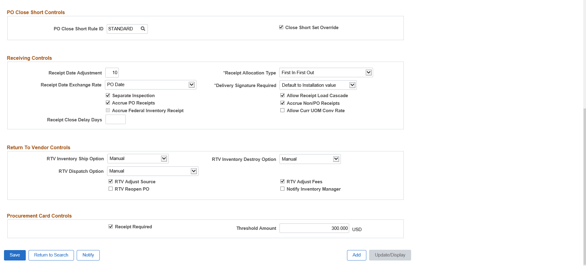

Accrue Federal Inventory Receipt
Select this check box to perform the following actions:
  • Allow receipt accruals for inventory related receipts to be processed.
  • The Purchasing receipt budget checking process will not budget check receipt accruals for inventory.
  • The Accrue Receipts process will mark proprietary accounting entries and reversals for receipt accruals to not be sent to the GL. The proprietary entries can be used by the Entry Event processor to generate budgetary accounting entries and journal generate to GL. However, if the check box is not selected, the Accrue Receipts will not process inventory receipt accruals.
    Note: The Accrue Federal Inventory Receipt check box will be made available, upon selecting the Accrue PO Receipts or Accrue Non/PO Receipt, and also if the Purchasing Entry Event is “Required” or “Optional” on the Installation Options - Entry Event Page .
PO Price Edit
Select the purchase price edit: Values are:
  • Error
  • None
  • Warning
RTV Dispatch Option (return to vendor dispatch option)RTV dispatch option
Select the dispatch method to use as this business unit's default value for the return to vendor (RTV) functionality. This functionality determines the default value for the return to vendor function on how the RTV will be dispatched to the supplier. The system uses the dispatch options that you define for the business unit as default values when user preferences are set by default to the business unit RTV dispatch option. When you save information on this page, the settings you define become effective.
RTV dispatch option values for a business unit are:
Dispatch When Shipped: Select to submit the RTV Dispatch process automatically when all lines on the RTV have been shipped.
Manual: Select to indicate that the RTV transaction requires collaboration between groups and that you must submit the RTV Dispatch/Print process by using the Process Scheduler. This is the default value for the field.
See Entering RTV Transactions.
See Inventory Return Records, Inventory Return Records.
RTV Inventory Ship Option (return to vendor inventory ship option)return to vendor inventory ship option
Select the return to vendor ship option that you want to use as this business unit's default value for the Inventory Process field on the RTV line.
RTV Inventory ship option values are:
Express: Select to use the RTV express option to process purchasing and inventory data collection transactions at the same time. This means that you can perform inventory issue (automatic issue) or adjustment (automatic adjustment) actions from within the Purchasing RTV component.
Note: The Express value will be automatically overridden on the RTV line if the associated Inventory business unit is defined as a Warehouse Management System (WMS) type. You define the warehouse setting using the Use External Warehouse Control check box on the Business Unit Options page for Inventory.
Fulfillment: Select to set the user's preference to perform Inventory fulfillment processing for RTV transactions. This enables the user to create an Inventory material stock request transaction and to process it through Inventory fulfillment processing. The Fulfillment value is valid only for RTV processing when RTV line disposition is Ship.
Manual: Select to indicate that the RTV ship transaction must be completed manually. This option requires that you perform the Inventory Express manually to remove the items from inventory.
RTV Inventory Destroy Option (return to vendor inventory destroy option)return to vendor inventory destroy option
Select the return to the vendor destroy option that you want to use for this business unit's default value for the Inventory Process field on the RTV line.
RTV Inventory destroy option values are:
Express: Select to use the RTV express option for the RTV lines that have a disposition of Destroy. This means that the user can perform Inventory adjustment (automatic adjustment) actions from within the Purchasing RTV component.
Manual: Select to indicate that the RTV transaction must be manually adjusted within inventory. When you use the Manual option, the system does not perform the RTV adjustment function. You must use the Inventory Adjustment component to adjust balances for inventory returns that are to be destroyed.
PO Close Short Rule ID
Select the PO Close Short Rule ID from a prompt list of available Rule IDs. The Rule ID is needed for the close short process to determine a rule to close short the PO The close short will not be processed if the ID is blank.
Delivery Signature Required
Select an option that indicates that a signature is required from the individual receiving a Mobile Inventory delivery for this receiving business unit. Options include:
  • Default to Installation value: Select to indicate that this business unit should use the option selected on the Installation Options - Mobile Inventory page.
  • No: Select to indicate that this business unit does not require delivery signatures.
  • Yes: Select to indicate that this business unit requires delivery signatures.
See smin, Using Mobile Delivery, Processing Deliveries Using Mobile Devices, Adding a Signature to a Delivery
Receipt Close Delay Days
Indicates the minimum number of days that must pass since a receipt was last updated to make it eligible for closing.
Receipt Required
Select the Receipt Required check box to indicate that any transaction line amount greater than the threshold amount will require attachments.
Threshold Amount
Enter the amount limit for a requisition line.
Note: This field becomes editable if you select the Receipt Required check box.

  • Not received/receiving not required but partially vouchered.
  • Not Received/receiving not required and not vouchered.
Sourcing Controls
% Unit Price Tolerance/Tolerance Over (percent unit price tolerance/tolerance over) and % Unit Price Tolerance/Tolerance Under (percent unit price tolerance/tolerance under)
Enter the percentage over and under by which the purchase order price can vary from the requisition price. By default, these values appear on requisitions that are created for this business unit.
When Contract is Specified on Requisition
Allow Req Consolidation
Select to allow requisition consolidation when a contract ID is present on the requisition line.
Allow Source to Inventory
Select to allow inventory sourcing when a contract ID is present on the requisition line.
Item Substitution Controls
Enable Item Substitution
Select this check box to enable item substitution for this Purchasing business unit. If you enable item substitution, you must also select at least one check box in the Allow Item Substitute Online Search or Allow Auto Item Substitution group boxes.
Note: Upon selecting the Enable Item Substitution check box, all the Item Substitute fields will be enabled for entry on the Requisition, Req Selection/Req Expediter, Sourcing Workbench, Purchase Order, and Receipt pages, and on other applicable components for this business unit.
The options in this section allows item user to access online search for item substitutions on the Requisition and/or during Requisition Selection and on the Purchase Order.
Select to enable automatic item substitution on the Requisition, during Requisition Selection, and/or during PO Sourcing and on the Purchase Order.
Liquidate Method
Allow Liquidate by Quantity when Distribute by Quantity
Select to indicate that the purchase order business unit is liquidated by quantity when distributed by quantity. If you do not select this check box, the Comm. Cntrl. Budget Processor process automatically liquidates pre-encumbrance and encumbrance balances by amount only.
The installation must include commitment control to use this option.
Default Liquidate Method
Select a default liquidate method for the purchase order business unit. You can liquidate by quantity or amount.
You must select the Allow Liquidate by Quantity when Distribute by Quantity check box to define a quantity default liquidate method.
Use the Purchasing Definition - Document Numbering page (BUS_UNIT_TBL_PM3) to define transaction document autonumbering options.
Navigation:
Set Up Financials/Supply Chain, and then Business Unit Related, and then Purchasing, and then Purchasing Definition, and then Document Numbering
Select Requisitions, Purchase Orders, Receivers, Requests For Quotes, and Return to Vendors to enable autonumbering for the associated transaction. The last number that was assigned for each transaction appears.
This example illustrates the fields and controls on the Document Numbering. You can find definitions for the fields and controls later on this page.
Document Numbering
Beginning Sequence
To enter the beginning sequence number for the Purchase order, users have to create a valid auto numbering entry.
If the Beginning Sequence is blank the Last Number field in the PO Business Unit will be used in the Auto Numbering routines. If the value has been entered in the Beginning Sequence field, the standard Auto Numbering will be used for the Purchase Orders.
Note: When using the standard Auto Numbering, the default sequence is ignored since the Beginning Sequence value here serves as the default.
Last Number Issued
Displays the Last Number value stored in the Purchasing Business Unit if the Beginning Sequence is blank. If the Beginning Sequence is entered, the value displayed will be from the Auto Numbering Table
