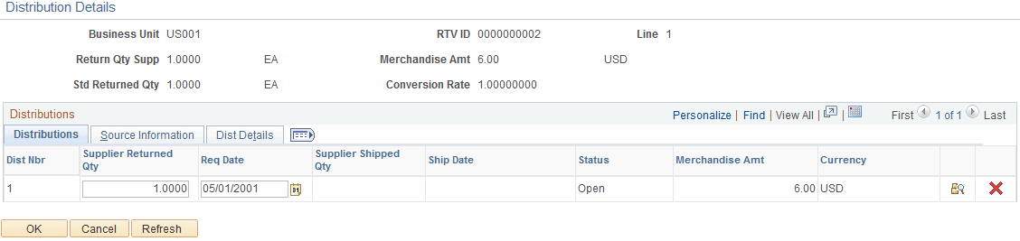

Distribution Details Page
RTV_LN_DISTRIB
Enter distribution information for the item that you want to return.
If there is only one distribution for the selected purchase order or receipt line, the distribution is automatically selected.

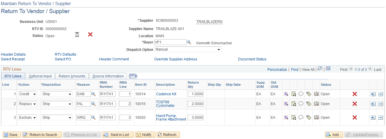

Return To Vendor Page
Use the Return To Vendor page (RTV) to enter RTV information.
Navigation:
Purchasing, and then Return To Vendor, and then Add/Update RTV
This example illustrates the fields and controls on the Return to Vendor page: RTV Lines tab. You can find definitions for the fields and controls later on this page.

Select Receipt Page
Use the Select Receipt page (RTV_PICK_RECV_WRK) to enter search parameters to retrieve receipt lines that you want to transfer to the Return to Vendor page.
If receiving is required, use the Select Receipt page accessed from the Return to Vendor page. Use the Pick Purchase Order page only if receiving is not required for the purchase order.
Navigation:
Click the Select Receipt link on the Return to Vendor page.
Enter criteria that retrieves the receipt lines that contain the items for which you are creating a supplier return. After you enter the selection criteria, click the Search button.
Use the Distribution Details page (RTV_LN_DISTRIB) to enter distribution information for the item that you want to return.
If there is only one distribution for the selected purchase order or receipt line, the distribution is automatically selected. If you are returning a serialized item, the quantity is set to 1 and the quantity field is unavailable for entry.
Navigation:
Click the RTV Details button on the Return to Vendor page.
This example illustrates the fields and controls on the Maintain Return to Vendor - Distribution Details page. You can find definitions for the fields and controls later on this page.

Open: This status appears by default when the supplier return is initiated.
Shipped: When the supplier shipped quantity value equals the return quantity supplier value and you save the page, the distribution line status changes to Shipped.
Closed: The distribution line has been closed by the RTV Reconciliation process.
Cancelled: The distribution line has been canceled. You can change the RTV status to Cancelled until a distribution on the RTV transaction has been shipped.
Amount
Displays the value of the items returned on the distribution line, along with the currency in which it is expressed.
Part of Line Group
Click the Select Source Details button to access the Source Details Information page where you can review RTV information such as the PO and receipt order numbers.
Cancel
Click the Cancel Distribution button to cancel the selected distribution row from the RTV transaction. Canceling an RTV distribution cannot be reversed.
Source Information
Select the Source Information tab.
Information on this tab applies to supplier returns that relate to processing inventory and subcontract data transactions. You can use Purchasing RTV streamline processing where data-collection transactions, such as subcontract completions or negative completions, can be processed at the same time for Purchasing and the Receiving component.
The item ID that the system uses to validated the serial and lot data is the assembly item ID not the item ID from the PO line, receipt line, or RTV line.
Field or Control Description
Storage Location Search
Click the Storage Location Search button to access the Storage Location Search page where you can search for and maintain storage information related to this RTV line. This saves you from having to select each inventory location field individually.
Lot ID
Displays the lot ID for the assembly. When the source for a RTV line is a receipt line that is serial or lot controlled, you must select the appropriate receipt detail that contains the serial or lot ID from the time of receipt. The Lot ID field is also available for lot-controlled items being returned without a source receipt. The lot ID that you select must exist in PeopleSoft Inventory.
Serial ID
Select the serial ID for the assembly. This field is not available for non-serial controlled items. The Serial ID field is also available for serial-controlled items being returned without a source receipt. The serial ID that you select must exist in PeopleSoft Inventory. If you are returning a serialized item, the quantity is set to 1 and the quantity field is unavailable for entry.
IN Unit (Inventory unit)
Identifies the PeopleSoft Inventory business unit for the RTV.
Staged Date
Select the date on which inventory associated with this RTV line was placed in inventory.
Storage Area
Select the Inventory storage area where the inventory associated with this RTV line is located. You can use storage levels one through four for all inventory-related RTV detail rows to specify the picking location.
Lev 1, Lev 2, Lev 3, and Lev 4 (levels 1, 2, 3, and 4)
Select inventory storage levels one through four to define the location of goods associated with this RTV line. These are the picking locations for the item.
Container
Displays the container with which the returned item is associated.
Dist Details
Select the Dist Details (distribution details) tab.
Use this tab to view and define distribution information for the item that you want to return. This information includes, for example, the General Ledger business unit and account, chartfields, category and subcategory, and source type.
See Maintain Purchase Order - Distributions for Schedule Page.
