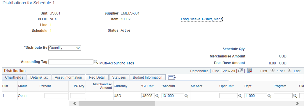

Use the Maintain Purchase Order - Distributions for Schedule page (PO_SCHED_DISTRIB) to define multiple distributions for each purchase order schedule.
Navigation:
Purchasing, and then Purchase Orders, and then Add/Update POs, and then Maintain Purchase Order - Purchase Order
Click the Schedules button on the Maintain Purchase Order - Purchase Order page.
Click the Distributions/ChartFields button from the Maintain Purchase Order - Schedules page.
This example illustrates the fields and controls on the Maintain Purchase Order Distributions for Schedule page. You can find definitions for the fields and controls later on this page.

Field or Control Description
Distribute by
Select the method by which you want to allocate or charge the expense account distribution. Values are:
Amount: Select if the sum of all distribution amounts must equal the schedule amount (merchandise amount). Inventory items cannot be distributed by amount.
Quantity: Select if the sum of all distribution quantities must equal the schedule quantity.
Liquidate by
Liquidate the outstanding pre-encumbrance and encumbrance balances by amount or quantity. This field is only available on schedules that are set to distribute by quantity. Distributions that are set to distribute by amount will always be set to liquidate by amount.
Note: This field is only visible if commitment control is enabled, and you choose the Liquidate by Quantity option on the Purchasing Definition - Business Unit Options page. If commitment controlled is not installed, or you do not choose the option to liquidate by quantity on the purchase order business unit page, the budget processor balance liquidates by amount only.
SpeedChart
If you charge by amount, you can define distributions using speed charts. Speed charts are templates that contain preset distributions. Select a speed chart and accept or override the default values. If a purchase order schedule has already been vouchered, you cannot override the value in this field.
Note: Accounting Tags appear in lieu of Speedcharts when the Accounting Tag check box is selected for Purchasing on the Accounting Tag Registration page. See Application Fundamentals: Setting Up Accounting Tags
Multi-SpeedCharts
Click to access the Multiple SpeedCharts page where you can add, append, and override speed charts for the purchase order schedule.
Accounting Tag
Enter an Accounting Tag that will be used to populate ChartFields on transaction distribution lines. The system automatically prorates the distribution amounts according to the proration percentages defined on the Accounting Tag.
If the purchase order is dispatched or vouchered, you cannot override the value in the Accounting field.
Multi-Accounting Tag
Click to access the Multiple Accounting Tag page where you can append and override accounting tags for the purchase order schedule.
Note: If the purchase order is dispatched or vouchered, the override option will be disabled and the user can only use the append option.

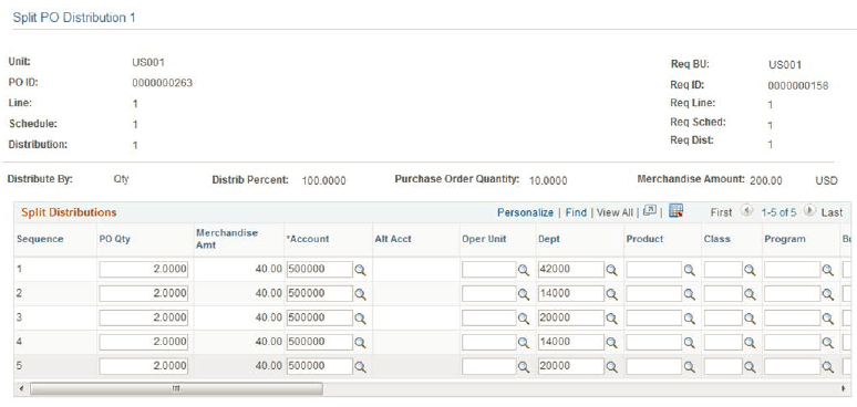

Distribution Worksheet
Click the PO Distribution Worksheet icon to access the PO Distribution Worksheet page, where you can split PO distribution lines and maintain total split quantity to that of original line distribution quantity and add chartfields of your choice.
The distribution lines that are split using PO Distribution Worksheet are available on the PO Distribution page with the same requisition information.

PO Distribution Worksheet Page
Use the PO Distribution Worksheet Page (PO_SPLIT_DIST) to split PO distribution lines and maintain total split quantity to that of original line distribution quantity and add chartfields of your choice.
These split distribution lines are available on the PO Distribution page with the same requisition information.
Navigation:
Click the Distributions/ChartFields button from the Maintain Purchase Order - Schedules page. Click on the PO Distribution worksheet icon on the Req Details Tab.
This example illustrates the fields and controls on the PO Distribution Worksheet Page. You can find definitions for the fields and controls later on this page.
Users can perform several actions like adding, deleting lines and modifying the chartfields.
The Amount field will be enabled only if the distribution method is amount, making the quantity field hidden. If the distribution method is quantity then user can split using quantity and the amount field is grayed out.
The PO Distribution Worksheet functionality is also applicable for the Express PO page and Maintain Distributions page.
