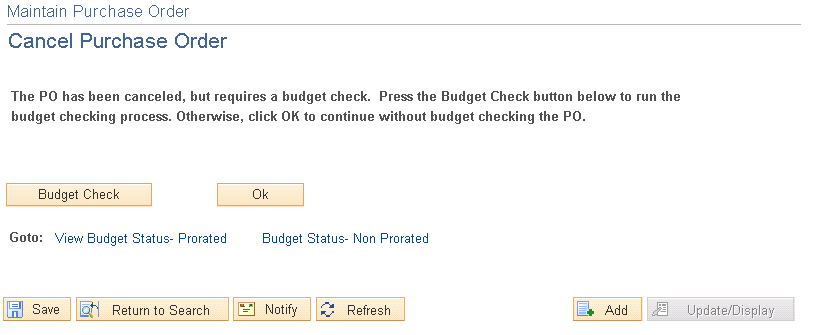

Use the Maintain Purchase Order - Cancel Purchase Order page (PO_BUDG_CHECK) to displays whether a purchase order was successfully canceled and if a purchase order requires budget checking gives you the ability to initiate the budget checking process.
Plus, if the purchase order was previously dispatched this page gives you additional instructions on how to complete the cancel process.

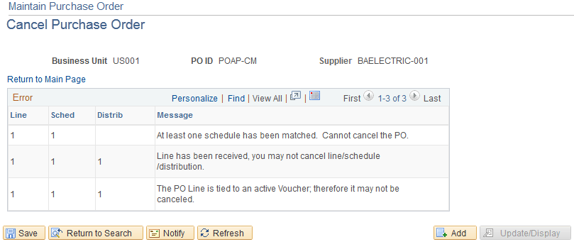

If the system determines a purchase order cannot be canceled, messages will appear on this page giving you the reasons why you cannot cancel a purchase order.

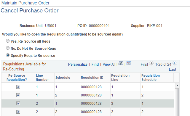

Use the Maintain Purchase Order - Cancel Purchase Order page (PO_CANCEL_RSLT) to make available the requisition quantities that are associated with the purchase order you are canceling so that they can be sourced again at a later date or this page displays the error messages giving you the reasons why the purchase order cannot be canceled.
Navigation:
Click the Cancel PO button on the Maintain Purchase Order - Purchase Order page for a purchase order that has been sourced from a requisition and then click the Yes button when you receive the cancellation confirmation message.
Click the Continue button after selecting the resourcing option for a purchase order that was sourced from a requisition on the Maintain Purchase Order - Cancel Purchase Order page.
This example illustrates the fields and controls on the Maintain Purchase Order - Cancel Purchase Order page. You can find definitions for the fields and controls later on this page.
Field or Control Description
Yes, Re-Source all Req (yes, re-source all requisitions)
Select this option to re-source all requisition quantities associated with the purchase order.
No, Do Not Re-Source Reqs (no, do not re-source requisitions)
Select this option if you do not want to re-source all requisition quantities associated with the purchase order.
Specify Reqs to Re-source (specify requisitions to re-source)
Select this option if you want to specify which requisitions associated with the purchase order that you want to re-source the quantities for. When you select this option the Requisitions Available for Re-Sourcing group box appears displaying all of the requisitions that are associated with the purchase order you are canceling.
Re-Source Requisition?
Select this check box next to each individual requisition and line that you want to re-source.
Continue
Click this button to have the system re-source the requisition quantities and continue on with the cancelation process.
Budget Check
Click this button to run the budget checking process for this purchase order. This button is available if commitment control is enabled for PeopleSoft Purchasing.
Ok
Click this button to continue with the cancelation of the purchase order without budget checking the purchase order.
View Budget Status - Prorated and View Budget Status - NProrated
Click these links to access the Commitment Control page where you can view details about a commitment control transaction, such as the source transaction type and the amount type for the journal. You can also override budget checking for the transaction or run the Comm Cntrl Budget Processor process for the transaction.
