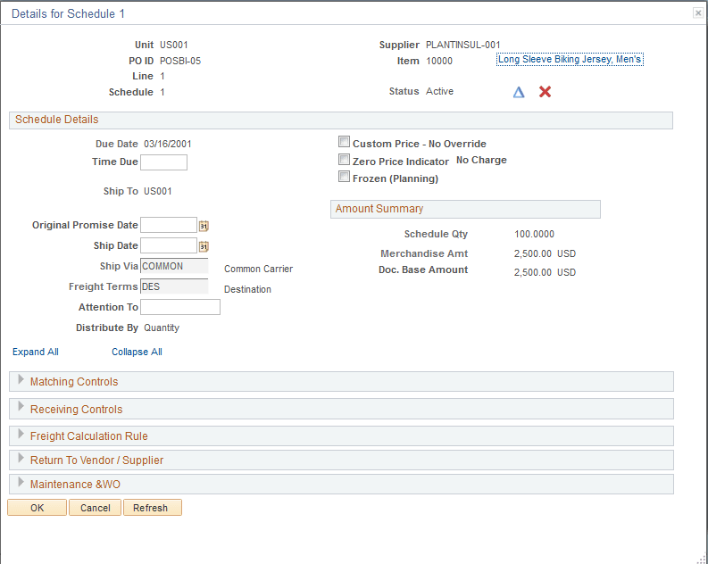

Details for Schedule Page
PO_SCHED_DTLS
Review or add schedule details to the selected schedule line.

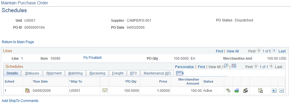

Maintain Purchase Order - Schedules Page
Use the Maintain Purchase Order - Schedules page (PO_SCHEDULE) to specify ship to, quantities, due dates, comments, SUT, miscellaneous charges, price adjustments, and multiple distributions per schedule within a purchase order line.
Navigation:
Purchasing, and then Purchase Orders, and then Add/Update POs, and then Maintain Purchase Order - Purchase Order
Click the Schedule button next to a purchase order line on the Maintain Purchase Order - Purchase Order page.
This example illustrates the fields and controls on the Maintain Purchase Orders - Schedules page. You can find definitions for the fields and controls later on this page.
The Schedules page displays header information for the purchase order, such as the purchase order ID, date, and status. The page also displays schedule details for purchase order lines. The Lines group box provides basic information about individual lines and the Schedules grid box provides detailed schedule information.

Use the Schedules grid box to view and maintain a variety of schedule information for purchase order lines that appear in the grid box. The Details tab enables you to define basic schedule information for the purchase order line.
Field or Control Description
Sched (schedule)
Displays the schedule number used by the system to track multiple schedules for a purchase order line. The system automatically assigns the number.
Line details
Click the Details button to access the Details page where you can view or maintain schedule details.
See Details for Schedule Page.
Due Date
Displays the default due date for the schedule. If there is no default due date, the system calculates one by adding the lead-time days to the purchase order date. You can override the due date for each schedule as long as it is not earlier than the purchase order date.
If the item is an inventory item and an Inventory business unit is entered on the first distribution line of the schedule on the Distribution Details page, the due date is validated against the closure calendar definition for the PeopleSoft Inventory business unit. This ensures that the business unit is open to receive merchandise on that day. If the date is not a valid date for that business unit, the system issues a warning for you to accept the date anyway or use the next available date.
If the item is not an inventory item, the shipping due date is validated against the closure calendar definition for the PeopleSoft Purchasing business unit.
When you create a change order by adding a line to the purchase order on a purchase order that has a due date in the past, the system will populate the due date for the new line with the current date plus lead time days, if a lead time exists for the category. Otherwise, the current date will appear in the Due Date field.
When the purchase order is created using the copy from purchase order method, the due date is calculated again. If the resulting calculated date is greater than the due date copied from the copied purchase order, then the calculated date is set as the due date for the new purchase order. If the calculated date is less than the copied due date, the copied due date is retained as the due date in the new purchase order.
Direct Shipment
Click the Schedule Direct Shipment button to access the Direct Shipment page. Use the Direct Shipment page to view PeopleSoft Order Management sales order information related to the direct shipment.
Ship To
Ship to destination. A change to the ship to can result in a price change, a sales and use tax recalculation, or a VAT recalculation.
Ship To GLM (ship to global location number)
Displays the global location number for the corresponding ship to location, if available.
Ship to Address
Click the Ship To Address button to access the PO ShipTo Address page. Use this page to set up a one-time ship to address for the selected purchase order schedule.
Note: You cannot define a one-time address for direct shipment purchase orders. To change the address for a direct shipment you must go to the sales order in PeopleSoft Order Management and make the address change there.
PO Quantity
The purchase order quantity for the first schedule automatically changes to the entire line quantity. You can override the quantity with a lower number and insert a second schedule for the difference.
The purchase order quantity for the second schedule automatically changes to the difference between the line quantity and the quantity on the first schedule.
If you update the line quantity and have only one schedule, the system updates the schedule automatically. If you have multiple schedules, you must update the schedules manually so that the total schedule quantity equals the line quantity.
Changing the schedule quantity never updates the line quantity. This field is not available for entry for amount only lines.
When you change the purchase order quantity or amount by changing the price, the system verifies the distribution method and liquidation methods. If the distribution method is Amount or if the method is Quantity and the liquidation method is Amount, the system does not allow the quantity or amount to be reduced to less than the quantity or amount vouchered. Also when you change the price, the system does not allow you to make changes when there are vouchers matched to the line or schedule. The system provides a message that you should unpost and unmatch the voucher before it allows the change.
Price
The system calculates the price for the items.
Price calculations can range from simple to complex, depending on the factors you set up.
If there is a contract associated with the line, the system uses the contract rules to determine the price. Contract rules include whether to use the contract base price or the supplier price for the unit of measure on the purchase order. Contract rules also determine which sets of price adjustments the system considers (contract price adjustments and supplier base price adjustments) and in what order.
If you are ordering items by description only, you must enter the price manually. While price is not required, if you have entered schedules without prices, you'll get a warning when you save the purchase order.
This field is not available if the purchase order is used with a recurring purchase order voucher.
Amount
The system calculates the extended amount as the schedule price multiplied by the schedule quantity. This is the merchandise amount of the schedule. It does not include other amounts associated with the schedule, such as freight and tax.
You can override the schedule merchandise amount here, unless the item definition or contract definition for the item on the line does not allow the price to be changed on the purchase order.
Status
Displays the status of the purchase order line schedule.
Value Adjustment
Click the Value Adjustment button to access the Price Adjustments page.
See Price Adjustments for Schedule Page.
Miscellaneous charges
Click the Miscellaneous Charges button to access the Miscellaneous Charges page where you can view and update price information.
See Miscellaneous Charges for Schedule Page.
Sched Sales/Use Tax
Click the Sched Sales/Use Tax button to access the Sales/Use Tax Information page.
See Sales/Use Tax Information for Schedule Page, Sales/Use Tax Information for Schedule Page.
Distribution Button
Click the Distributions/ChartFields button to access the Distributions page.
See Creating Purchase Order Distributions.

Time Due
Displays the time that the shipment is due.
Original Promise Date
Displays the date on which the supplier originally committed to deliver the item. The default due date appears by default in this field and is updated when the item or item category (ad hoc items) changes. If you override the due date on the PO Defaults page, the purchase order date plus the number of lead time days defined for the item or item category (ad hoc items) will be used, not the overridden due date. You can override the original promise date on the PO Defaults page.
Ship Date
Displays the actual date on which the line item was shipped by the supplier.
Custom Price
Select this check box to indicate that you entered a custom price on the schedule.
Zero Price
Select to indicate that the price for this item is zero.
Frozen (Planning)
Select to prevent PeopleSoft Supply Planning from changing the schedule. The two schedule changes that PeopleSoft Supply Planning can recommend include rescheduling the due date to ensure supply is on hand for a particular demand and canceling the schedule if demand does not exist.
Ship Via

Close Under Quantity Percent
Enter the percentage that represents the under quantity tolerance for receiving this purchase order line. The percentage entered here is then used by PO close in determining if the PO line is eligible for closing.
Freight
Use the Freight tab to view and update information about freight terms for this schedule.
Freight Terms
Displays the freight term code that applies to the schedules for this purchase order. You define the code for SetIDs on the Purchasing Options page.
Arbitration
Displays the freight and transportation arbitration plan for this business unit.
Charge Method
Displays the method by which freight is charged for the purchase order. This value can be overridden for the schedule on the Details for Schedule page. Values are:
Volume: Freight is charged by the volume of the shipped item.
Quantity: Freight is charged by the number of packages.
Value: Freight is charged by the value of the order.
Weight: Freight is charged by the weight of the items.
Freight Charge Override
Select this check box to override the freight charge set on the Purchase Order Defaults page with the values entered on this page.
RTV
Use the RTV (return to vendor) tab to define exchange returns to vendors associated with this purchase order line schedule. By assigning the RTV information, the PO schedule is identified as the order of the item being exchanged for the item on the return to vendor. A return to vendor for exchange will not be eligible for closing until the exchange item is identified on a PO schedule.
When the due date is changed for a fully-received schedule, the system checks for any supplier returns for that schedule. If there is a return to vendor, the system prevents you from changing the date.
BU RTV (business unit return to vendor)
Select a business unit to which the supplier return is going to be assigned.
RTV ID (return to vendor ID)
Select a RTV ID. You must first specify a business unit before you can select a RTV ID.
RTV Line (return to vendor line)
Select a RTV line. The available selections are based on the RTV ID that you enter.
Maintenance WO
Use the Maintenance WO (maintenance work order) tab to define information work order details.
This will not appear on this page if PeopleSoft Maintenance Management is not installed.
If the purchase order was created through the PeopleSoft Purchasing sourcing processes the work order information fields on this page will already be populated with the values that came through the sourcing processes. If work order information does not already exist you can manually associate the work order information with the purchase order using the fields on this page. This page is used to associate non-inventory and ad hoc (description-only) items to purchase order schedules with a work order. If work order information is specified, then all distributions are associated with the work order specified. Use the Pegging Workbench to associate inventory items to a work order.
When you associate a work order with a purchase order the system will copy the distributions from the work order parts template, including distribute by method, distribution percentage, general ledger business unit, ChartFields, and projects information.
Maintenance WO Unit (PeopleSoft Maintenance Management work order business unit)
Select the PeopleSoft Maintenance Management business unit.
Select the work order you want to associate with this purchase order.
Task Number
Select the work order task number.
Resource Type
Select the type of resource you are defining a purchase order for. Values are:
  • Labor.
  • Material.
  • Tools.
Resource Line No. (Resource line number)
Select the resource line number associated with the work order, work order task, resource type entered. If the ad hoc (description only) item on the purchase order line doesn't exist on the work order, you can leave the resource line blank. At save, the system will add the ad hoc (description only) item to the work order task.
Custom Fields
The user definable fields in this Custom Fields section are available when you check the Enable Custom Fields checkbox on the Purchasing Installation Options page. You can customize these fields for your use. The custom fields are informational only. .
For more information on Custom Fields SeeUnderstanding User-Definable Fields
Schedule Date
Displays the schedule date for the Maintenance Work Order This field is only displayed in update and display mode, and not visible in Add mode.
Amount
Displays the total amount for the Maintenance Work Order This field is only displayed in update and display mode, and not visible in Add mode.
Currency
Displays the currency for the Maintenance Work Order This field is only displayed in update and display mode, and not visible in Add mode.
The Schedule Date, Amount, and Currency fields are display fields from the WO schedule and not from the Purchase Order schedule details. If the Amount Only check box is selected for purchase order line and purchase order line is associated to Amount Only Work Order Schedule, only then the Schedule Date, Amount, Currency fields are displayed.
Changing Work Order Information
If the purchase order distributions are associated with a requisition, you must clear the requisition before you can change the work order information. Also, if the work order is associated with the purchase order schedule (non-inventory and ad hoc (description-only) lines), when you make a change to the purchase order and reopen the quantity back on the requisition, the system will reopen the requisition pegs to the work order. Changes that can cause this behavior are reducing quantity, canceling a distribution, and deleting a distribution. If the purchase order is for an inventory item, reopening the requisition quantity does not reopen the pegs. You must manually redo the pegging.
Use the Details for Schedule page (PO_SCHED_DTLS) to review or add schedule details to the selected schedule line.
Navigation:
Click the Schedule Details button on the Maintain Purchase Orders - Schedule page.
This example illustrates the fields and controls on the Details for Schedule page. You can find definitions for the fields and controls later on this page.
Status
Purchase order schedule status. Values are: Active, Canceled, or Closed.
Schedule Details
Custom Price - No Override
Select this check box to indicate that you entered a custom price on the schedule. When the system needs to recalculate a price, it prompts you for approval before automatically recalculating the price.
If you do not select this check box, but change the price on the schedule, the system selects it for you.
Zero Price Indicator No Charge
Select this check box to indicate that this is a zero-priced line and is considered a no charge item.
Frozen (Planning)
If selected, prevents PeopleSoft Supply Planning from changing the schedule. The two schedule changes PeopleSoft Supply Planning is allowed to recommend include:
  • Rescheduling the due date to ensure supply is on hand for a particular demand.
  • Canceling the schedule if no demand exists.
Ship To Location
Displays the ship to destination selected for the purchase order.
Ship to GLN
Note: If the associated item has a preferred ship to location, the system displays the global location number for that preferred location.
Displays the supplier's original promised delivery date. Use this field to track when the supplier promised delivery against the date that the goods were actually received.
Alternatively, you can use the due date on the schedule as the date against which to compare the receipt date for supplier performance tracking.
Doc. Base Amount (document base amount)
Displays the document base amount. This is the Amount value converted to the base currency of the purchase order. The base currency is the currency of the PeopleSoft General Ledger business unit for this PeopleSoft Purchasing business unit.
Matching Controls
Matching
Select the matching method for the schedule. Values are ERS, Full Match, and No Match.
Match Status PO
Displays the match status of the schedule. Values are To Match, Part Matched, Fully Matched, and Unmatched. These are set based on the extent to which the matching process has been completed for the schedule.
The system updates the match status, both from the matching process and from online purchase order maintenance. Online purchase order activity affects the match status if a schedule has already been fully matched and you increase the quantity. In that case, the system resets the match status to reflect a partial match.
Matching Tolerance
When you use matching to verify supplier charges, the system uses price tolerances to determine whether the purchase order and voucher prices are within the tolerances and thus whether the purchase order and purchase order voucher match.
If you leave any of the tolerance fields set to zero or blank, the system interprets this to mean a zero tolerance.
If you don't want to use the tolerance fields, set the amount fields to 99999999.99999 and the percentage fields to 100%.
If you match vouchers against amount-only purchase order lines, multiple vouchers are likely to exist for the same purchase order schedule line. In this case, the under tolerance matching tolerances should not apply. To prevent under tolerance matching exceptions for non-received amount only lines you can do one of these options:
  • Enter 99999999.99999 in the under tolerance fields for matching to a purchase order.
  • Use Accounts Payable matching rules.
    You can specify multiple matching rules on a purchase order, and on those rules, you can choose to use purchase order tolerances or not. You can modify existing delivered rules (by changing the SQL), or create your own rules that eliminate checking the purchase order lower tolerance percentages for amount only purchase order lines.
    See PeopleSoft Source to Settle Common Information: Establishing Matching and Document Association Options.
Unit Price Tolerance Over/Tolerance Under
Amount over and under the individual item price that you plan to allow on the voucher and still have the transaction qualify for a match.
% Unit Price Tolerance Over/Tolerance Under
Percent over and under the individual price that you plan to allow on the voucher and still have the transaction qualify for a match.
Ext Price Tolerance Over/Tolerance Under (extended price tolerance over/tolerance under)
Amount over and under the extended item price (price multiplied by quantity) that you plan to allow on the voucher and still have the transaction qualify for a match.
% Ext Price Tolerance Over/Tolerance Under
Percent over and under the extended item price (price multiplied by quantity) that you plan to allow on the voucher and still have the transaction qualify for a match.
Receiving Controls
Reject Qty Over Tolerance (reject quantity over tolerance)
Select this check box to reject a shipment at receiving time if the quantity received is over the tolerance set in the Qty Rcvd Tolerance % (quantity received tolerance percentage) field.
Early Ship Rjct Days (early shipment reject days)
If you want to reject goods that arrive too early, enter the number of days early a shipment needs to be to qualify for rejection. For example, enter 3 to reject shipments automatically that arrive three or more days early.
Qty Recv Tolerance % (quantity received tolerance percentage)
Displays the quantity received tolerance percentage for the item on the purchase order. This field appears by default from the supplier's UOM and Pricing Info page.
Freight Calculation Rule
Displays the PeopleSoft Maintenance Management work order information that you previously entered on the Maintain Purchase Order - Schedules page. The Schedule Date, Amount, and currency fields are display fields from the WO schedule and not from the Purchase Order schedule details. If the Amount Only check box is selected for Purchase Order Line and Purchase Order Line is associated to Amount Only Work Order Schedule, only then the Schedule Date, Amount, Currency fields are displayed.
You can change the work order information field values on this page and the changed values will be reflected on the Maintain Purchase Order - Schedules page.
The Maintenance WO section will not appear on this page if PeopleSoft Maintenance Management is not installed.
See Maintain Purchase Order - Schedules Page.
