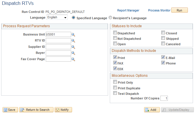

Dispatch RTVs Page
Use the Dispatch RTVs page (RUN_PO_RTVDISP) to set the parameters for and run these three processes: RTV Dispatch/Print, Email, RTV Dispatch & Email multiprocess job.
Also produce the RTV Dispatch/Print report, which provides a printout of selected RTVs.
Navigation:
This example illustrates the fields and controls on the Dispatch RTVs page. You can find definitions for the fields and controls later on this page.
Process Request Parameters
| Field or Control | Description |
Business Unit |
Select a business unit as part of the selection criteria. |
RTV ID |
Select an RTV ID as part of the selection criteria. You must specify a business unit before you can enter an RTV ID. When you select a specific RTV ID, only the business unit and RTV ID are used as the selection criteria. |
Supplier ID |
Select a supplier ID as part of the selection criteria. |
Buyer |
Select a buyer as part of the selection criteria. |
Fax Cover Page |
Select a fax cover page, if some of the supplier returns that you are dispatching are to be sent by fax. The fax cover letters are defined on the Fax Cover Letters page. The RTV Dispatch/Print process writes (to the fax control file) the file name associated with the selected cover page combined with the cover page file extension that you defined on the Dispatch Configuration page. |
Statuses to Include
Dispatched |
Select this check box to include previously dispatched supplier returns. Records with RTV_HDR.DISPATCH_FLAG = Y are included. |
Not Dispatched |
Select this check box to include supplier returns that have never been dispatched. Records with RTV_HDR.DISPATCH_FLAG = N are included. |
Open, Closed, Shipped, and Canceled |
Select the specific check box to include supplier returns with the selected statuses. |
Dispatch Methods to Include
Print, Fax, EDX (electronic data exchange), E-Mail, and Phone |
Select the specific check box to include supplier returns with the selected dispatch methods. |
Miscellaneous Options
Print Only |
Select this check box to print only and not dispatch the RTV transaction. |
Print Duplicate |
Select this check box to print only and not dispatch the supplier return. The printed RTV document will have the word Duplicate printed on it. The RTV transaction must have been previously dispatched. |
Test Dispatch |
Select this check box to perform a test run of the dispatch. When you select this check box, the process runs, but the supplier returns are not dispatched and are not set to a dispatched status. The printed RTV document has the word Unauthorized printed on it. This enables you to test the EDX, email, or fax setup without actually dispatching or updating the system. |
Number of Copies |
Enter the number of copies that you want the process to print. |
