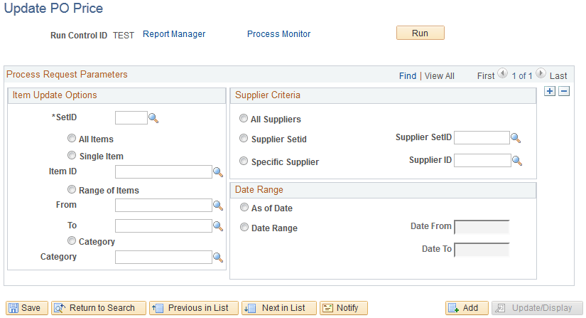

Update PO Price Page
Use the Update PO Price page (RUN_PO_PRICE_UPD) to run the Price Update application engine process (PO_PRICE_UPD) to scan the Item/supplier UOM tables to locate item/supplier prices that have become effective and calculate the item's new standard price or business unit standard price based on the item/supplier UOM price.
Navigation:
Items, and then Define Items and Attributes, and then Update PO Price
This example illustrates the fields and controls on the Update PO Price page. You can find definitions for the fields and controls later on this page.
You can use the filter controls on this page to limit the prices to be updated.
Date Range
Field or Control Description
As of Date
Select to process prices that are currently effective.
Date Range
Select to process prices that are in effect within the range that you specify in the Date From/Date To fields.
