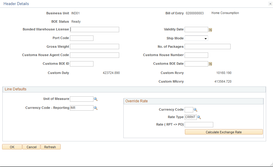

Header Details Page
BOE_HDR
Access BOE header details.

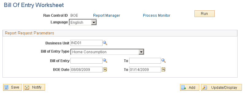

Bill of Entry Worksheet Page
RUN_POY5070
Enter parameters for the Bill of Entry Worksheet process (POX5070) and run the process.

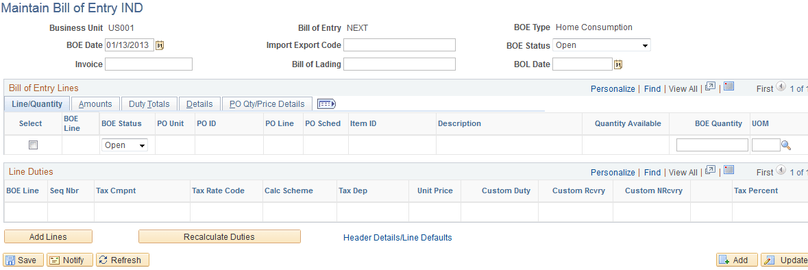

Maintain Bill of Entry IND Page
Use the Maintain Bill of Entry IND page (BILL_OF_ENTRY) to enter BOEs.
Navigation:
Purchasing, and then Receipts, and then Maintain Bill of Entry IND
This example illustrates the fields and controls on the Maintain Bill of Entry IND page. You can find definitions for the fields and controls later on this page.
You can create a BOE for a single purchase order, multiple purchase orders, or a portion of a purchase order. BOEs are associated with a purchasing business unit.

Bill of Entry Lines
Use the Bill of Entry Lines scroll area to access and enter BOE line details.
Line/Quantity Tab

Header Details/Line Defaults
Click this link to access the Header Details page, where you can access BOE header details.

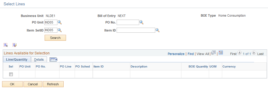

Select Lines Page
Use the Select Lines page (BOE_SELECT) to select source rows to add to a BOE.
Navigation:
Click the Add Lines button on the Maintain Bill of Entry IND page.
This example illustrates the fields and controls on the Select Lines page. You can find definitions for the fields and controls later on this page.
Select Lines page
Available fields on this page appear based on the BOE Type field value.
Field or Control Description
Business Unit
Displays the PeopleSoft Purchasing business unit for the BOE. This is the business unit that initiated the purchase of the customs duty-applicable goods for which you are creating the BOE.
Bill of Entry
Displays the system-generated BOE reference number.
BOE Type
Displays the BOE type. Values are:
Home Consumption: Select to designate that the goods are to be transferred from customs authorities directly to your inventory warehouse for consumption.
Warehousing: Select to designate that the goods are to be transferred from customs authorities to a bonded customs warehouse for storage until you need to consume them. These goods are to be received in your system using an inventory business unit representing the bonded warehouse. When you are ready to consume the goods, you create an ex-bonded BOE worksheet and do an interunit transfer to move the goods from the customs bonded warehouse to the inventory warehouse.
If Home Consumption or Warehousing is selected, the system populates the Lines Available for Selection scroll area with purchase order schedules that meet the selection criteria and the following requirements when you click the Search button:
  • Purchase order schedule direct import tax transaction type: DIMP
  • Purchase order schedule: The schedule is not already fulfilled on a BOE.
The BOE quantity that appears is the purchase order schedule quantity less the sum of the BOE quantities for all BOEs for the purchase order schedule that have a BOE type of Home Consumption or Warehousing.
You can select one or more rows to copy to the BOE. After you select source rows and click OK, information from the source purchase order schedules is copied to the new BOE line and BOE line duty records.
The Customs Duty calculation routine is triggered to calculate duties based on the quantity that appears by default to the BOE lines.
Ex-Bond: Select to designate that goods are being moved from a bonded customs warehouse to the inventory warehouse for consumption.
If selected, the system populates the Lines Available for Selection scroll area with BOE lines that meet the selection criteria and the following requirements when you click the Search button:
  • BOE type: Warehousing.
  • Exemption ID: clear.
  • BOE status: Closed.
  • BOE quantity: The BOE quantity has not been fulfilled by another BOE with a BOE type of Ex-Bond.
    The BOE quantity that appears for the row is the BOE quantity from the warehousing BOE line less the sum of the BOE quantity for any existing ex-bond BOE lines for the corresponding warehousing BOE line.
You can select one or more rows to copy to the ex-bond BOE.
After you select source rows and click OK, information from the source warehousing BOE is copied to the new ex-bond BOE line and BOE line duty records.
The customs duty calculation routine is triggered to calculate duties based on the quantity that appears by default to the ex-bonded lines.
Bill of Lading
This field appears when the BOE Type field is set to Ex-Bond.
BU From (from business unit)
This field appears when the BOE Type field is set to Ex-Bond. This is the business unit representing the bonded customs warehouse from which the goods are being transferred to the ex-bonded warehouse.
BOE Ref ID (BOE reference ID)
This field appears when the BOE Type field is set to Ex-Bond. This is the warehousing BOE used as the source transaction for the ex-bonded BOE.
License
This field appears when the BOE Type field is set to Ex-Bond. This is the license assigned to the bonded customs warehouse that stored the ex-bonded goods.
Item SetID
Enter the item SetID for which you want to return applicable transaction lines.
Item ID
Enter the item for which you want to return applicable transaction lines.
Exempt ID
This field appears when the BOE Type field is set to Ex-Bond. This is the exemption ID on the source BOE line.
Search
Select to display qualifying BOE source lines in the Lines Available for Selection scroll area.
Line/Quantity
BOE Ref Line
This field appears when the BOE Type field is set to Ex-Bond. This is the warehousing BOE line used as the source transaction for the ex-bonded BOE.
BOE Quantity
Quantity to assign to the BOE expressed in unit of measure entered in the UOM field. This is the purchase order quantity, which may have been converted if the UOM field value is different from the purchase order unit of measure. You can modify this quantity on the BOE; however, the quantity can never exceed the purchase order quantity available to be associated with a BOE.
UOM (unit of measure)
The default value is the value entered on the Bill of Entry - Header Details page. If you do not enter a value on that page, this value is set to the purchase order quantity unit of measure. You can modify this value on the BOE.
Amount
This field appears when the BOE Type field is set to Ex-Bond. This is the merchandise amount from the source BOE line.
Currency
The default value is the reporting currency defined on the Bill of Entry - Header Details page. If you do not enter a value on that page, this value is set to the purchase order currency.
This currency must be the same currency defined in the miscellaneous charge setup for the selected item. The system issues an error for rows for which the currency codes do not match, because it is unable to calculate customs duty amounts. Use the currency override on the Bill of Entry - Header Details page to set the reporting currency to the correct value.
OK
Click to copy selected lines to the BOE worksheet.
Header Details Page
Use the Header Details page (BOE_HDR ) to access BOE header details.
Navigation:
Click the Header Details/ Line Defaults link on the Maintain Bill of Entry IND page.
This example illustrates the fields and controls on the Header Details page. You can find definitions for the fields and controls later on this page.
Header Details page
Default values, such as those available for entry on this page are used only when inserting new rows and are not used for overriding values on existing rows. For example, suppose that you change the rate value (RT_RATE) on this page and there are existing BOE_LN records, the rate values on those existing BOE_LN records are not overridden. However, new BOE_LN records inserted after you change the rate value receive the new rate value.
Amount fields appear in the reporting, or local currency.
Bill of Entry
Displays the BOE ID and type.
BOE Status
Displays the BOE header status.
Bonded Warehouse License
This field is available for entry for warehousing BOEs.
Validity Date
Port Code
Enter an applicable port code. This value is stored for informational purposes.
Ship Mode
Select the applicable mode of shipment. This value is stored for informational purposes. Values are:
Air
Land
Sea
Gross Weight
Enter the gross weight of the shipment. This value is stored for informational purposes.
No. of Packages (number of packages)
Enter the number of packages included in the shipment of goods on the BOE. This value is stored for informational purposes.
Customs House Agent Code
Following BOE assessment, enter the code for the customs agent responsible for the BOE assessment.
Customs House Number
Following BOE assessment, enter the number for the customs house responsible for the BOE assessment.
Customs BOE ID
Following BOE assessment, enter a BOE reference number issued by customs authorities.
Customs BOE Date
Following BOE assessment, enter a BOE assessment date issued by customs authorities.
Custom Duty
Reflects the sum of corresponding amounts on BOE lines.
Custom Rcvry (customs recovery)
Custom NRcvry (customs nonrecovery)
Line Defaults
The Line Defaults group box does not appear for ex-bonded BOEs. In this case, you can perform necessary overrides at the line level.
Unit of Measure
Enter a unit of measure to be used as a line default line value for new rows that you insert. This value does not override the default unit of measure for existing lines.
Currency Code - Reporting
This field appears by default from the currency code assigned to the selected tax location.
Override Rate
Currency Code
Enter a currency code to override the default reporting currency code on new rows that you insert.
Rate (RPT => PO))
Exchange rate between the default reporting currency code and the override currency code that you enter using the selected rate type. Click the Calculate Exchange Rate button to have the system calculate the rate for you.
This rate is to be used as a line default line value for new rows that you insert. This value does not override the default rate for existing lines.
Rate Type
Rate type to use to calculate the exchange rate between the default reporting currency code and the override currency code that you have entered.
This rate type is to be used as a line default line value for new rows that you insert. This value does not override the default rate type on existing lines.
Click to calculate the exchange rate between the default reporting currency code and the override currency code that you have entered.
Use the Bill of Entry Worksheet page (RUN_POY5070) to enter parameters for the Bill of Entry Worksheet process (POY5070) and run the process.
Navigation:
Purchasing, and then Receipts, and then Reports, and then Bill of Entry Worksheet
This example illustrates the fields and controls on the Bill of Entry Worksheet page. You can find definitions for the fields and controls later on this page.
Business Unit
Enter the purchasing business unit for which you want to print BOE worksheets. To print BOE worksheets for all business units, do not enter a value.
Bill of Entry Type
Select the type of BOE worksheets that you want to print. To print BOE worksheets for all types, do not select a value. Values are:
Ex-Bond
Home Consumption
Warehousing
Bill of Entry/To
Enter the range of BOE numbers that you want to print. Only BOEs in Ready status are available for selection.
BOE Date/To
Enter the date range for the BOEs that you want to print. The system prints BOEs in Ready status that have BOE dates that meet the date range criteria.
Bill of Entry Page
Use the Bill of Entry page (Purchasing, Receipts, Maintain Bill of Entry IND).
You update a BOE worksheet in the system after it has been assessed by customs authorities. The custom authorities for the imported goods return the BOE to you (the importer) for confirmation of the assessable value and customs duty amounts assigned.
You make updates to BOEs in Ready status according to the assessment by customs authorities with the intention of changing the status to Assessed. As you update each BOE line, you change the line status to Assessed, which indicates that information on the BOE line is correct and final. You can change the BOE header status to Assessed after each line is in Assessed status.
Common updates resulting from customs authority assessment of BOEs include the application of the following:
  • A different exchange rate, which affects the assessable value of goods.
  • A different customs duty rate.
  • An additional customs duty.
