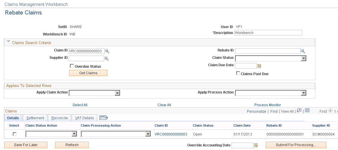

Use the Claims Management Workbench - Rebate Claims page (VRBT_CLAIM_WB) to maintain vendor rebate claims.
Navigation:
Purchasing, and then Vendor Rebates, and then Vendor Rebate Claims, and then Claims Management Workbench
This example illustrates the fields and controls on the Claims Management Workbench - Rebate Claims page. You can find definitions for the fields and controls later on this page.
Before you access this page, enter the workbench ID in the Claims Management Workbench dialog box.
Field or Control Description
Description
Enter a description for the Claims Management Workbench.
Claims Search Criteria
Overdue Status
Select this check box if you want to work with claims that are overdue. The Overdue Status check box is selected on the claim.
Claim Due Date
Select a claim due date. The system displays all claims for which the claim due date is prior to or equal to the date that is specified.
Claims Past Due
Select this check box if you want to work with claims that are past due. The system looks at the claim due date that is entered to determine what is past due.
Get Claims
After you select the claim search criteria, click this button to have the system display in the Claims group box all of the claims that match the search criteria that is selected.
Applies To Selected Rows
Apply Claim Action
Select the claim action that you want to apply to all the claim rows that you select in the Claims group box. Claim actions are:
  • Approve: Enables the rebate manager to change the claim ID from an Open claim status to an Approved claim status.
  • Cancel: Enables the rebate manager to change the claim ID from an Open, Approved, or Deferred claim status to a Cancel claim status only if the claim is not included in a new claim ID (the Defer Claim field is clear).
  • Defer: Enables the rebate manager to change the claim ID from an Open or Approved claim status to a Deferred claim status.
  • Unapprove: Enables the rebate manager to change the claim ID from an Approved claim status to an Open claim status.
Using this field, you can apply the claim action that you select to multiple claims. To apply a claim action to an individual claim row, select the claim action using the Claim Status Action field in the Claims group box.
Apply Process Action
Select the process action that you want to apply to all the claim rows that you select in the Claims group box. Process actions are:
  • Cancel Deduction: The system initiates the Process Supplier Claims process that then initiates the Claim Cancel Deduction process. This process reverses the adjustment vouchers that were previously sent to PeopleSoft Payables as overdue, and then it regenerates the pending items to send back to PeopleSoft Receivables.
  • Claim Settlement: The system initiates the Process Supplier Claims process that then initiates the Claim Settlement for AP process and the Claim Settlement for AR process. These processes send expected payment from the supplier to PeopleSoft Payables in the form of an adjustment voucher if the settlement method in the vendor rebate agreement is Adjustment Voucher or to PeopleSoft Receivables as a pending item if the settlement method in the vendor rebate agreement is Check, Credit Memo, Direct Debit, Draft, or Electronic Funds Transfer (EFT).
  • Overdue: The system initiates the Process Supplier Claims process that then initiates the Claim Overdue Deduction process. This process reverses the pending items that were previously sent to PeopleSoft Receivables, and then it generates adjustment vouchers to send to PeopleSoft Payables.
  • Payment Reconciliation: The system initiates the Process Supplier Claims process that then initiates the Claim Reconciliation process. This process reconciles the claim with incoming payments from PeopleSoft Payables or PeopleSoft Receivables.
  • Print for Dispatch: The system initiates the Rebate Claim Print process. This process generates a hard copy of the vendor rebate claim that you can send to the supplier as a formal contract of the vendor rebate agreement.
Using this field, you can apply the claim action that you select to multiple claims. To apply a claim action to an individual claim row, select the claim action using the Claim Processing Action field in the Claims group box.
Claims
Select
This check box next to each claim row is used in conjunction with the Apply Claim Action, Claim Status Action, Apply Process Action, and Claim Processing Action fields. Select the claims to which you want to apply the claim action or the process action.
Claim Status Action
Select a status action for an individual claim. Claim status action values are the same as those for the Apply Claim Action field. Claim status actions are:
  • Approve
  • Cancel
  • Defer
  • Unapprove
Select a claim processing action for an individual claim. Claim processing action values are the same as those for the Apply Process Action field. Claim processing actions are:
  • Cancel Deduction
  • Claim Settlement
  • Overdue
Claim ID
Displays the claim ID. Click the Claim ID link to access the Claim - Details page. Using this page, you can view all the detail information that is associated with the claim.
Claim Status
Displays the header status for the claim.
Claim Date
Displays the claim date from the claim header.
Claim Processing Error
Click the Claim Processing Error button to view the error message that is associated with the last claim processing action performed on the claim. This button appears only if an error has occurred.
In Process Button
The In Process button appears on the page when a process that you submitted is being run by the system. This button appears only if a process is currently running.
Also, the Claim Status Action and Claim Processing Action fields are not available for entry until the requested processing action has finished and this button no longer appears.
Settlement
Select the Settlement tab.
Total Claim Amount
Displays the total claim amount in the currency of the vendor rebate agreement from the claim header.
Total Claim Collected
Displays the total claim amount that was collected in the currency of the vendor rebate agreement from the claim header.
Claim Amount Not Collected
Displays the claim amount that is available for collection in the currency of he vendor rebate agreement from the claim header.
Settlement Method
Displays the settlement method for the claim.
Claim Settlement
Click this link to access the Claim Settlement inquiry page. Using this page, you can view the details of the settlement.
Reconcile
Select the Reconcile tab.
Recon Status (reconciliation status)
Click this link to access the Claim Reconciliation - Claim Details page. Using this page, you can view all the claim reconciliation details.
Defer Claim
Displays the deferred claim ID. If the claim ID has been deferred and already included in a new and subsequent claim ID, the new claim ID appears here for reference. Click this link to access the Claim - Details page. Using this page, you can view the claim details for the deferred claim.
VAT Details (value-added tax details)
Select the VAT Details tab.
Total Claim VAT
Displays the total claim VAT amount in the currency of the vendor rebate agreement for the claim header.
VAT Collected
Displays the total claim VAT amount that was collected in the currency of the vendor rebate agreement for the claim header.
VAT Amount Not Collected
Displays the total claim VAT amount that is available for collection in the currency of the vendor rebate agreement for the claim header.
Miscellaneous Information
Save For Later
Click this button to save this claims management workbench and its associated information. At a later date, you can retrieve the workbench and continue maintaining the claim information.
Refresh
Click this button to have the system refresh the information that appears on this page.
Override Accounting Date
(Optional) Select an override accounting date to be used by the claim processing action. This date will override the claims accounting date that appears in the claim header.
Submit For Processing
Click this button to initiate the process that is selected in either the Apply Process Action field or the Claim Processing Action field for one or more vendor rebate claims. When you click this button, the Claims Management Workbench - Process Request Options page appears. Use this page to specify request options and then initiate the selected process.
