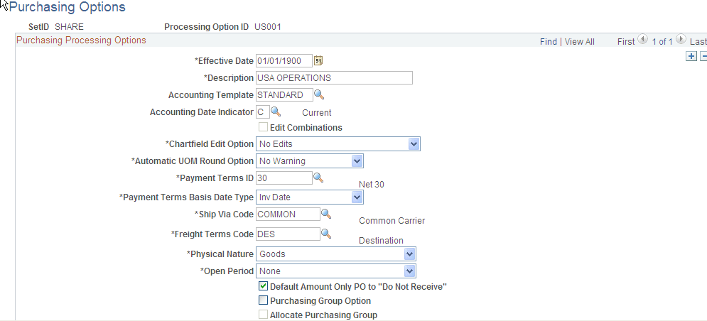

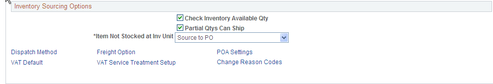

Purchasing Options Page
Use the Purchasing Options page (BUS_UNIT_OPT_PM) to define purchasing options, enable purchasing group options for transactions, and establish transaction processing criteria for each PeopleSoft Purchasing business unit. You can override these options during transaction processing.
Navigation:
Set Up Financials/Supply Chain, and then Business Unit Related, and then Purchasing, and then Purchasing Options
This example illustrates the fields and controls on the Purchasing Options (Page1of2). You can find definitions for the fields and controls later on this page.
This example illustrates the fields and controls on the Purchasing Options(Page2of2). You can find definitions for the fields and controls later on this page.
Purchasing Options (Page2of2)
Field or Control Description
Purchasing Group Option
Select this option to enable the Purchasing Group fields for transaction pages (Procurement Group link, Procurement Group ID, Primary Unit, Unit Allocation Quantity, and Unit Allocation Amount fields appear on the Requisition, Purchasing ,Receipt and Voucher transaction pages).
Allocate Purchasing Group
This option is only available for selection when the Purchasing Group Option is selected. Select this option to enable Online Receipts and the Receipt Push process to write Procurement Group asset data to the RECV_LN_ASSET and the INTFC_PRE_AM records for Asset Management. See Asset Lifecycle Management Fundamentals: Consolidating Requisition and Purchase Order Lines for Asset ComponentsPeopleSoft Asset Management: Consolidating Group Member Assets.
Purchasing Group and Procurement Group are used interchangeably. They are synonymous.

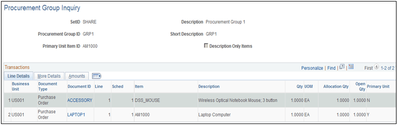

Procurement Group Inquiry Page
The Procurement Group Inquiry page (PO_GRP_DOC_INQ) Review all related procurement documents (Requisitions, Purchase Orders, Receipts, and Vouchers) that are associated with a Procurement Group.
Navigation:
Purchasing, and then Purchase Orders, and then Review PO Information, and then Procurement Group Inquiry, and then Procurement Group Inquiry
This example illustrates the fields and controls on the Procurement Group Inquiry page. You can find definitions for the fields and controls later on this page.
Transactions display in the following sort order: Business Unit, Document Type, Document ID, Line, and Schedule.
Line Details
Document Type
Displays the type of transaction: Requisition, Purchase Order, Receipt, or Voucher.
Document ID
Displays the Requisition, Purchase Order, Receipt ID, or Voucher link. Click the link to access the corresponding source document.
Line
Displays the line number from the source document
Sched (schedule)
Displays the schedule number from the source document
Unit Allocation Qty (quantity)
Identifies the quantity of the item to allocate per asset for the Procurement Group. This quantity is available for non-amount only transactions. It is utilized during receiving and asset integration.
Unit Allocation Amt (amount)
Identifies the amount of the item to allocate per asset for the Procurement Group. This amount is available for amount only transactions. It is utilized during receiving and asset integration.
Open Qty (quantity)
If the Document Type is a:
  • Requisition, the open quantity is the quantity not sourced.
  • Purchase Order, the open quantity is the quantity not received.
  • Receipt, the open quantity is the quantity not interfaced with Asset Management.
Primary Unit
Identifies whether the listed item is the primary unit (value = Y) within a given procurement group.
See procurement Groups PageUsing Purchase Order Reservations
