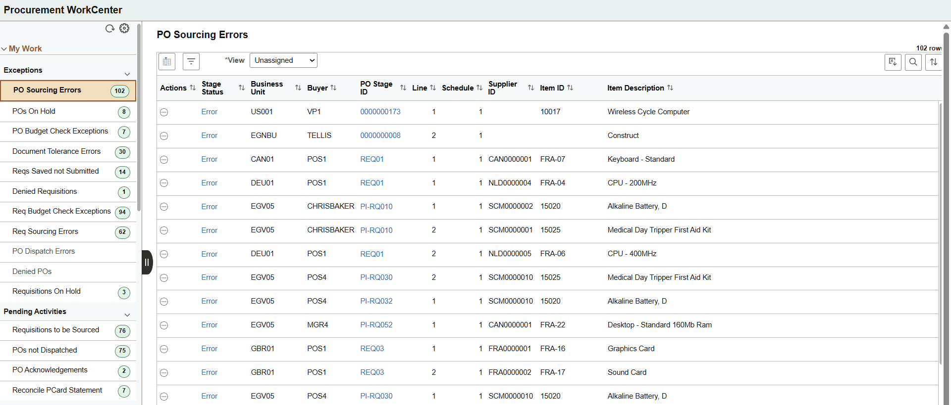

Procurement WorkCenter Page - PO Sourcing Errors (Work Management Enabled)
PO_EXCEPTION_WC_FL
Access and manage PO Sourcing Errors in various views.
Use the Procurement WorkCenter page to access and manage POs with sourcing errors when Work Management is enabled.
Navigation:
Select the Procurement WorkCenter tile.
This example illustrates the fields and controls on the Procurement WorkCenter - PO Sourcing Errors page when using Work Management.
Procurement WorkCenter With Work Management
When Work Management is enabled for an exception, there are two changes on the WorkCenter page:
  • The View drop-down box appears above the grid.
  • Additional action options are added to the Actions button.
The actions for PO Sourcing Errors are Purge, Recycle, and Edit Staging Error. When Work Management is enabled, additional actions are available depending on the option selected in the View field: See Enterprise Components: Understanding the Work Management Framework, Actions by View section.
