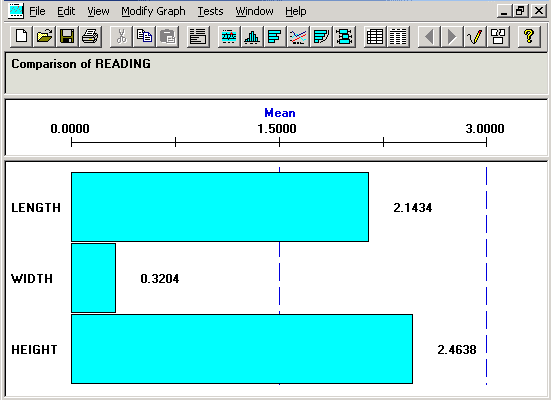

Use the Bar Graph panel to compare a selected statistic among subsets.
Navigation:
  • Click the Bar Graph button.
  • Select View, and then Bar Graph.
This example illustrates the fields and controls on the Bar Graph panel. You can find definitions for the fields and controls later on this page.
Bar Graph panel
The bar graph is comprised of multiple panes (sections) that display information about the subset that you are examining. You resize sections the same as you do for a histogram. There is a bar on the graph for each subset you selected in the Selector panel.
Title Section
This section of the bar graph displays the statistics that you are comparing.

This section displays the name of the statistical item you are comparing
Field or Control Description
Name and Scale
Displays upper and lower scale limits (based on the minimum and maximum statistical values). To select a different statistic, select Modify Graph, and then Settings.

This section displays a bar for each subset chosen from the Selector panel.

You can modify the size of the bar display, the bar values, reorder, and change the statistic on the bar graph. Any changes you make to the bar graph are in effect only for the active chart. If you open a second bar graph window, the changes are not in effect.
Fit Bars to Window
Select to expand the graph to fit the full size of the Bar Graph panel, eliminating the vertical scroll bar.
Display Bar Values
Select to display numeric values for each bar on the graph.
Indicate Min/Max (<>) Bars (indicate minimum/maximum bars)
Select to indicate which bars represent the minimum and maximum values. The bar that contains the lowest value displays <. The bar with the highest value displays >. This option is useful for distinguishing the highest and lowest value bars among bars of similar lengths.
Bar Display Limit (# bars) (number of bars)
Enter the number of bars to display on the graph. The limits for constraining the number of bars are from 2 to 1000. By default (or by entering 0 or 1), all the subsets that you selected in the Selector panel appear.
