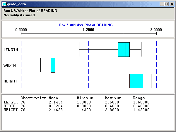

The box plots display is comprised of multiple graph panes (sections), with each section displaying information about the subset that you are examining. Box plots are also referred to as Box and Whisker plots, because of the vertical whisker lines at each end of the horizontal scale.
Box plots supports three styles of plots, including:
  • Box and Whisker
  • Capability
  • Min/Max (minimum/maximum)
When you select multiple subsets on the Selector panel and click the Box Plots button, the displays represent the subsets you select. All selected subsets are overlaid together in the same box plots window.
You can select individual box plots by clicking the subset name. A red box appears around the subset that you selected. The detail section of the display changes from the collective summary of statistics for all box plots to individual summary statistics for the selected subset.
Deselect an individual box plot by clicking above the first box or below the last box in the label area. Click to the left of the boxes.
Title Section
This section includes a heading that indicates the plot type, the data column used as the basis for generating the box plots, and normality criteria for the calculations used to generate the box plots. In the previous illustration, the plot type is Box and Whisker, the data column is Reading, and the normality criteria is Pearson Best Fit.

The Box and Whisker chart section contains Box and Whisker displays. The ends of the whisker lines represent the minimum and maximum values, the left and right edges of the boxes represent the first quartile and third quartile values, and the centerlines represent the median value.
The individual boxes correspond to either the subsets that you selected or the data groupings established with the group by column role assignment on the Selector panel.

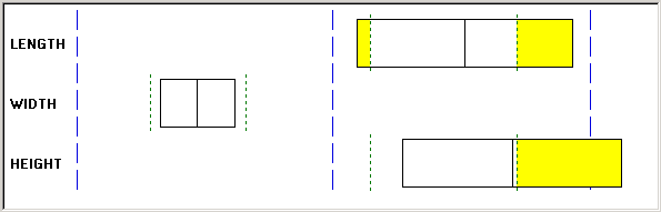

A capability graph appears in this section:
This image displays the capability graph.
Chart section - capability graph
The left and right edges of the capability graph box represent the plus and minus 3 sigma values, and the centerline represents the mean value. In addition, green dashed lines represent the lower-and upper-specification limits, while yellow parts represent the areas out of specification based upon the distribution fitting (Normality, Pearson Best Fit) criteria in effect.
Individual boxes correspond to either the subsets that you selected or the data groupings established with the group by column role assignment on the Selector panel.

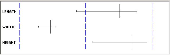

A min/max graph appears in the following section:
This image displays the min/max graph.
Chart section - min/max graph
The left and right endpoints represent minimum and maximum values, and the centerline represents the mean.

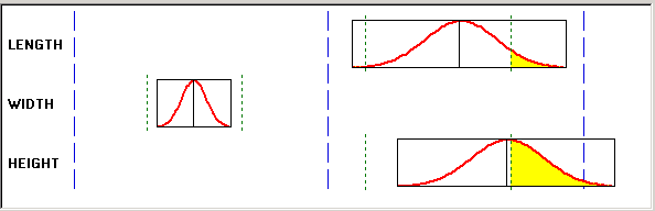

Overlay + / - 3 Sigma Region
Select to overlay each capability box in the box plots window with a distribution curve. This option is only applicable when the graph style is set to Capability.
Graph Scale Limits
The system calculates and displays scales by adding and subtracting a percentage of the upper- and lower-plot values that are based on option and graph type selections. You can change the lower and upper graph scale limits, which change how the box plots appear in the window.
The scale section of the display changes to reflect the new graph scale limits. The scale that you enter stays in effect until you select another graph style or (sometimes) when you change the overlay 3 + / - Sigma Region check box. If you change any setting that could potentially alter the assessment of minimum/maximum plot values, the system recalculates the scales.
An example of a box plot with distribution curves overlaid appears in the following section:
This image displays the overlaying distribution curves.
Overlaying distribution curves on box plots
The system calculates the distribution curve according to the normality/curve fitting criteria in effect by the graph preference ID that you selected.
