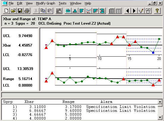

This example illustrates the fields and controls on the Control Chart panel. You can find definitions for the fields and controls later on this page.
Control Chart panel

Title Section
This section displays the label of the chart being applied; for example, X-bar and Range charts. The title section also displays the subset for which the data is being displayed; for example, Temp A.
Field or Control Description
N
Displays the subgroup size used for this control chart.
Sgrps (subgroups)
Displays the number of subgroups or plotted points displayed in this chart.
OCL (operating control limit)
Displays the status of control limit promotion or calculation.
Note: The status values correspond to the standard None, Preliminary, Monitoring, and Ongoing limit status values. Modified status indicates that the control limits were calculated dynamically for this graph window and not extracted from the database.
Proc (control procedure)
Displays the control procedure in effect. It also indicates whether the alarms indicated on the chart were:
(Tested): Tests and alarms were performed locally to this graph and not necessarily present in the database.
(Actual): Alarms associated with the subgroups were extracted from the database.
Chart Section
This section displays the main body of the graph. For example, if you selected the X-bar and range charts, you would see two graphs displayed on the control chart, one for the X-bar and one for the range chart. Each point on the graph represents an individual subgroup.
Alarms or out-of-control points are indicated by red triangles. Green circles represent all others. A blue square indicates that the subgroup readings were edited in the database using data-entry panels.
Points with cause and action information associated with them are indicated by an over-bar.
You can see the subgroup values for each point on the chart by finding its number in the detail section of the control chart.
Control Limit Description Section
This section displays the values and appropriate labels for the upper control limit (UCL), mean (CL), and lower control limit (LCL) for each graph. These limits may be have been extracted from the database, calculated, or set local to the graph.
Separator Section
This section is blank, unless you select a point in the graph section; then it displays detailed information about the point.
Detail Section
This section displays a list of subgroup summary information if a point has not been selected on the graph. This list includes the subgroup plot point values and alarm descriptions.
If you select an individual point on the graph, use this area to see detail information, such as traceability fields, probable causes, and corrective actions for that subgroup. If the dataset has been extracted from the Quality database, the Subgroup Status field also appears. The field indicates if a subgroup has been edited or changed in the database. A status of 800 indicates that one or more sample values have been changed for the subgroup, and this point is designated as a blue square on the chart. A status of 200 indicates that the subgroup has not been edited.
