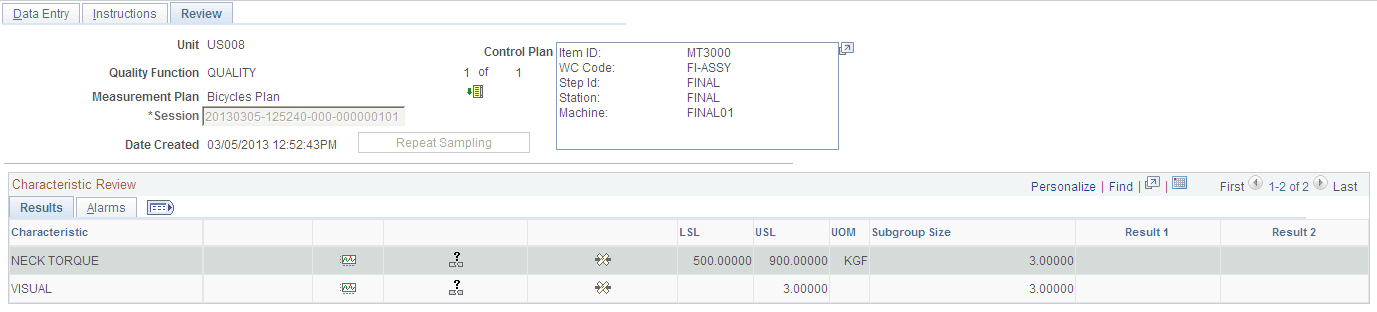

This example illustrates the fields and controls on the Review page: Results tab. You can find definitions for the fields and controls later on this page.
Control plans usually contain more then one characteristic. As you enter readings for a plan, you can review what has been analyzed. This page displays information and current subgroup results for each characteristic and is the same, whether you enter data for a new session, maintain a pending session, or edit a completed session.
In the upper-right portion of the page, a text box displays the hierarchy fields associated with the control plan. Each control plan characteristic appears in the Characteristic column.
Field or Control Description
LSL (lower specification limit) and USL (upper specification limit)
Displays the lower and upper specification limits for the characteristic.
Subgroup Size
Displays the subgroup size.
Result 1 and Result 2
Displays the subgroup results, based on the associated control chart calculated from the readings.
