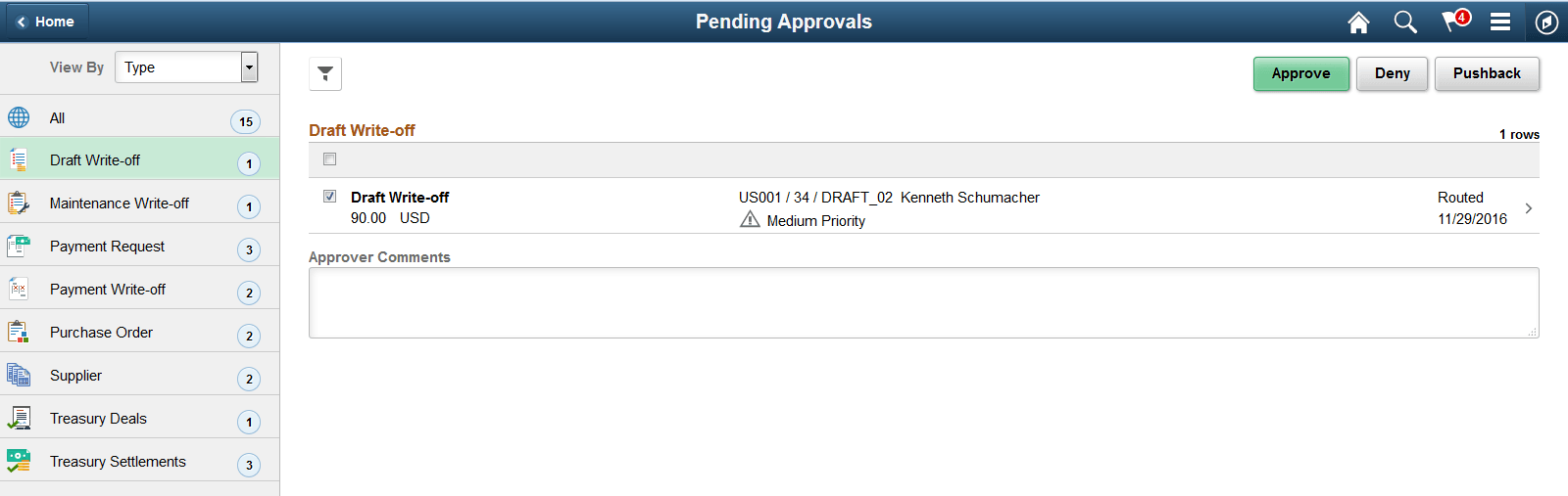

Draft Write-off – Pending Approvals Page
Use the Draft Write-off – Pending Approvals page (EOAWMA_MAIN_FL) to view a list of all transactions that apply to the selected transaction category and access the respective transactions that are pending your approval.
Navigation:
Select Draft Write-off in the approval transaction types panel.
This example illustrates the fields and controls on the Draft Write-off – Pending Approvals list page as displayed on a desktop (LFF).
Draft Write-Off - Pending Approvals page (LFF)

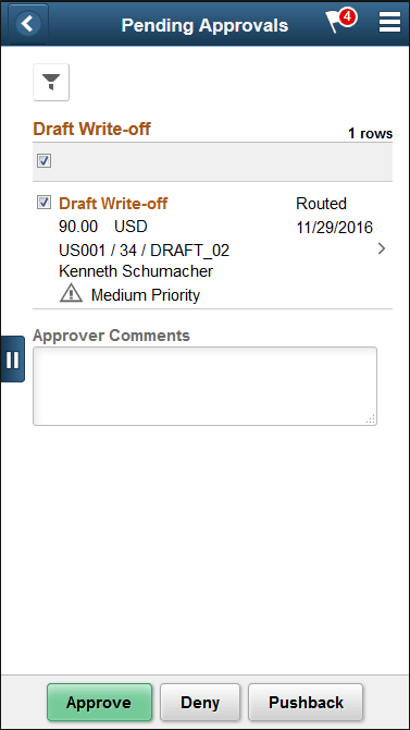

This example illustrates the fields and controls on the Pending Approvals - View By Transaction Type panel as displayed on a phone (SFF). Select Draft Write-off in the transaction type list to open the list of draft write-off pending approvals.
Pending Approvals - View By Transaction Type panel (SFF)
This example illustrates the fields and controls on the Draft Write-off – Pending Approvals list page as displayed on a phone (SFF).
Draft Write-Off - Pending Approvals list page (SFF)
Field or Control Description
Filter button
Select the filter button to open the Filters page. Use the filter to refine the results displayed in the list of pending approvals for draft write-offs.

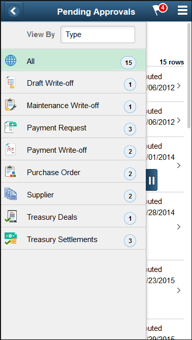

Master button
(SFF) Select the Master button on the phone to hide or unhide the panel that shows available transaction types with pending approvals. Select Draft Write-off transaction type to view the pending approvals for draft write-offs.
Select one or more check boxes to take action on one or more transactions. Enter comments in the Comment field. Then select one of the following approval action buttons:
Approve button
Select to approve the selected transaction or transactions. The system prompts you to provide comments and submit the approval. This action routes the approval to the next approver in the chain.
Deny button
Select to deny the selected transaction or transactions. When you deny a transaction, that status changes to Denied and the transaction is removed from the approval queue.
Pushback button
Select to send the request back to the previous approver. This option is only available for second or subsequent approvers in a multiple-approver workflow path.
Upon selecting an action, you have the option to select Submit to continue the action or Cancel to back out of the action. When you submit the action, the system generates a message that the action is successful.

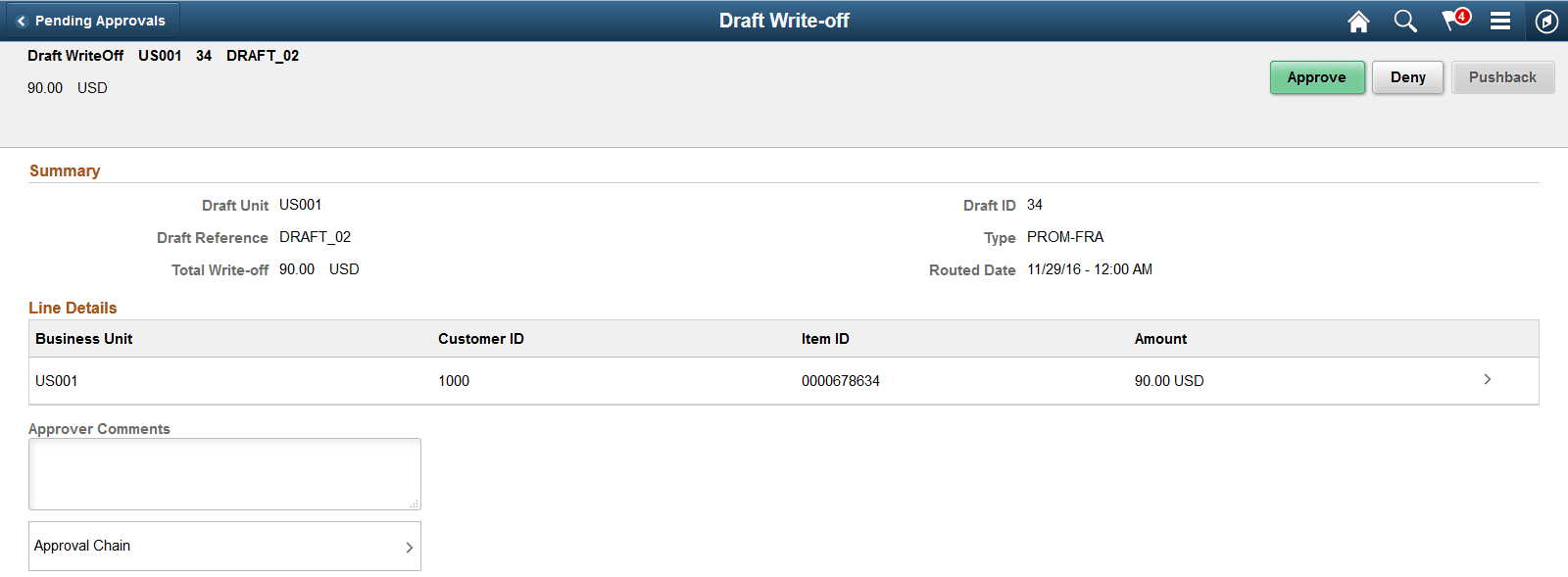

Draft Write-Off – Approval Header Detail Page
Use the Draft Write-Off – Approval Header Detail page (EOAWMA_TXNHDTL_FL) to review the summary for a single write-off, and approve, deny, or push back the write-off, depending on role criteria and number of reviewers.
Access line item details for a specific line and attachments, if any.
Navigation:
Select a draft write-off transaction in the Pending Approvals list.
This example illustrates the fields and controls on the Draft Write-off – Approval Header Detail page as displayed on a desktop (LFF).
Draft Write-Off - Approval Header Detail page (LFF)

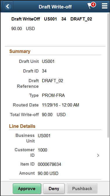

This example illustrates the fields and controls on the Draft Write-off - Approval Header Detail page as displayed on a phone (SFF). On a phone, you must scroll down to view the attachments, comments, and approval chain fields.
Draft Write-Off - Approval Header Detail page (SFF)
Summary
View write-off item details.
Line Details
View line information and select the right arrow to access the line details.
When viewing write-off header approval detail on a phone, you must scroll down to view the approver comments and approval chain.
View Attachments
Select the right arrow to open the View Attachments page. The number of attachments for the transaction appears on the button.
The View Attachments option appears only when the item has related attachments.
For more information, see View Attachments Page.
Approver Comments
Enter comments in the text entry field.
When viewing a write-off approval on a phone, you must scroll down to view the approver comments and approval chain.
Approval Chain
Select the right arrow to review approval chain information. You can expand or collapse approver information by selecting the glyph icon. You can also select the approver name to view approver details. The approval chain reflects approval status generated by the Approval Workflow Engine (AWE).
For more information, see Application Fundamentals: Approval Chain Page.
Select the one or more check boxes to take action on one or more transactions. Enter comments in the Comment field. Then select one of the following action buttons:
Approve button
Select to approve the transaction. The system prompts you to provide comments and submit the approval.
Deny button
Select to deny the transaction. The system prompts you to provide comments and submit the denial.
Pushback button
Select to send the request back to the previous approver. This option is only available for second or subsequent approvers in a multiple approval workflow path.

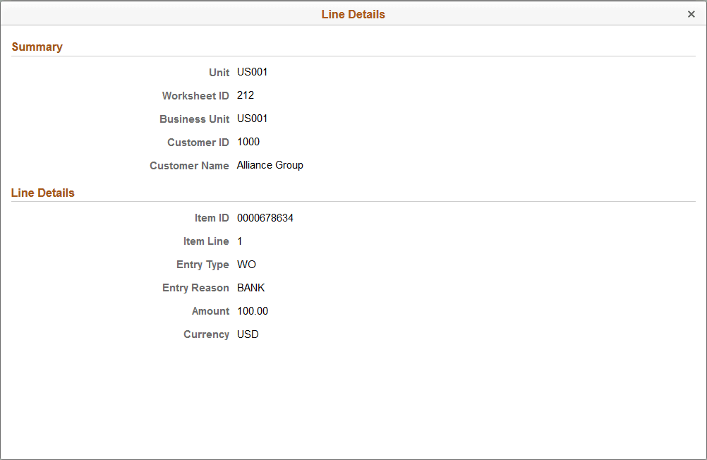

Line Details Page
Use the Line Details page (ARDF_FL_APPR_LN) to view item summary and line details for the write-off.
Navigation:
Select the right arrow for the line on the Draft Write-off – Approval Header Detail page.
This example illustrates the fields and controls on the Line Details page as displayed on a desktop (LFF).
Line Details page (LFF)
