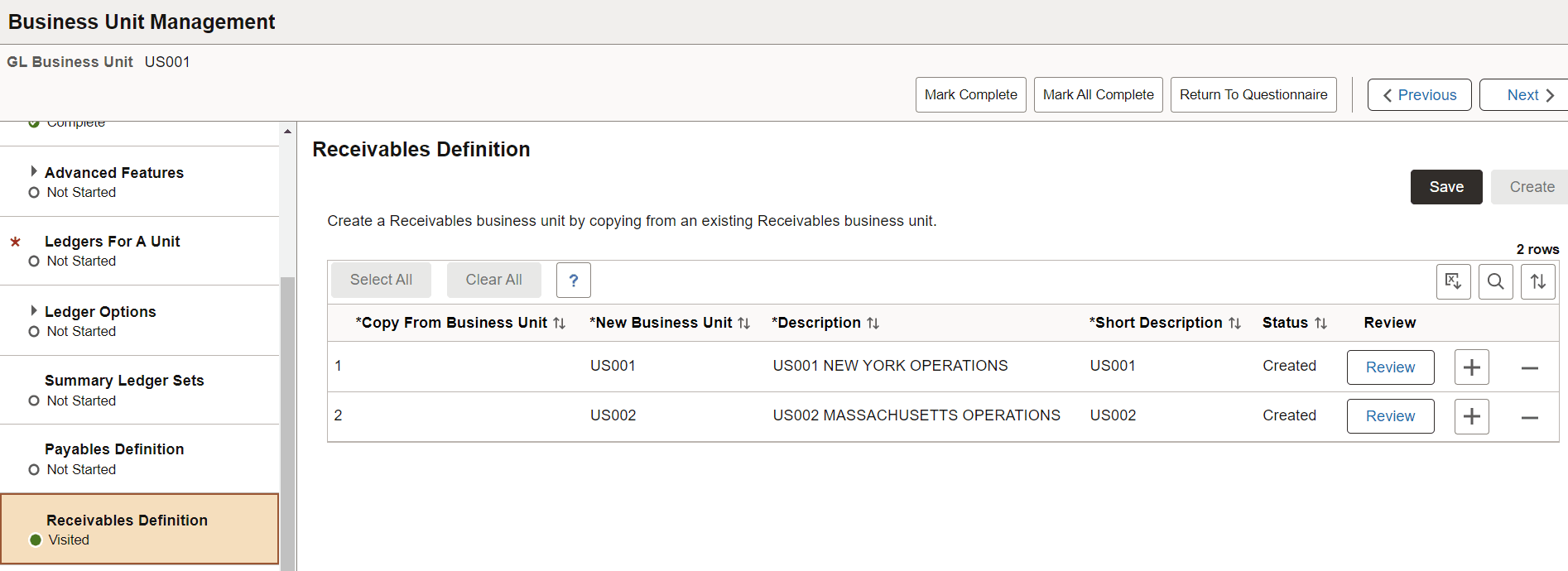

Receivables Definition Page
Use the Receivables Definition page (AR_BU_COPY_FL) to search, modify, add, and copy Receivables business units.
Navigation:
PeopleSoft Home, and then Finance & Accounting, and then Business Unit Management tile, and then Create New Ledger, and then Basic Information, and then Receivables Definition
This example illustrates the Receivables Definition page.
Business Unit Management - Receivables Definition page
See the PeopleSoft General Ledger: View Business Unit Management Page for field definitions.
This page allows you to create a new Receivables sub-ledger business unit by copying from an existing sub-ledger business unit. The new sub-ledger business unit is not created until you select the Create button. When the Create button is selected, the Review button is available to proceed to the sub-ledger Questionnaire page. The system then proceeds to the sub-ledger configuration pages.

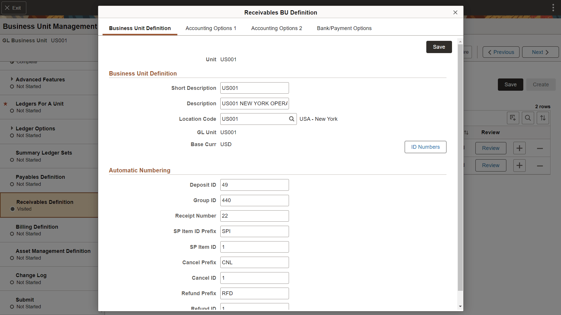

Business Unit Definition Page
Use the Business Unit Definition page (BUS_UNT_TBL_AR_FL1) to create a Receivables business unit and specify its default numbering options.
Navigation:
PeopleSoft Home, and then Finance & Accounting, and then Business Unit Management tile, and then Create New Ledger, and then Basic Information, and then Receivables Definition, and then Business Unit Definition
This example illustrates the Business Unit Definition page.
Business Unit Management - Business Unit Definition page
See the Receivables Definition - Business Unit Definition Page for field definitions.

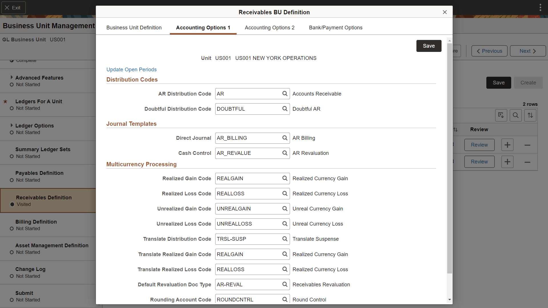

Accounting Options 1 Page
Use the Accounting Options 1 page (BUS_UNT_TBL_AR_FL2) to define the open accounting periods for the business unit, assign a direct journal template to the unit, assign the accounts receivable distribution codes to the unit, and define multi-currency processing options.
Navigation:
PeopleSoft Home, and then Finance & Accounting, and then Business Unit Management tile, and then Create New Ledger, and then Basic Information, and then Receivables Definition, and then Accounting Options 1
This example illustrates the Accounting Options 1 page.
Business Unit Management - Accounting Options 1 page
See the Receivables Definition - Accounting Options 1 Page for field definitions.

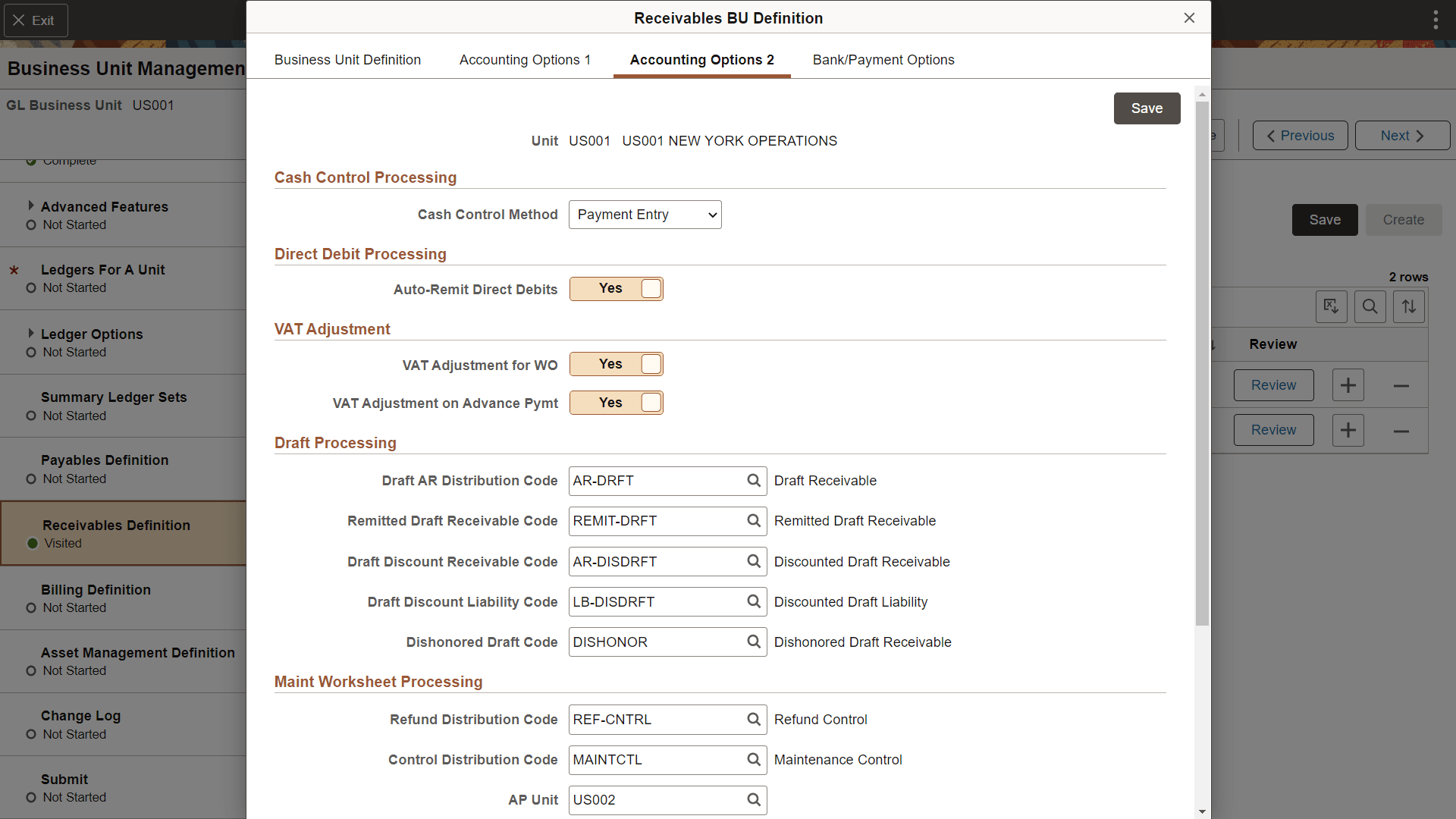

Accounting Options 2 Page
Use the Accounting Options 2 page (BUS_UNT_TBL_AR_FL3) to specify the distribution codes used to create accounting entries for draft processing and refund processing.
Navigation:
PeopleSoft Home, and then Finance & Accounting, and then Business Unit Management tile, and then Create New Ledger, and then Basic Information, and then Receivables Definition, and then Accounting Options 2
This example illustrates the Accounting Options 2 page.
Business Unit Management - Accounting Options 2 page
See the Receivables Definition - Accounting Options 2 Page for field definitions.

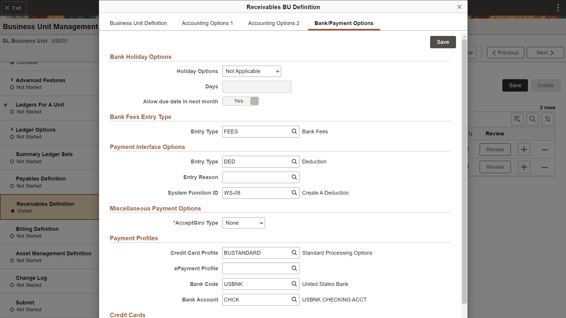

Bank/Payment Options Page
Use the Bank/Payment Options page (BUS_UNT_TBL_AR_FL4) to specify business unit defaults for due dates that fall on holidays.
Navigation:
PeopleSoft Home, and then Finance & Accounting, and then Business Unit Management tile, and then Create New Ledger, and then Basic Information, and then Receivables Definition, and then Bank/Payment Options
This example illustrates the Bank/Payment Options page.
Business Unit Management - Bank/Payment Options page
See the Receivables Definition - Bank/Payment Options Page for field definitions.
