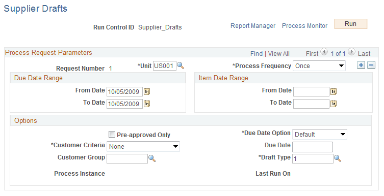

Supplier Drafts Page
DRAFT_REQUEST
Runs the Create Drafts process.

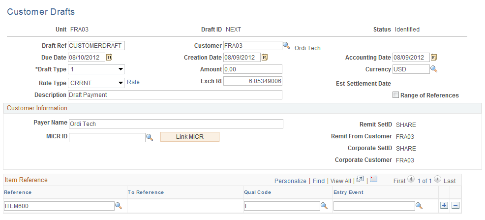

Customer Drafts Page
DRAFT_ENTRY
Enter a single customer-initiated draft, indicating the items that the draft will pay.

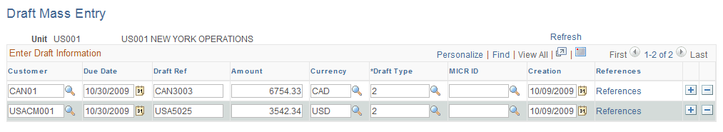

Draft Mass Entry Page
DRAFT_MASS_ENTRY
Enter multiple customer-initiated drafts.

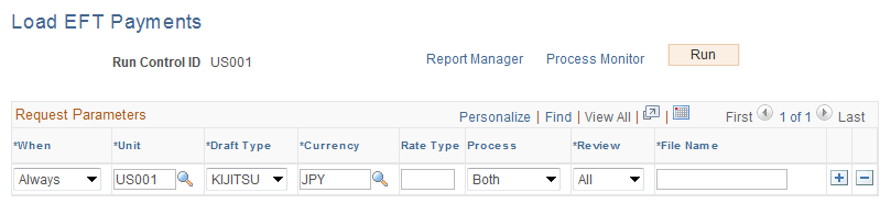

Load EFT Payments Page
DR_EFT_REQUEST
Use to load draft payments from an EFT file.
Use the Supplier Drafts page (DRAFT_REQUEST) to run the Create Drafts Application Engine process (AR_DRAFTS).
Navigation:
Accounts Receivable, and then Drafts, and then Create Drafts, and then Supplier Drafts
This example illustrates the fields and controls on the Supplier Drafts page. You can find definitions for the fields and controls later on this page.
Due Date Range
Field or Control Description
From Date and To Date
Enter a range for the due dates of items to include. To include items due on a specific day, enter the same date in both fields.
Item Date Range
Enter the date range for item creation. To include items created on a specific day, enter the same date in both fields.
Options
Pre-Approved Only
Select to process only items that are preapproved on the draft and that do not require customer approval.
Customer Criteria and Customer Group
These fields work together to limit the customers for whom you will create drafts. If you decide to select items based on customer criteria, select one of these options: Customer, Corporate, or Remit From.
Then, select the customer group assigned to the customers.
For example, suppose you select a customer group containing customers FRA01 and FRA04 and you select Remit From.
The customers in the remit-from customer group for customer FRA01 are FRA01 and FRA03. Customer FRA04 is the only customer in the remit-from customer group for customer FRA04. In this case, the system selects items for customers FRA01, FRA03, and FRA04.
If you had selected Customer as the customer criteria, the system would select items for only customers FRA01 and FRA04.
Due Date Option
Select a value that determines the due date for the items in the draft. Options are:
Default: Use the item due date. If you use item due dates, the process creates a separate draft for items with different due dates.
Specified: Use the date that you entered in the Due Date field for the items.
Draft Type
Select a draft type. (The draft types are defined on the Draft Type - Receivables page.)
Due Date
Enter the due date for the draft.
Creation Date
Override this date if necessary. The default date is the current system date.
Accounting Date
Amount
Enter the total amount of the draft.
Est Settlement Date (estimated settlement date)
The system populates this value when you save. It uses the bank holiday rules defined for the bank account that you assigned to the customer for the draft if it falls on a holiday.
Range of References
Select to enter a range of items.
Customer Information
Payer Name
Displays the customer's name on the draft by default. You can change the payer name as needed.
Item Reference
(Optional) Use to indicate the item or range of items that are applied to the draft. You can also enter this information when you build a draft worksheet.
Reference and To Reference
Enter one reference number unless you selected Range of References. Then, you must enter a beginning and ending reference number.
Use the Draft Mass Entry page (DRAFT_MASS_ENTRY) to enter multiple customer-initiated drafts.
Navigation:
Accounts Receivable, and then Drafts, and then Create Drafts, and then Multiple Customer Drafts
This example illustrates the fields and controls on the Draft Mass Entry page. You can find definitions for the fields and controls later on this page.
To enter several customer-initiated drafts:
  1. Enter information about the drafts.
    Due Date
    Amount
    Enter the total amount for the draft.
    Creation
    Override the draft creation date as needed. The default is the current date.
    When you save the page, the system updates the estimated settlement date using the bank holiday rules assigned to the customer.
  2. (Optional) Click the References link to access the Draft Details page, where you specify the items to apply to the draft.
    References
    Click this link to access the Draft Details page (DR_MASS_ENTRY_SEC), where you can enter detail reference information for draft selection.
Use the Load EFT Payments page (DR_EFT_REQUEST) to load draft payments from an EFT file.
Navigation:
Accounts Receivable, and then Drafts, and then Create Drafts, and then Receive Draft Payments
This example illustrates the fields and controls on the Load EFT Payments page. You can find definitions for the fields and controls later on this page.
Process
Indicate whether to process Drafts, regular Payments, or Both in the EFT file.
Review
Select a review option. Options are:
All: Creates draft control records for all records in the EFT file even if they do not have a matching customer or bank account in the system.
Errors: Select if you want to review and correct errors for drafts before the system updates the Draft Control table.
This option is available only if you are processing drafts.
File Name
Enter a name for the EFT file. The name of the EFT file must be unique. The file must be loaded into the directory on the application server defined by %PS_SERVDIR%\FILES, where %PS_SERVDIR% is the directory where the application server domain is defined. If you process the EFT file using Process Scheduler, then you need to load the file into %PS_CFG_HOME%\appserv\prcs\ <database name>\files.
After the system processes the file, it updates a table (DR_FILE_NAME) on the database with the name of the flat file that was loaded. Using a unique file name prevents drafts or payments from being entered into the system twice. Only the file name is stored, not the path.
