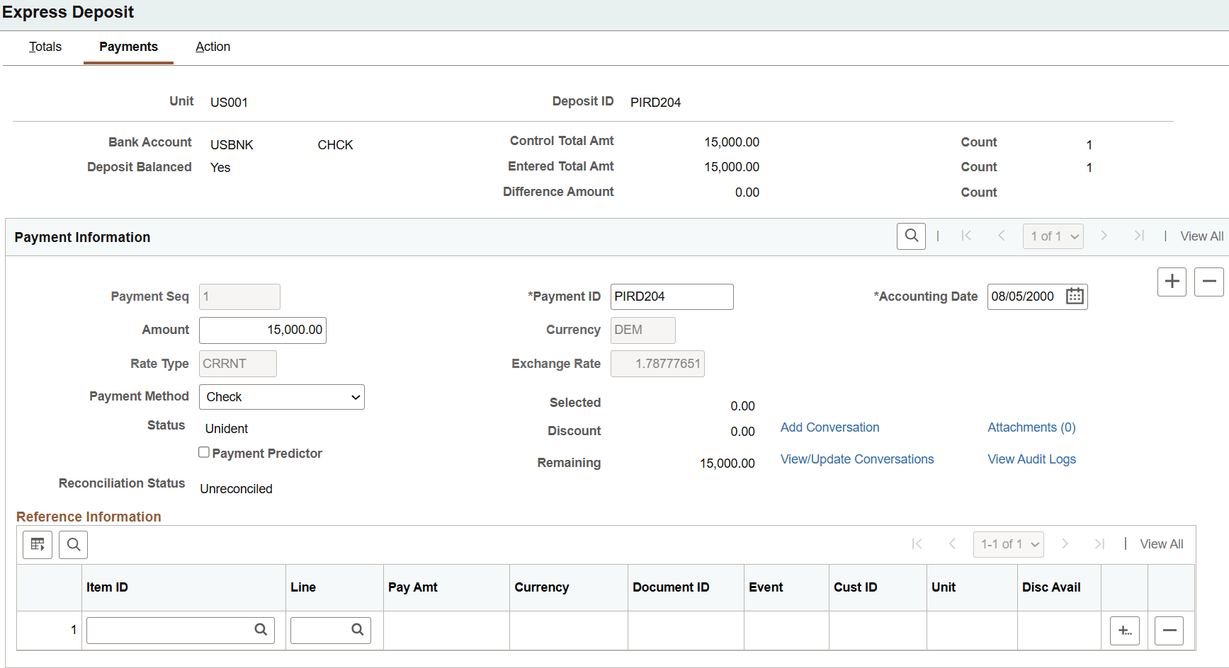

Express Deposit - Payments Page
Use the Express Deposit - Payments page (PAYMENT_EXPRESS2) to enter and apply payments with item IDs in a deposit after you enter the deposit control totals.
Navigation:
  • Accounts Receivable, and then Payments, and then Online Payments, and then Express Deposit, and then Payments
  • Accounts Receivable, and then Payments, and then Online Payments, and then Express Deposit Balancing, and then Payments
This example illustrates the fields and controls on the Express Deposit - Payments page. You can find definitions for the fields and controls later on this page.
Field or Control Description
Deposit Balance
Displays the deposit status. When the amount total and number of entered payments equals the control amount and count from the Express Deposit - Totals page, the status changes from No to Yes.
Control Total Amt (control total amount)
Displays the control totals entered on the Express Deposit - Totals page.
Entered Total Amt (entered total amount) and Difference Amount
Displays the amount of the payments that you have entered and the difference between the payments entered and the control totals. If the control and entered totals are not the same, you cannot apply any of the payments. Balancing these control totals is a necessary first step in payment application.
Payment Information
You can only update payment information for deposits that have not been reconciled with a bank statement.
Payment Sequence
When you enter a payment ID, the system assigns the next number to the payment so that you can track the order in which they were entered.
Payment ID
Enter the check number or other identifying number.
Accounting Date
Displays the payment date using the accounting date on the Totals page as the default. The system validates the payment date to make sure it falls within the open period for the business unit and transaction type as defined on the Open Periods page for the business unit. The payment date may be different from the deposit date if you use the postmark date from checks. The payment date affects earned discounts, so it must be accurate.
Payment Predictor
Select to use the Payment Predictor process to process a payment. This setting may override a default setting at the customer level. If a worksheet already exists for this payment, the check box is clear, and you cannot select it.
Note: If you receive payments for vendor rebate claims or claimback items from PeopleSoft Purchasing or PeopleSoft Order Management, do not select this option. You must manually apply the payments on the payment worksheet to indicate the base and VAT amounts for each item.
Reconciliation Status
Displays the bank reconciliation status.
Note: Deposits that have been reconciled on the bank statement cannot be deleted.
Amount
Enter the amount for the individual payment.
Payment Method
Select a payment method. The available options are: ACH, Check, Credit Card, Electronic Fund Transfer and Wire Report.
Select Check or Electronic Funds Transfer. The system uses the default payment method from the deposit type or business unit on the Receivables Options page. You can override the default payment method only for individual payments. If the Payment Method field is left blank, the payment method is assigned like this:
  1. Obtain the payment method for the deposit type using the SetID of the deposit business unit.
  2. Obtain the payment method specified in the Receivables Options page for the SetID of the deposit business unit.
  3. If the payment method is not available from the Receivables Options page, assign CHK as the deposit type.
If the payment method is Cash, the deposit was entered as a cash drawer receipt for a counter sale. In this case, all payments in the deposit are cash payments, and you cannot change the payment method. Also, you cannot add any payments to the deposit. The only information that you can change for cash payments is the reference information.
Note: If you enter deposits online, the cash payment method is not available.
Selected
Displays the total amount of payments applied to items.
Discount Taken
Displays the total amount of discount taken on the items.
Remaining
Displays the total amount of the payment remaining after you apply items to the payment. This amount reflects discounts taken.
Add Conversation and View/Update Conversations
Click the Add Conversation link to access the Conversations page and add a new conversation concerning a customer's express deposit. Click the View/Update Conversations link to review or update an existing conversation with or about the customer associated with this express deposit.
See Regular Deposit - Payments Page.
Reference Information
Item ID
Enter the ID of the item that you want to pay. When you provide an item ID, the system displays the item's payment amount. You can override this amount to create a partial payment or overpayment. The system displays a value in the Cust (customer) field or the Unit field unless an item ID references more than one item. If the system finds more than one item for the item and item line that you entered, it supplies only the item ID.
Discount
Select for an earned discount. The check box is selected by default if the discount is earned. The check box is deselected if the discount is unearned. If you want to take an unearned discount, you must create a payment worksheet.
Disc Avail (discount available)
Displays the amount available for an earned discount.
If you cannot completely apply a payment on this page, use a payment worksheet to apply prepayments, deductions, adjustments, on-account payments, and write-offs as needed.
