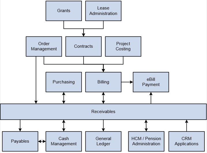

The following diagram shows the integration of PeopleSoft Receivables with other PeopleSoft applications.
This diagram illustrates the integration of PeopleSoft Receivables with other PeopleSoft applications: Grants integrates down to Contracts, which integrates down to Billing. Order Management integrates down to Billing, and then down to Receivables. Order Management also integrates directly down to Receivables. Project Costing also integrates down to Billing and then down to Receivables. Billing also integrates horizontally with eBill Payment, and Receivables integrates up to eBill Payment. Purchasing also integrates up to Receivables. Payables, Cash Management, General Ledger, and CRM applications integrate up to Receivables. Payables integrates horizontally with Cash Management, which integrates up to and away from Receivables. Pension Administration also integrates up to and away from Receivables.
